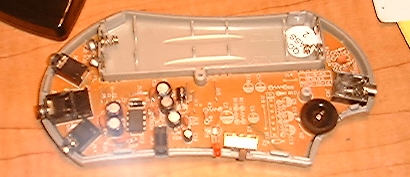

$17.99 Target clearance amp
I've got one opened in front of me now. The board is definitely different from what AMT showed in the first posts in this thread. The Board is labeled as "SI-5-A3, REV: A3, 2003-10-16. There is only one IC (YG2822 D3G0AA), one diode, seven electrolytic caps and a handful of resistors and ceramic caps.
Hi flubug, I have opened up two units, and I have to suspect that your amp is not a T-amp... I don't see a TA-2024, or the characteristic 4 inductors, and the form-factor is very different from a SI-5066...
Yeah, it sure looks like a totally different animal. I got a sinking feeling when I saw the IC was just a DIP-8. I tried to google the chip but no luck. Definitely a cheap piece of equipment probably not worth the price (though I did get the surface "transducers").

With the help of Amazon and the USPS we're up and running and playing Tom Waits' _Mule Variations_. Thanks to amt and Vinnie and others for their advice and encouragement.
I rehoused the SI circuit board in a cheap Radio Shack aluminum box, 3"x2"x5", which gives you that timeless science-project look, used a 50K Noble pot from Michael Percy, and the SLA battery and charger suggested by Vinnie, switched so the battery charges when the thing is turned off. Standard binding posts, a terminal strip to connect battery and charger, and a captive cable made from a 3-conductor electrical cord that plugs into the audio output of the PC.
Given my source (a PC) and my speakers (DIY Fostex FE127E, around 90db) I'm not in a position to discourse on audiophile qualities but the sound is clean and dynamics are good at the modest sound levels I need. And the thing hardly takes up any space.
