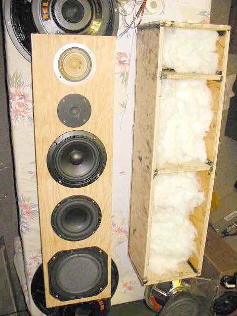

Sorry for the hijack but I too have the Corals. Here is what I played with last night. The Coral is running 1000 to 10000Hz. planet10 dave thinks I am under using the value of them. It's hard to disagree, they are a great little driver. If this sounds half ways good, I will ask him to do the doctor dave treatment on them. ie: Puzzle Kote, phase plug and damping.
Cal
Cal
Cal Weldon said:The Coral is running 1000 to 10000Hz. planet10 dave thinks I am under using the value of them.
He does... run them down to at least down to 300 Hz ...
dave

I am asking the MCM 6.5 to run from 100 to 1000. I think I need the Coral up a little higher for power handling. I'm using a 6dB XO. Were it not for that, I would be happy to run them down to 300. Remember this is my first non-two way speaker in quite some time. So instead of just going for a three way, I decided to break with tradition and go wild with this one. Egads, it's a four way! Say it's not true.
Oops, more hijacking I guess.
