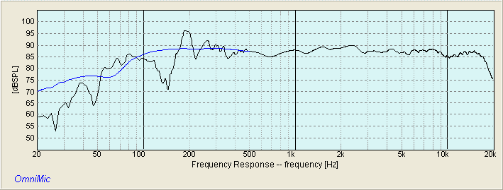

I'm not trying to discourage you from using a 10" but how a speaker is voiced affects the bass.Anyway, I'm at the stage where I'm considering woofers to take over the lower end of things and utilize the DSA135 and ND25fw for the mid and top end.
Below is the FR of the DSA135 + ND25FW with a passive crossover. Plot was made with speaker in 4pi.
The bass is about 5dB less than the midrange. No issues for me. I actually prefer it this way. I favor midrange over bass.

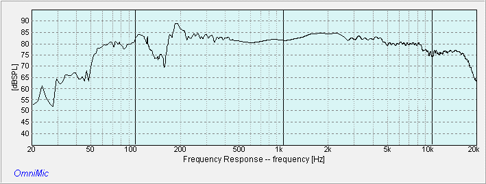

Here is another plot voiced like the Harman Curve. It sounds totally different. Bass is now more pronounced. Same drivers, same box.
