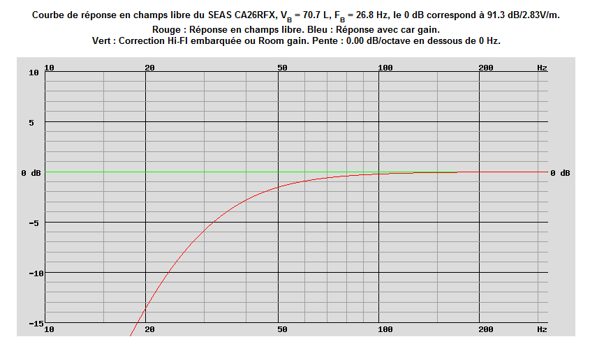

Very similar (simulation) than for the AE10s, with smaller box obvious.
  • SEAS CA26RFX, VB = 70.7 L, FB = 26.8 Hz, le 0 dB correspond à 91.3 dB2.83Vm. F3=39 Hz, F6=30 Hz,.gif

now i know it sounds daft and illogical, but i have a feeling the 25 tuning would be better
here is why, the low note i head inalot of music falls at 30hz if tuned to 25hz that will be a controlled note, if tuned to 30hz that note will be at the point where the driver is comming unloaded,
so if i tune it slightly lower it will save it from being unloaded with most music

The driver is not unloaded at the port frequency, at that frequency
it has a movement minima and then unloads at lower frequencies.
You seem to be mixing up the H1305 and the H1316 parameters.
The H1305 will be fine in ~ 60L to ~ 90L tuned to 25Hz, I'd say 75L.
