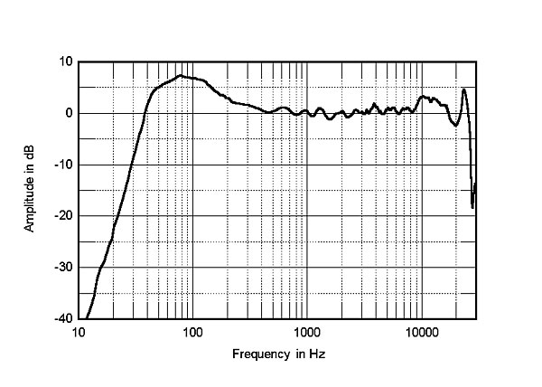

Ok, still the big question remains. How the heck do you compensate for baffle step?!? I feel like this is the same thing as "turf toe" in sports...everyone talks about it, but nobody can tell you exactly what it is.
So, using this formula --> f3 = 380 / WB, I get f3 = 445 Hz. What does that mean (especially if I am only compensating for 3dB of loss)? Is that the frequency where I should start rolling off, halfway of my rolloff, or the end of my rolloff.
Here are two graphs of the PSB Imagine T2 Towers, the first is the anechoic response and the 2nd is the woofers measured nearfield and the mids/tweeters measured in farfield.
Based on this, I calculated the F3 is 545 Hz. In looking at the graphs, it looks like the bass peaks around 80 Hz and drops until around the F3 point of 545 Hz. Looking at that in a perfect anechoic setup that results in a pretty flat response.
Obviously, my speakers will not be in an ideal scenario from a room standpoint, so I am at a loss on how to properly account for the baffle step. I am using Vituix to model my frequency response and it does have a baffle compensation tool, but I am having a hard time knowing if the info I am putting in is correct and trying to interpret the results.
Any help is greatly appreciated. Once I get a better understanding of baffle step, I can concentrate on driver selection and box design again.
Well, passive you can only reduce the level of the drivers (not the woofer in the bass though). I've written so much in the past days, I'm a bit tired and exhausted. But maybe this can help you a bit:
