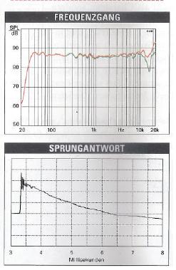

Here we can see the on- (red) and off- (green) axis responses of the new Thiel CS 3.7. Off-axis taken at 30 degrees.
The lower diagram shows the step-response.
The amplitude response is excellent and the step-response is wolds apart from what most other three-way speakers offer.

Thanks for posting the good info. The performance seems outstanding, indeed, though I want to see some more off-axis graphs (both amplitude and step responses) with different angles.
Right, the use of a coaxial driver must be the only way to overcome the first order xover's weakness I talked about. About this Thiel design, I'm particularly interested in how low the midrange is crossed over with the woofer, and how good its low-end distortions are.
I am not sure about that but I have seen other measurements where the acoustical crossover was at 600 Hz. Which is a bit high for my taste BTW. They mention that these Thiels can take a lot of punishment and still play with authority. But they didn't publish distortion measurements.

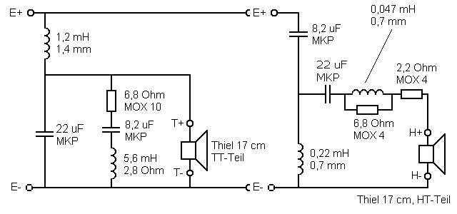

Looking at the XO, I wonder if the above Thiel is of first order. My 4th order acoustical LR XO is slightly simpler than that. I am not talking about the notches, just the main RLC network. Of course, my drivers are different. But I don't think the Thiel network would give anything close to 1st order.
HiFiNutNut said:Looking at the XO, I wonder if the above Thiel is of first order. My 4th order acoustical LR XO is slightly simpler than that. I am not talking about the notches, just the main RLC network. Of course, my drivers are different. But I don't think the Thiel network would give anything close to 1st order.
Electrical order by itself is no indication of acoustic order. Ive used 1st through 4th order electric with various notch filers and L pads to generate a 1st order response.
I didn't think the xover tinitus posted was one in a Thiel model, but a design that used Thiel DRivers. Am I wrong?
And right, electric order doesn't necessarily match acoustic order. But I haven't seen any drivers that require using greater than first order electrical filter to achieve a first order slope. Considering a driver's natural rolloff, using greater than first order electrical MAY give a first order slope near the xover freq but it will give a very fast phase turn a little far from the xover point, which can completely ruin the intended summation. For this reason, if there's a FR rise, it's usually a better idea to use a notch filter rather than a higher order filter to implement low order acoustic rolloff.
A bit of compromise helps a lot. Thiel speakers long ago used first order through the crossover region, and then added a second pole about one octave away from the crossover frequency. This requires a driver that is flat for two octaves past the xo frequency, which implies a pretty expensive driver. Nonetheless, it is more realizable with real world drivers (a few) than a pure electrical first order.
We're using a 10" SS and 4H 52 06 13 Skaaning/AT(concave dust cap) and 2905/9000 SS Revelator. (I understand the AT mid has evolved slightly since we bought ours.) The woofer absolutely requires a notch at the high end breakup frequency; we feel that a hard breakup needs to be at least 40 dB down, as the power integral over the ring time makes the breakup more audible than 40 dB attenuation would suggest.
