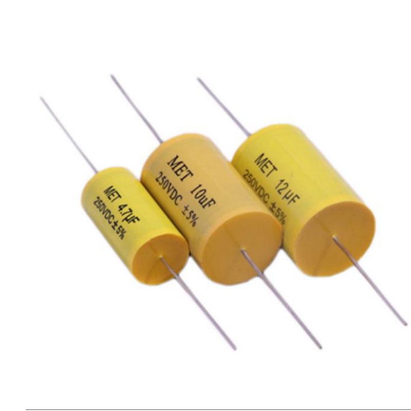

And, since you're a newbie, let me remind you that the capacitors must be non polar (NP) types intended for use in loudspeaker crossovers.
Plastic film types, such as polypropylene, are always NP - see attached image.
"while another cap at 470 uF, it does almost nothing"
A 470uF capacitor will almost cerainly be a polar capacitor (one end + and the other end -) and these types must not be used in loudspeaker crossovers.
You've got some research to do on multi-way louspeakers, but I hope to see you back with more DIY questions in the future. 🙂
