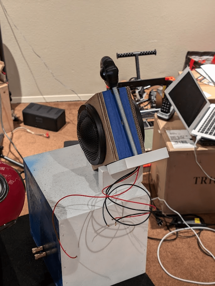

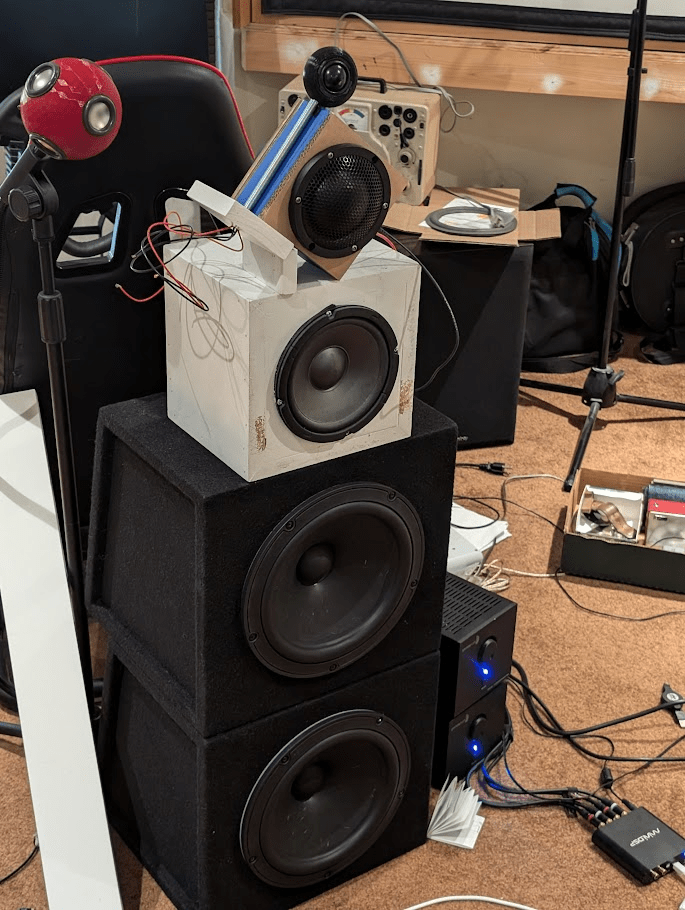

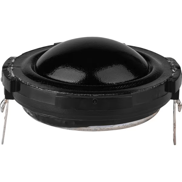

I have embarked on a bipole project this year. I started with the tweeter. It seems that finding a very shallow tweeter that I could put back to back was the way to go. I made the smallest baffle with rounded edges. These tweeters are the thinnest I've found so far.
Peerless by Tymphany OC25SC65-04 1" Textile Dome Tweeter
Next I searched for 3" dome midranges with large Xmax, and a shallow rear cup. The BiesMa looked to be a good candidate. Mounted back to back in the shipping cardboard for a first listen. It seems a wider baffle may improve the radiation pattern.
I will likely skip the 6" driver shown and go with one of the 10" drivers on the back of the cabinet to have a full range bipole.If done properly I think it will be nearly omni-directional. Here's a side view.
