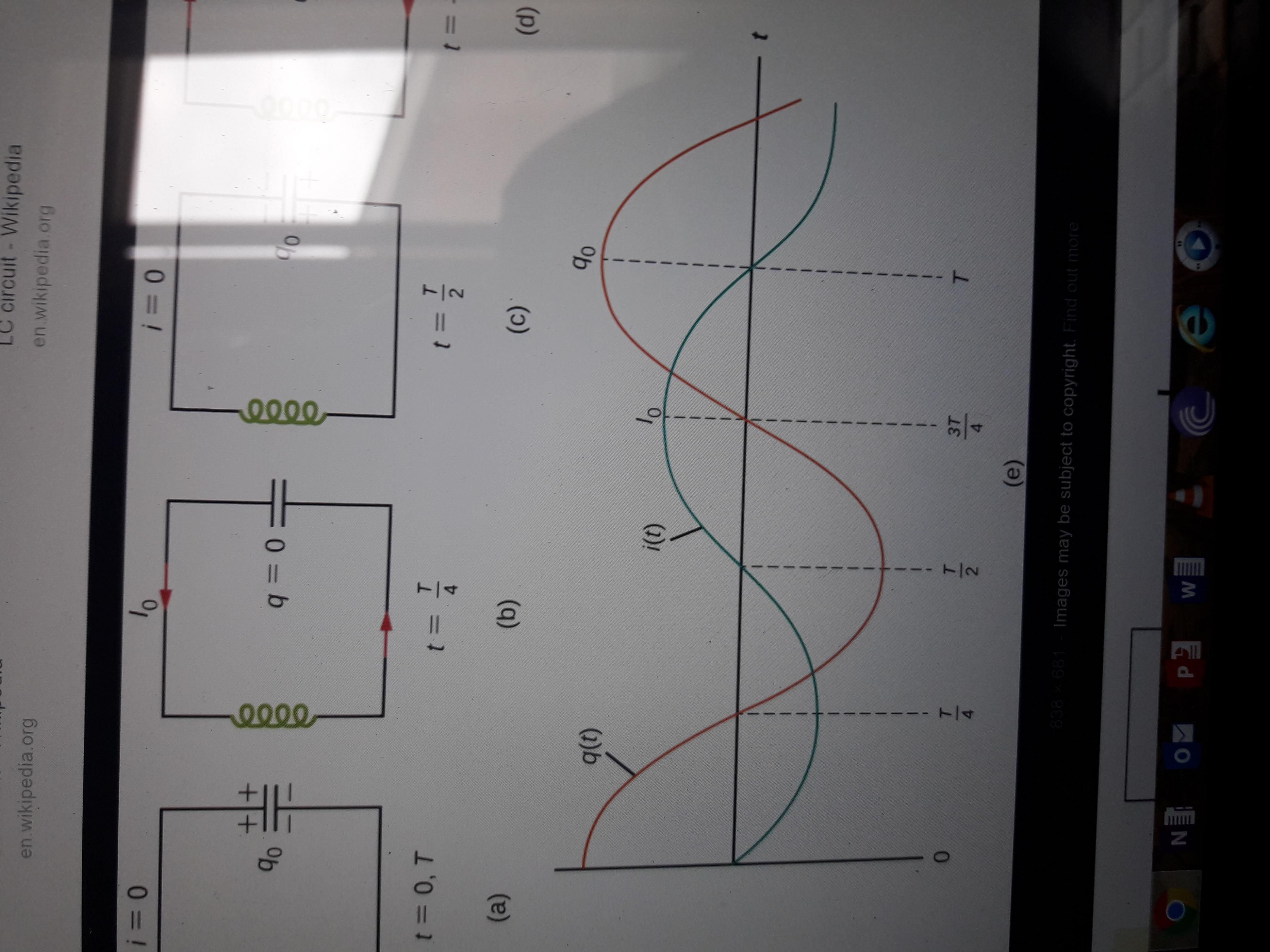

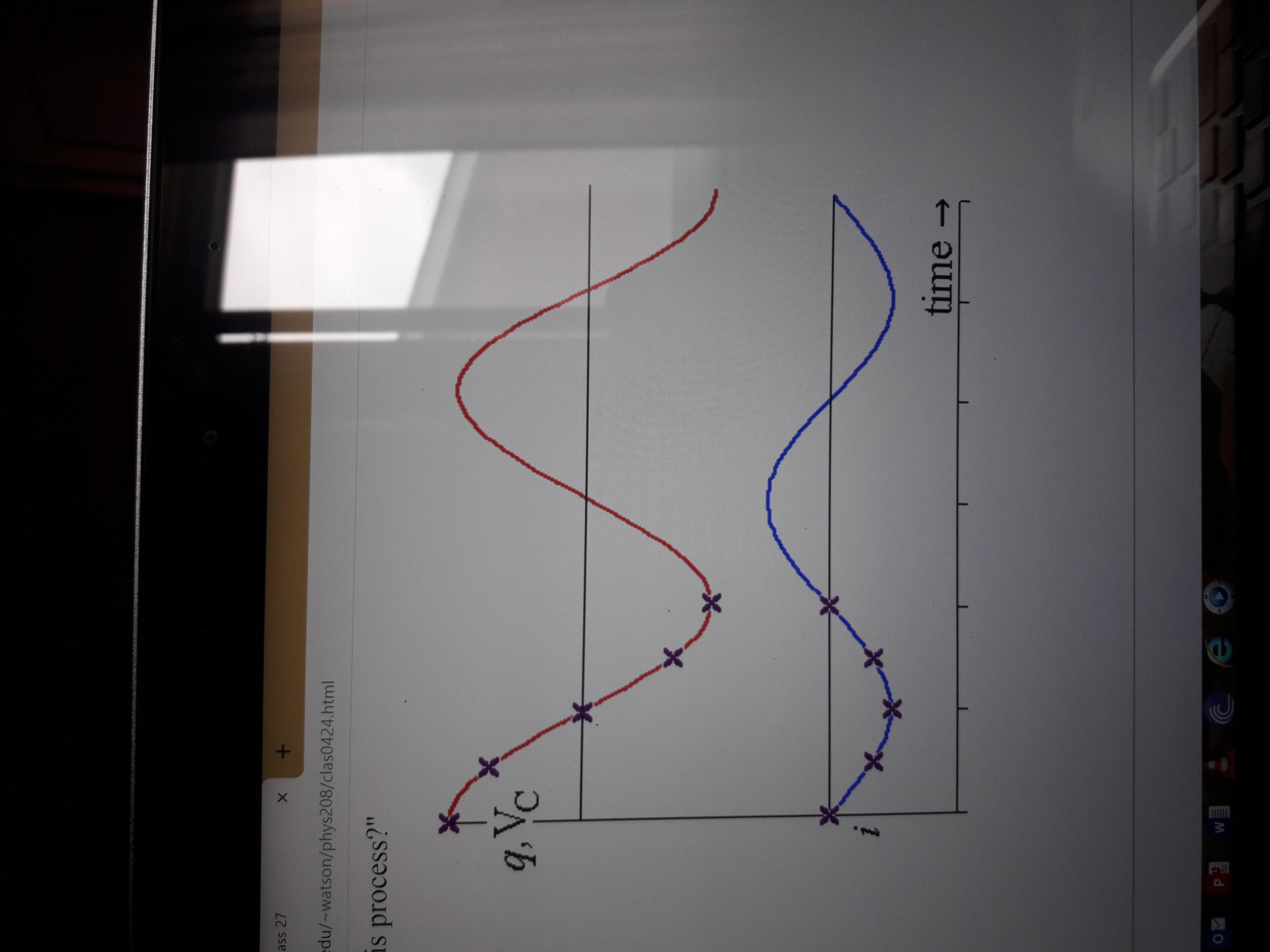

Let's look at a sine wave (music).
What does a single capacitor do to the waveform? I will assume we all know this will apply to the tweeter (in a 2-way), tweeter and midrange (in a 3-way), etc.. A single inductor on a woofer will have the same effect, but shifted. Let's stick with the tweeter's capacitor.
A single capacitors affect on the sine wave. This crossover is asymmetrical (both pictures). The 2nd order L-R series crossover (which adds a second capacitor, on the -ve leg) is symmetrical. Can you hear the difference?
Build it, listen, decide.

...none of which has anything whatsoever to do with the question about whether you can create a 3-way series crossover (which you can), or the fact that you can't assess any audible differences (should they exist) between a series and parallel filter if the two filters are not equivalent.
