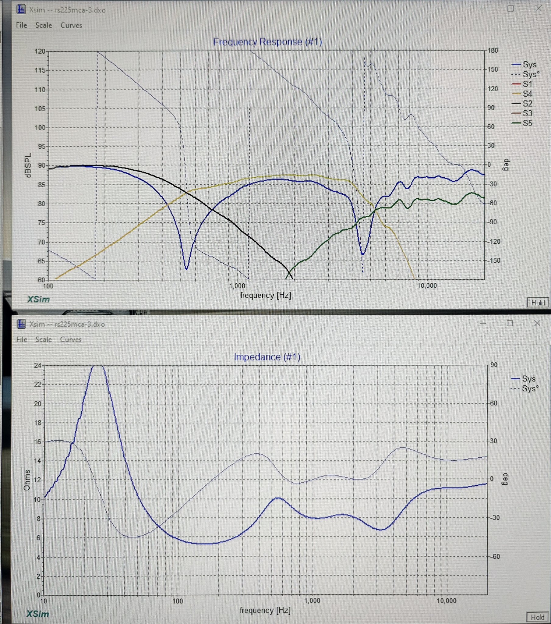

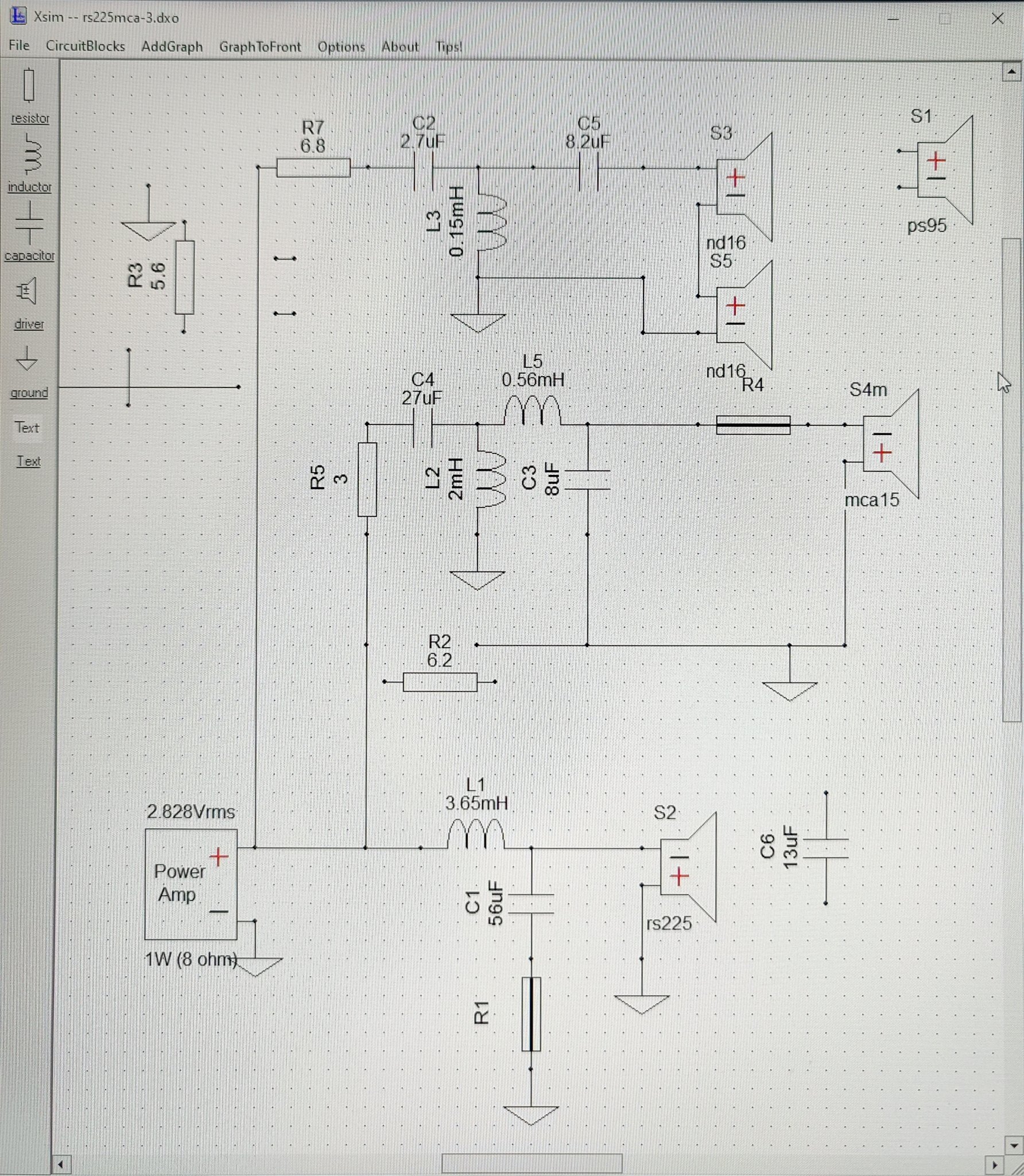

This is an approximation of the XO at the moment. Apologies for poor screen photo.
The 2 X tweeters are there just for simming the impedance. I guess I could have just used 1 X 8ohm as I don't think XSim can simulate a dipole. It helps give me an idea of values of filters if not for level.

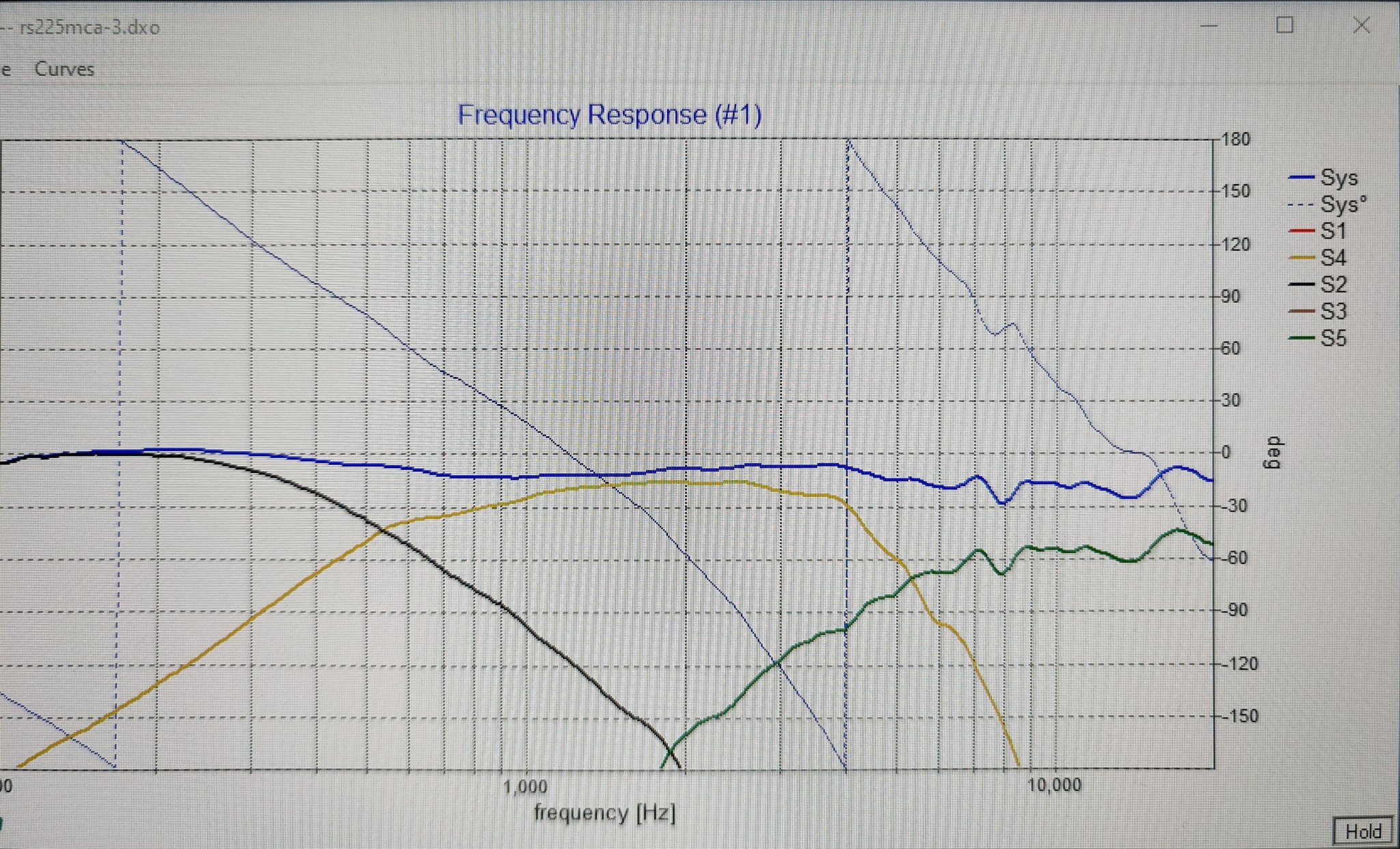

And for what it's worth the hypothetical FR.
When I had the Lpads in I had a beautiful flat impedance and phase nice and close to zero, but albeit a very low impedance.

A quick go on XSim this morning and looks like a zobel will really help. Definitely on the mid. Maybe 10r and 10uf or so. An online calculator (MH Audio) gives R7.25 C 13.89uf. Shall try that and then look to tweak the filter after that.

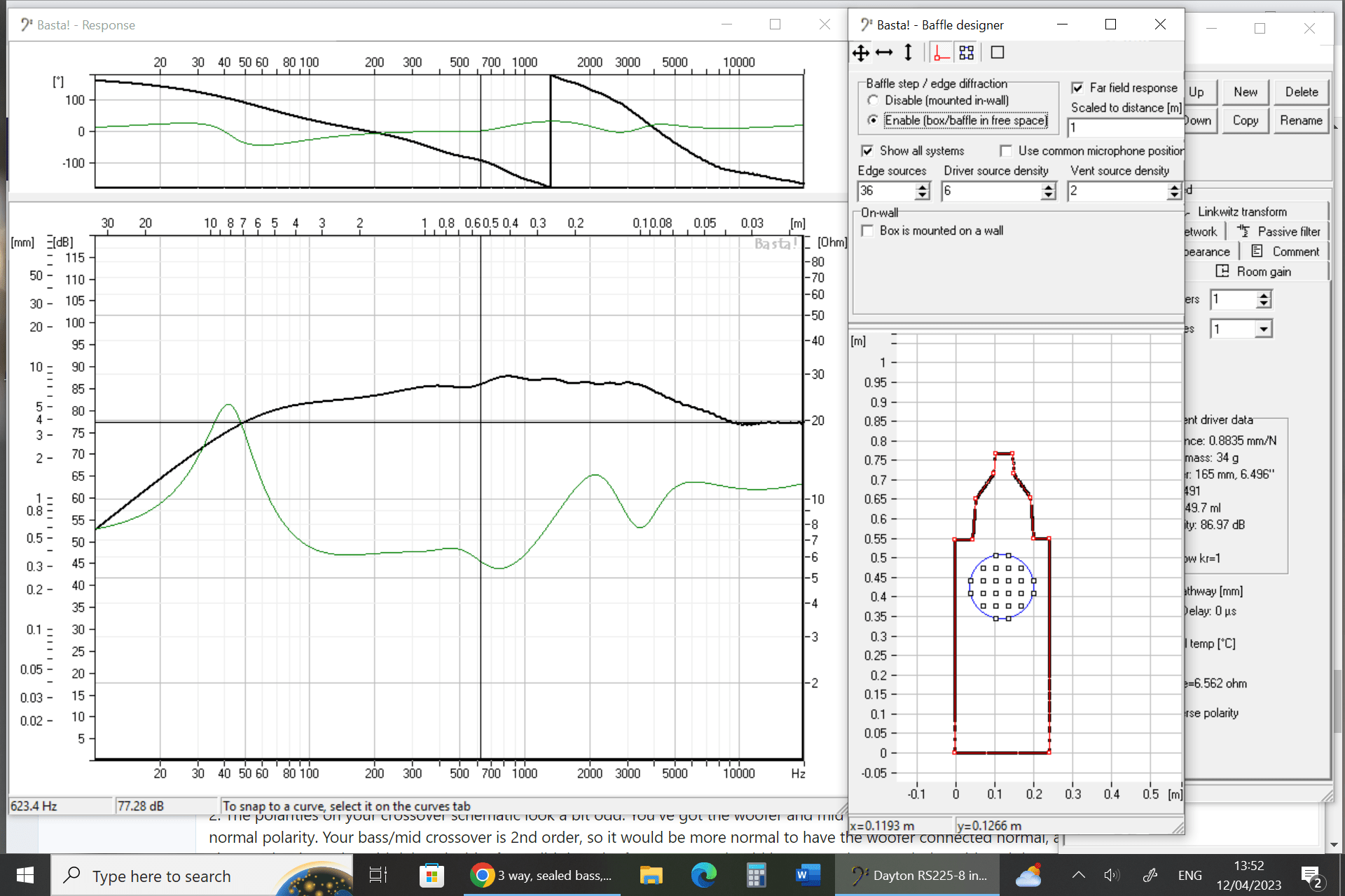

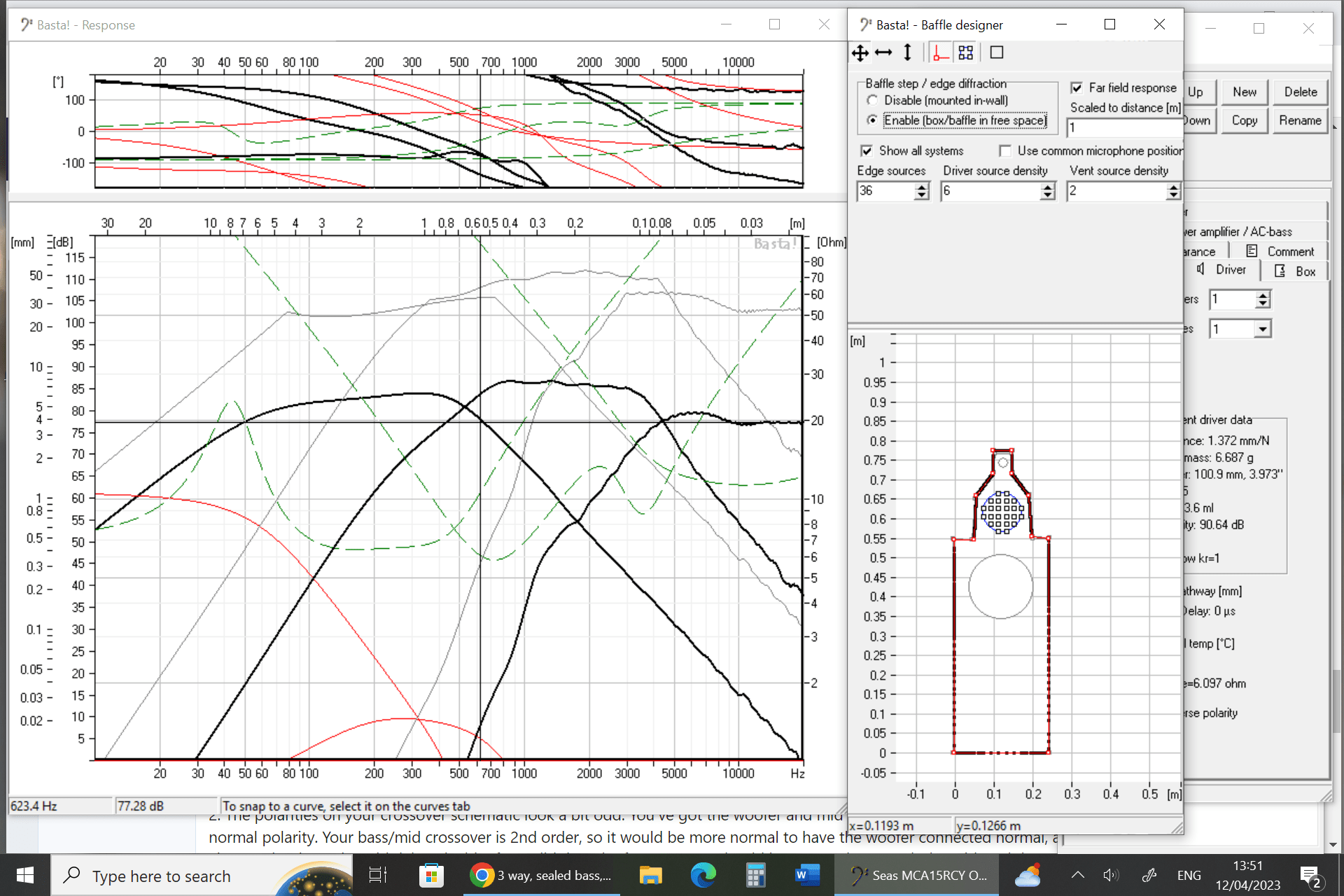

A few thoughts:
1. Regarding polarity, I'd definitely try having the tweeters in opposing polarity, so that the the rear tweeter moves in sync with the front one. If you have them wired pos to neg, as you do at the moment, you'll not get a dipole radiation pattern, but something closer to omni.
2. The polarities on your crossover schematic look a bit odd. You've got the woofer and mid shown as both being reversed, while the tweeters are shown in normal polarity. Your bass/mid crossover is 2nd order, so it would be more usual to have the woofer connected normal, and the mid reversed. You might also need to have the mid delayed a bit. If you did that, the front tweeter should be reversed, to match the mid, and the rear tweeter normal, so that it moves in sync with the front tweeter.
3. I've had a go at a sim of this in Basta. Note that it's not using any measured responses - just TS parameters - so it isn't going to be terribly accurate. It won't show the effect of driver resonances/break up etc. But I do find it quite helpful in this sort of situation, especially for getting an idea of relative sensitivities etc in a given box/baffle. I've set it up to use your baffle/box, with the woofer sealed and the mids and tweeters OB. And I've entered your crossover values, with a bit of guesswork for the inductor resistance.
The design looks decent, but it does suggest that you might need to pad the mid down a fair bit more, and the treble a bit less. The Seas mid is pretty sensitive, and crossing where you are you don't lose anything to baffle step. By the time you allow for baffle step, the Dayton woofer is only giving low 80s. It look to me as if you might need something like at least a 6 ohm series resistor on the mid, and just 2 or 3 ohms in series on the tweeters.
The other thing the sim suggests is that even with these changes, the bass might be a little lightweight. You might do better with a slightly bigger inductor on the woofer. But then you'd have to take a bit more off the mids. To beef up the bass a little, you could also try a vent in that box. A vent of 60mm diameter, 180mm long would give a tuning frequency of about 35Hz, and that looks better in my sim.
But really, all of this is guesswork, groping about in the dark, without measurements. Hope it might help a little, though!

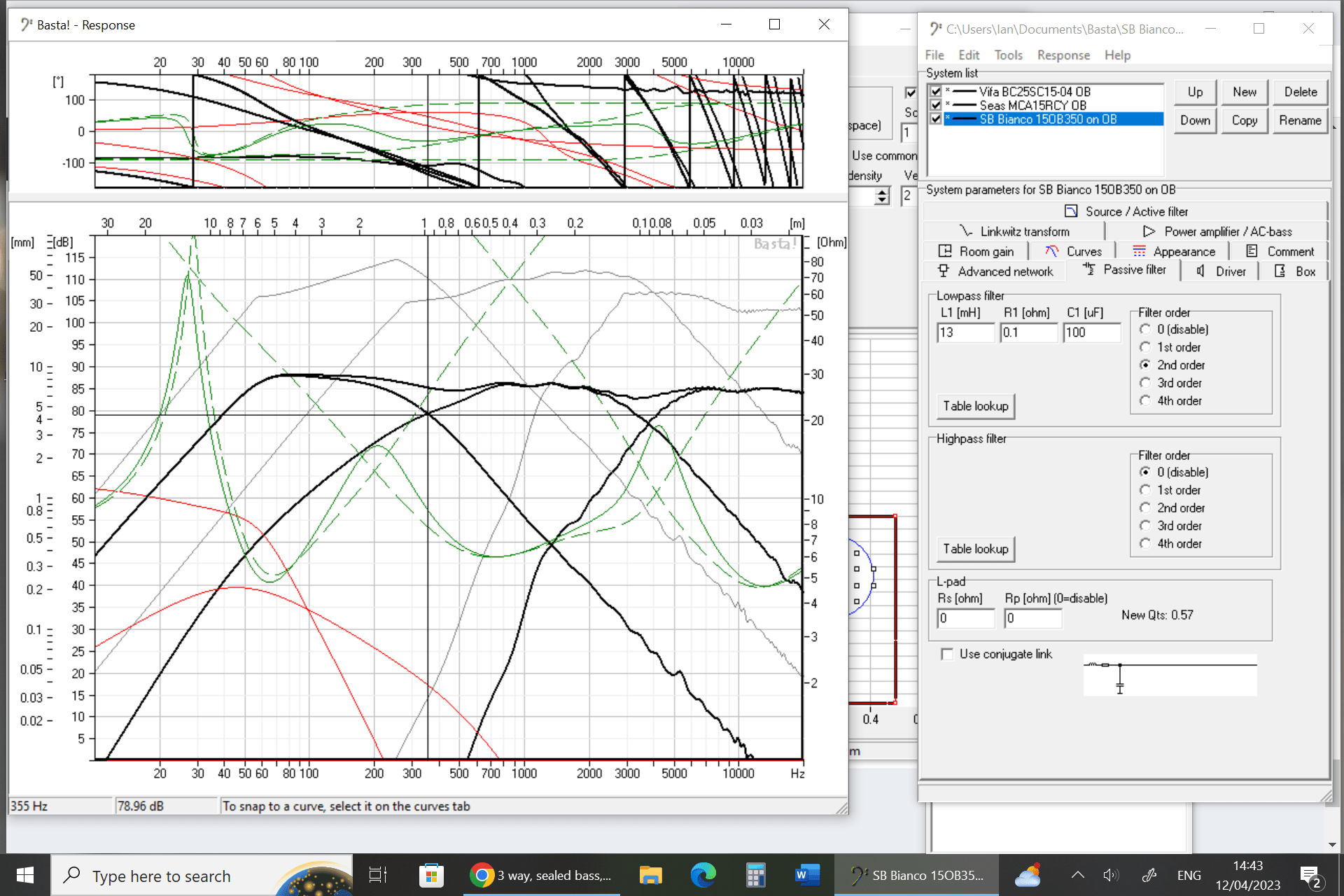

Here are some screenshots of my sim. The first one shows the predicted combined response of your speaker as is (but with the polarities as I suggested above). The second one shows the individual drivers as is. The third one shows the predicted response with some changes - vented box tuned to 35 Hz, woofer inductor upped to 5 mH, 8 ohm series resistor on the mid, 3 ohm series resistor on the tweeters, mid and tweeters set back 60mm. (Note, I've assumed both tweeters are the BC25. Too complicated otherwise!)
To be honest, though, I'd wouldn't put any time or money into trying these changes - I'd want to measure first. The sim is only a sim, and could be badly off.
If you did want to go OB the whole way, you could do worse than the SB Bianco 15OB350. Here's a sim of it with your mids and tweets. Woofer is on a 50 x 60cm rectangular baffle, low pass crossover is 2nd order (13mH low resistance inductor, Janzen C-core for example, and 100 uF). Midrange highpass is changed to 1st order (68 uF), and it has an L pad, 2 ohms series, 12 shunt. Lowpass midrange cap reduced to 6 uF. Tweeters have no resistive padding at all. Mids and tweeters are set back 80mm from the plane of the woofer.
Again, it's only a sim, not based on any driver measurements, and it's certainly not perfect. The actual crossover would undoubtedly need to be different. But food for thought maybe.

Thanks very much for all that!
1. The relative polarity of the tweeters was something I wasn't sure about from the go so yes I will try swapping the rear so they both move in the same direction.
2. The reversed mid was to show the nulls. Normal practice is reverse woofer and normal on the mid and tweets. That what XSim seemed the think.
I had sort of planned to cross at the baffle step or there abouts....500 or so and then reduce the rest to suit. I have another pair of RS225 that could come into play....3.5 way those 2 at the baffle step.?! Bass is plenty adequate as is really. Probably a lot of room gain. Vented always an option but I seem to like to stick with sealed.
I think you prempted what I've done with the padding. I've got 5r6 on both mid and high now but think it needs less on the tweeter to my ears. It lost some sparkle. Plan on parallel 12r over it as a test.
