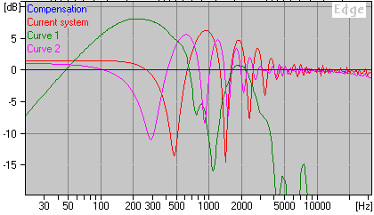

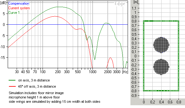

I've tried a floor mirror simulation for the woofer baffle, including some correction for the wings:
attachment.php
The dipole peak would be around 200 Hz. It looks like you can cross over to the Supravox anywhere from 200-300 Hz, having a margin of one octave to the rapid SPL fall-off from 600 Hz upward.
Adding the floor bounce for the Supravox for 3 (pink) and 5 m (red) listening distance:
attachment.php
If you are listening at no farther than 3 m distance you can try to circumvent the floor bounce by taking the woofer up to 400 Hz.

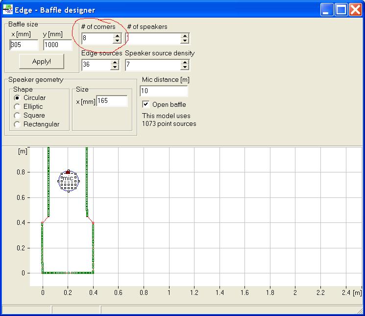

I downloaded the Edge but it looks like it only models baffles which are rectangles - not surprising.
It does flat baffles, but it can handle non-rectangular shapes. There's a place up top where you enter the number of corners/edges in the baffle shape. Also, in the graph, you can drag the corners around. I've modeled a baffle similar to yours - wider near the bottom, then narrowing in stages as it gets higher.
It won't directly do wings, so you need to 'open them up', i.e. add the effective additional width to the flat baffle.

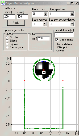

Thank you kindly for trying to model my design.
Yes the initial design is to have the 400 mm woofer near the bottom of a rectangular 500 * 800 mm baffle.
However it has the 240 mm Supravox on an extension of this.
There is no Supravox driver in that "two drivers" simulation. Maybe you need to better understand the concept of "mirror sources" WRT calculating floor influences. 😉
If you give a sufficient number in the "# of corners" field in EDGE, the programm will automatically form those corners into a circle or ellipse - depending on the values for x and y in the "Baffle size" entry. You only need to push the "Apply!" button
I used the lower four "corners" of the circle to make them into the attached rectangular baffle:

In EDGE, I've created the baffle with simmed wings as suggested.
in post #23 Rudolf you said
“It looks like you can cross over to the Supravox anywhere from 200-300 Hz, having a margin of one octave to the rapid SPL fall-off from 600 Hz upward”
When I work out how to position and size them differently from the 1st driver, without changing the size of the 1st driver, I'll do the 2nd and 3rd drivers (ie Supravox and tweeter).

I believe Edge only simulates one driver size at a time.
'Mirror source' - if you driver is close to the ground, the floor reflection reinforces the main drier's output (or, it plays in half-space, depending on how you want to look at it). I think that's what Rudolf was trying to model with the 2 drivers.
You probably need to model it one driver at a time, and for the woofer, include the floor reflection in the model.
