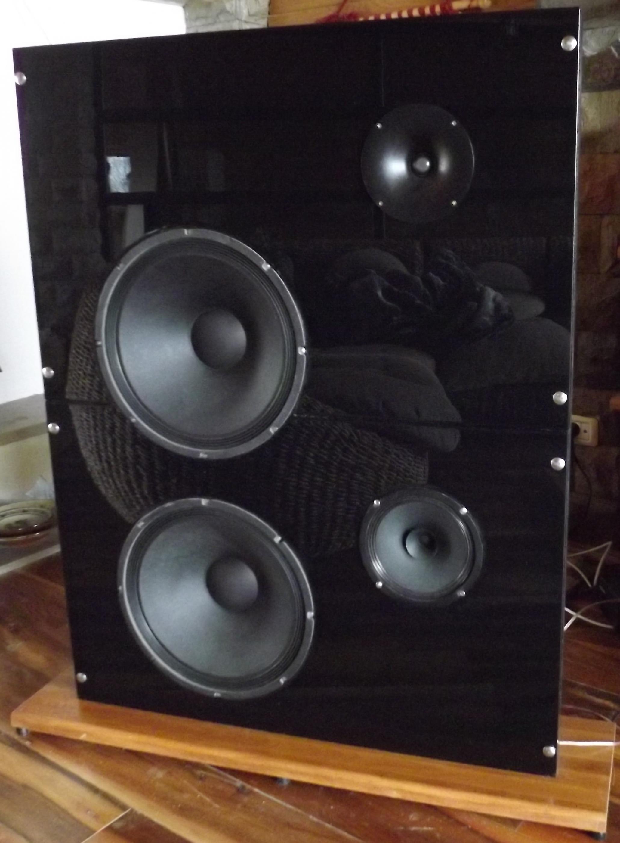

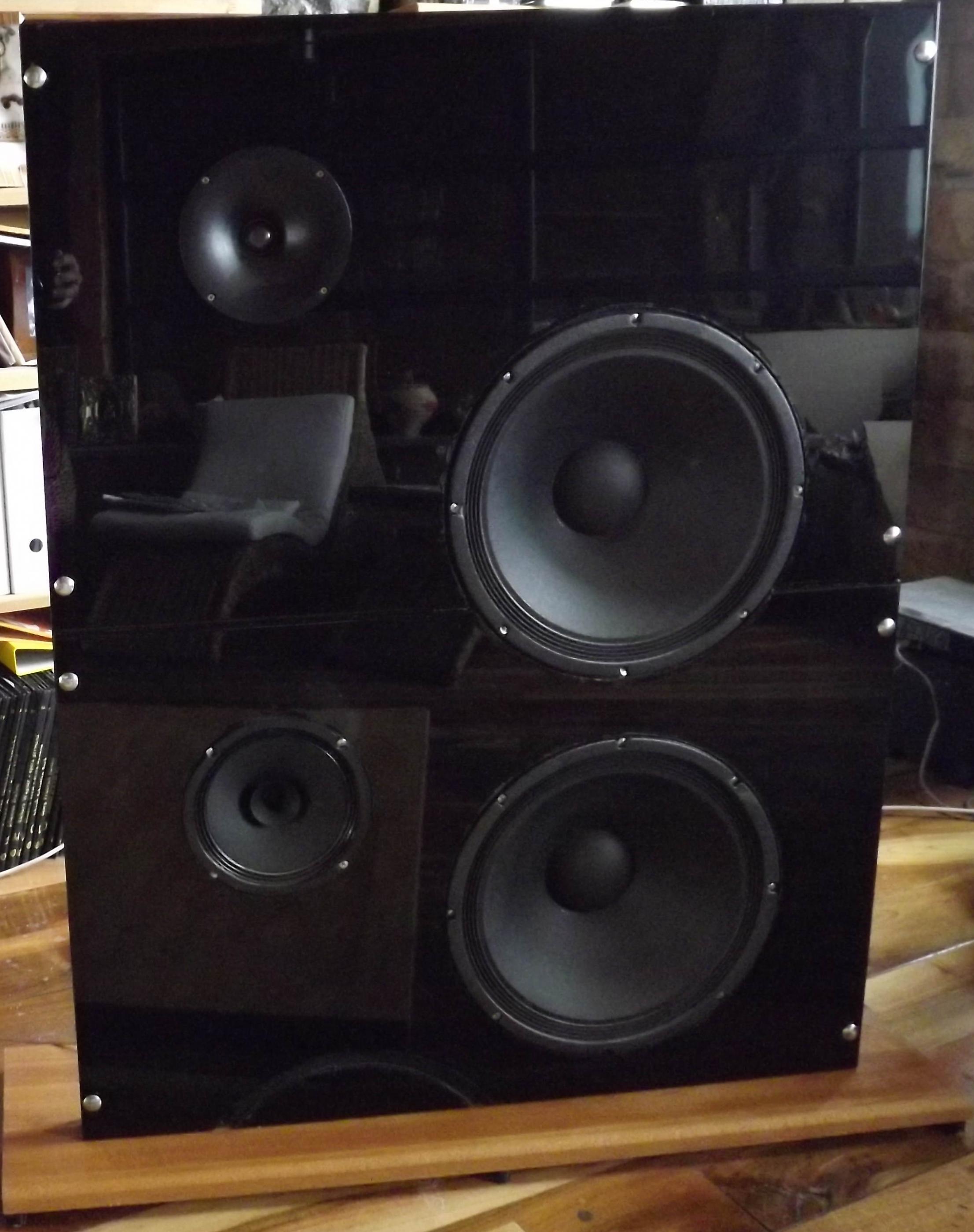

I started to buy speakers for OB project that looks like this:
Panel 125/83 cm
Bass: 2x Eminence Alpha 15A
Medium: Monacor SPX-200WP
Tweeter: Monacor DT-300 + WG-300
I really need help with the crossover from them. Waiting and any other suggestions as it is my first project of this kind.
Thank you!

It is a very very challenging task for passive xo and you need to do many many tweaks during setup! You will 3-4 (sub?) amplifier channels too and lots of nominal power because of poor efficiency - expect 12-18dB loss because of dipole correction.

My set up is similar to what your doing. I use passive crossover for the mid to tweeter, but definitely needed mini dsp for bass...plus a lot of wattage for the bass drivers.
is there any reason why tweeter and mid are so far apart? usually these should be as close as possible

In fact affter finished my third attempt to build this OB (the one in the pictures) everybody (family, friends) seems to be really impressed. Now after 3 month of listening I know what I want to improve: the mid and the tweeter. When I say that I want to improve them it is not because they sound bad. It is because I want more. So I am open to any advise/help.
Thank you all!
The 1.0 and the 2.0 attempt of this OB was with the mid up near the tweeter. I was not satisfied with the sound of the mid and moving the mid way down improved a lot the sound. I didn't changed the tweeter position after that but there is room for improvement in the 4.0 version.is there any reason why tweeter and mid are so far apart? usually these should be as close as possible
I will try three different drivers in the next month and I will post the results.

I was thinking obviously to align 'em vertically.
Now it...sounds...like a three way D'appolito

If you don't get the MiniDSP 2x8 or similar you could get the NanoAVR + some AVR, then you get 8 channels with neat cabling and you can tinker back and forth as much as you want. Much easier than fiddling with passive XOs.
The bass driver offsets are way too much, especially the
latter case. Centred 62% across the baffle maximum.
The latter design most of the baffle isn't doing much at all.
