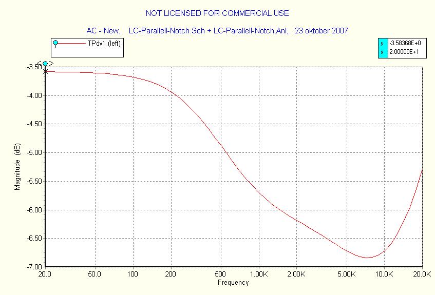

can you elaborate on this. I thought a PLL filter was adequate to tame the B200.
BTW the Supravox 215 Sig. does not have this rising response but is twice as expensive.
I have own experience with the digital active solution and with the by me proposed LR-circuit in the gigantic 'Darkstar' thread in the AudioCircle.
Once you have heard the active setup you realize that the passive filter takes away a bit of naturalness and openness.
I have not heard Planet10's Phase Plugs which I think will be a good investment. Regarding the PLL-circuit I have simulated its effect in a Spice-simulation which looks like this chart. It is about half as effective to take down mid and treble response as the passive LR-circuit
/Erling

then why not an active L-R circuit or atleast a passive line stage L-R ckt.
