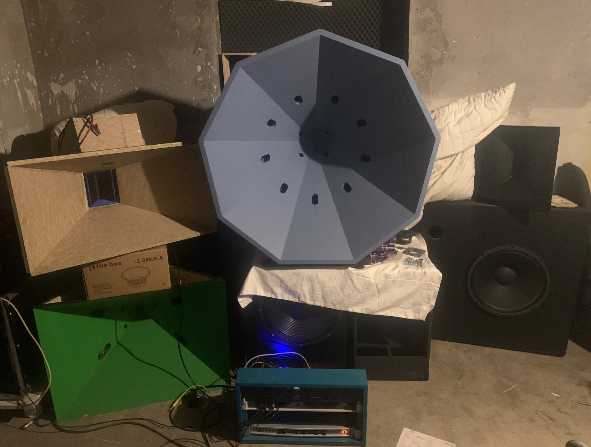

I found out I am out of M6 threaded inserts🙁 On the other hand, I had success mounting the stand on the horn using a dowel drilling jig for the first time🙂

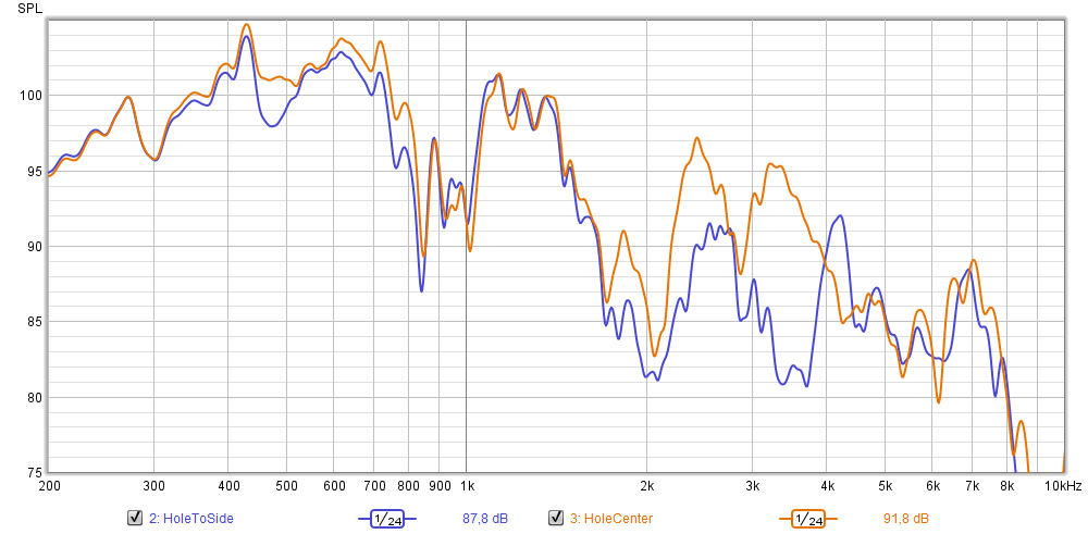

These are my results with open back and small baffle. The 300 Hz dip most probably comes from that. The difference is not great, but there is some. Especially around 475 Hz, that dip seems like cancellation from different path lengths to the hole. Also, there is more HF noise from the hole in the center. Even though the center hole brings the entry further from the throat, it should be still possible to crossover to the AMT. Hornresp confirms that, so I will use the center hole.
I tried drilling a smaller entry hole (5 cm2) and that is clearly making things worse. Now I need to drill the proper entry hole and tune the DSP. I still hope to avoid using smaller mids in this project.
Now it finally plays fine, with 2x12" bass section from another MEH below it. The entry hole is a bit further than optimal, I think I will just have to use smaller mids to get better integration. Also, the 8PE21, for some reason does not sound as good as in the larger horn before.

This is a picture of the test setup, the MEH is delayed a bit - not ideal, but it sort of works.
Now I am listening to some favorite tracks and it is definitely not bad, especially the efficiency is nice, the amp lights barely flash.
The "center channel" is not connected, but the illusion is that it is the only speaker playing is cool. I guess all the unconnected speakers make things worse as well.
