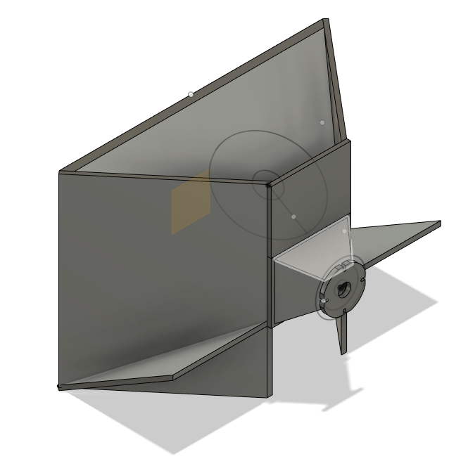

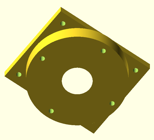

Since I have recently acquired the wonderful Beyma CP755Nd 1.4" drivers, I started planning a large MEH with them. 3 way, single flare (with the option to add a secondary flare). Mids will be 4x Faital Pro 3FE22s and the LF 2 x BC 10CL51s. The LF might be also a single 15" (if it can fit the horn), since I have two Eminence Deltalite II units at my disposal.
The 3D (80 x 60 dispersion) model shows the entry part with driver flange for 3D printing. I yet have to try more options here - it needs to fit my printer. This part can be also left out and replaced by plywood in a more traditional way of building these.

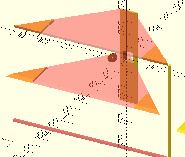

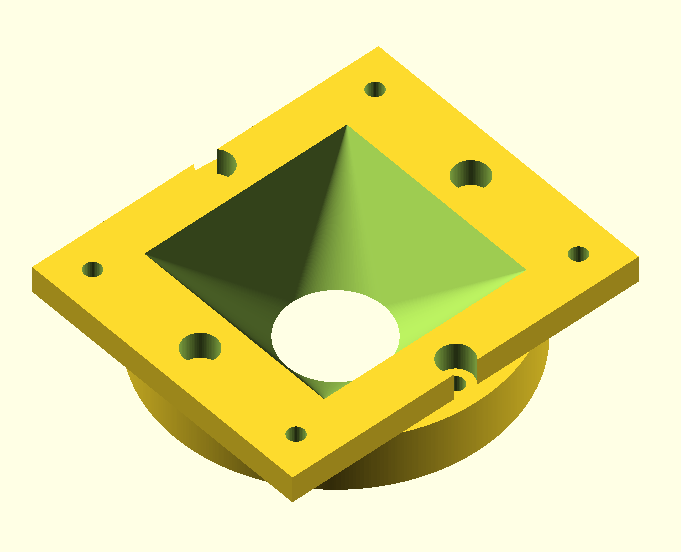

The project is moving ahead slowly. I am creating a fully parametric model in OpenSCAD for the plywood conical part, so that I can generate the STL or STEP parts with just a few clicks for different sizes, angles and driver mounting options.

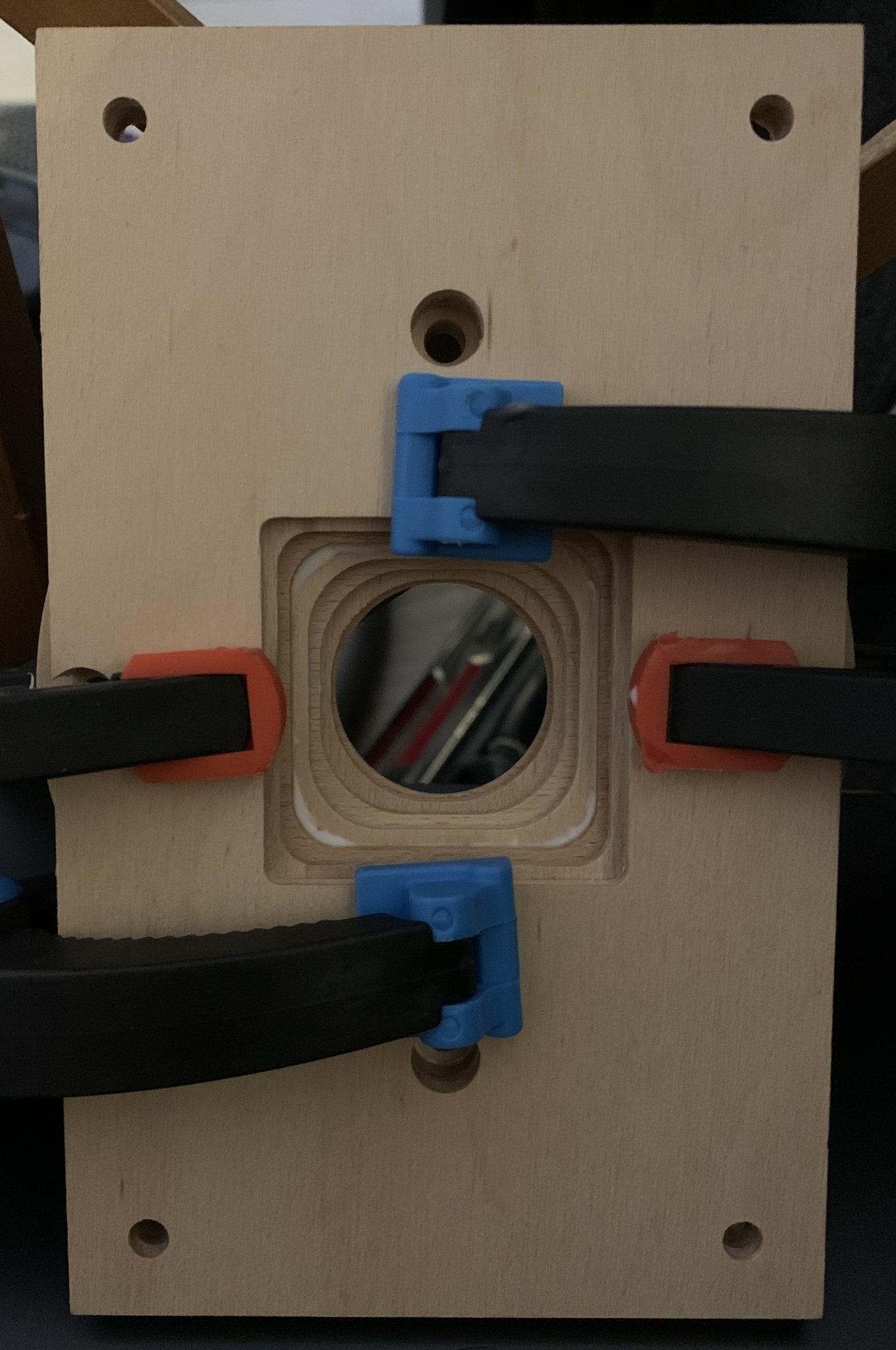

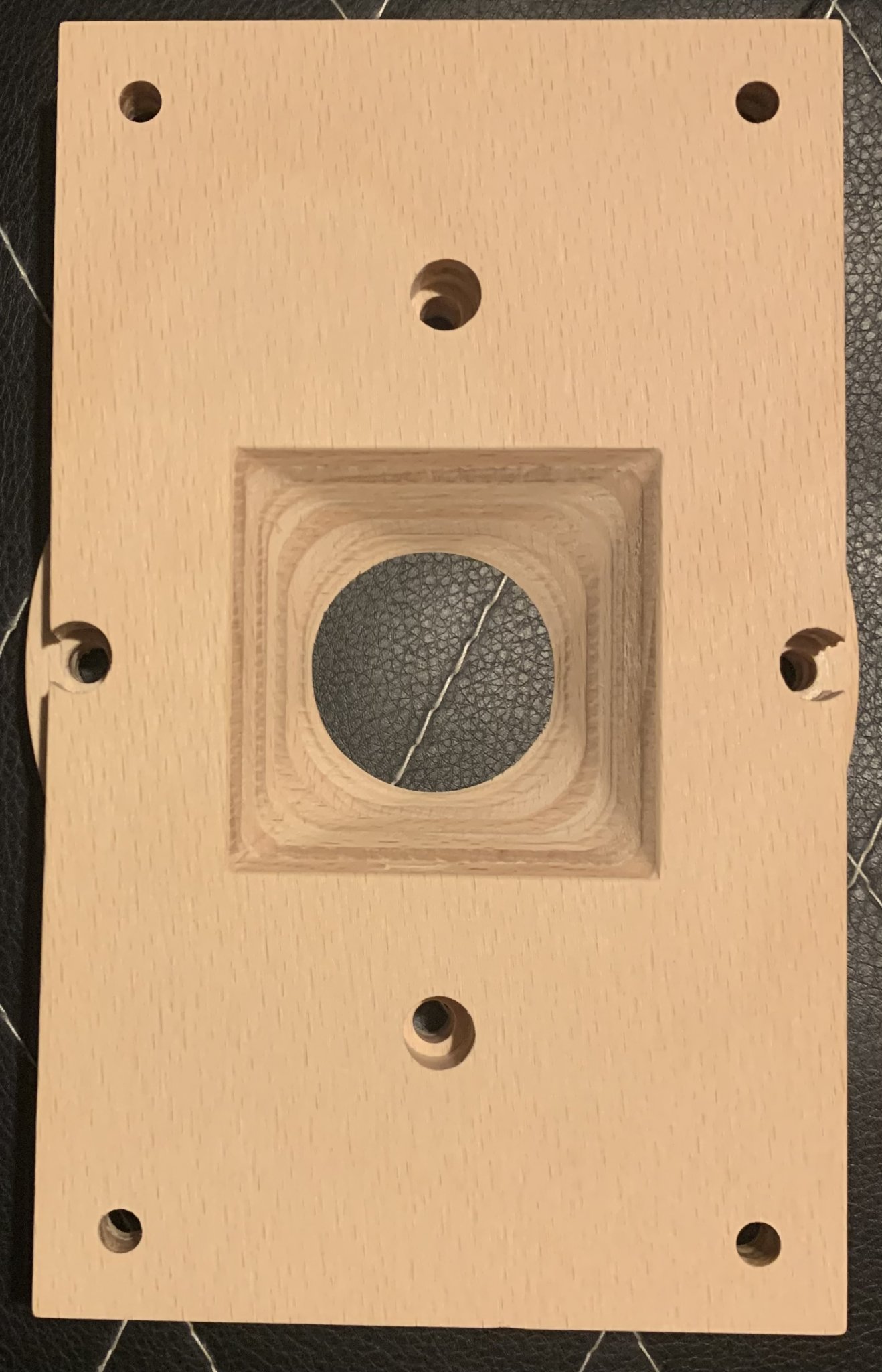

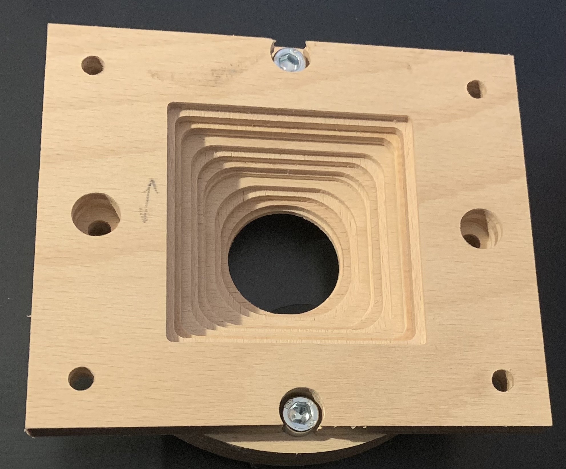

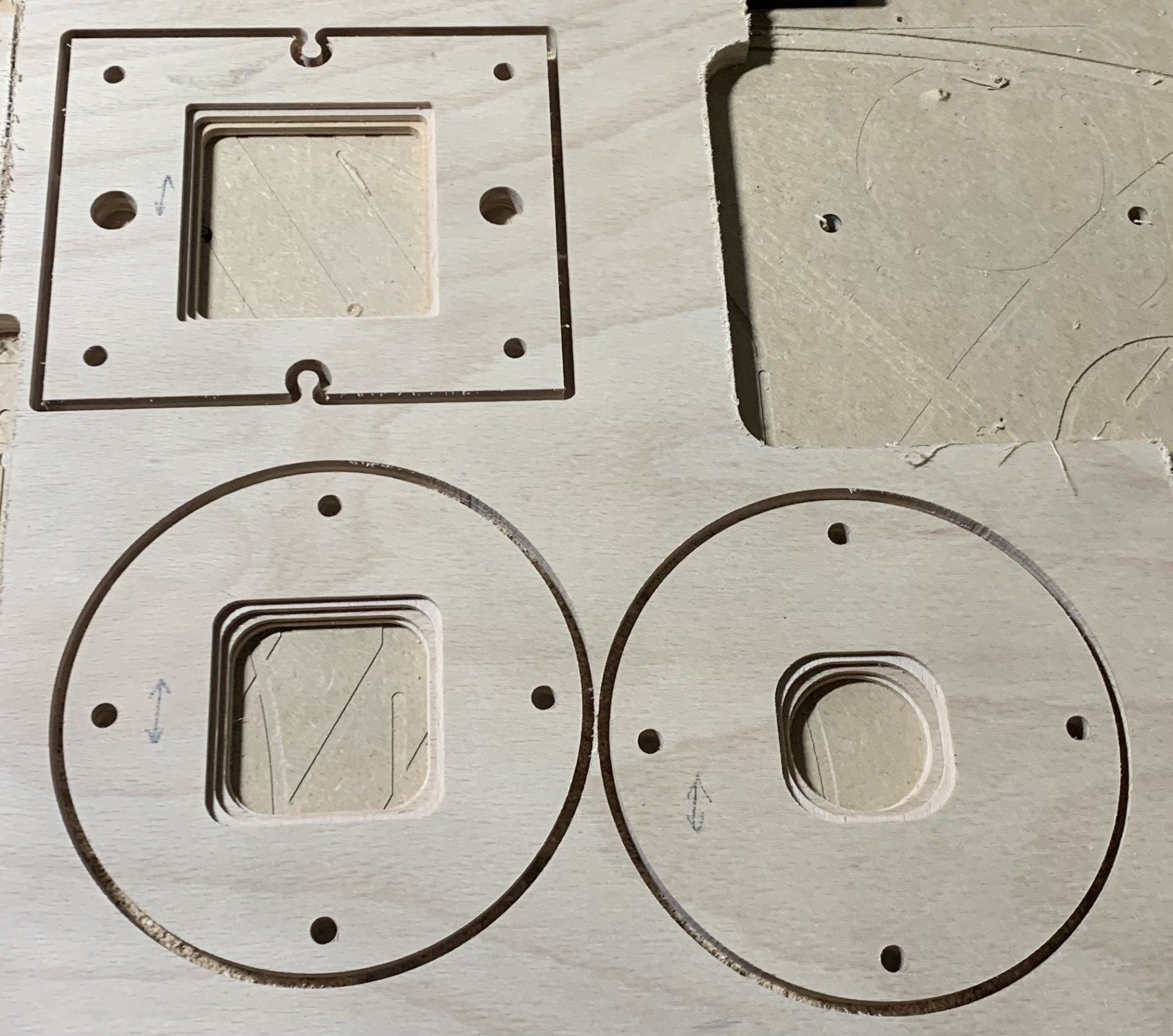

This is the adaptor for 1.4 inch driver to be machined from three layers of 10 mm beech plywood.
And the basic parametric model heavily inspired by @mark100 `s builds.
Looking good pelanj !
It's cool you can make adapters like that. Not something i know how to do yet.

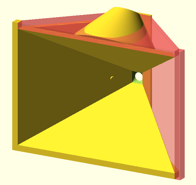

I'm sure you've figured out the name of the game, with the top-mounted lows, is figuring out the H vs V pattern and overall size of the horn, that let's the drivers fit underneath the lid.
Well, that's been the game for me at least, because i use the lid to seal them in without another box around the entire horn. Just saving weight 🙂

Your way of mounting the woofers was the main driver for making the parametric model - I find it really smart. Now I can try different options and watch for collisions - like the one in the picture. I will do some simulations in Hornresp with suitable woofers to decide later on the final dimensions. It is a long term project, I am still not fully decided if the HF will be a CD or the big Heil AMT. Most probably, I will build both as prototypes from chipboard or OSB and decide based on the outcome.
I think the prototype will use two 4NDF34 and a single 15" - most probably the DeltaLite II 2515 I already have. The pattern will be 80x60 or 90x60, the largest dimension of a single panel is limited by the size of my CNC - ca 80 cm.

OpenSCAD is quite handy for the parametric stuff. I found it easier to use than FreeCAD. The script is far from finished and not documented at all, but I can share it for inspiration if someone is interested.
There is a really cool looking library called "Round everything" - I yet have to install it and learn how to use it, but for flat beveled panels produced as STL for machining it is not needed. And another nice thing is, that the project file can be directly imported into FreeCAD as well and one can have a multibody STEP file in no time.
