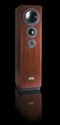

What you need is something similar to the DYNAUDIO Compound 4.
Dynaudio - Authentic Fidelity
I think this has double drivers:
Compound-system: a 2-chamber enclosure in which an inner driver creates the effect of an infinite air space behind the external bass driver
