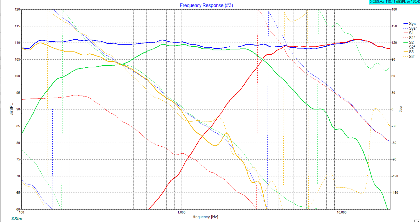

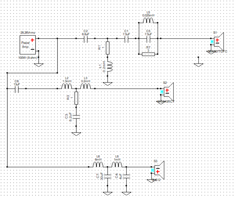

Looking for some help with a 3 way passive crossover design. Many years ago, when I was a bachelor... I built a 3 way speaker with an active crossover between the mid/woofer. Today, the speakers are sitting in my garage. Unless you all know something that I don't, active crossovers with multiple amps - while great in theory - are not practical in real life. Input sources + pre-amp + active crossover + multiple power amplifiers - if done right = $$$$ + space and not = WAF... I just want to have a pair of speakers using these drivers that I can move without a forklift and power with a Stereo receiver.
I know the woofer and mid are not ideal pairs for a passive design, but we should be able to make it work. I downloaded X-sim and have cobbled together something that appears to be reasonably flat... I copied the tweet/mid crossover from "The Poor Man Strad" which uses the same mid and a similar tweeter (27TFFC v. my 27TDFC) - and it looks really good... (I think)
A few things I'm unsure of:
1. I used frd and zma files from traces of manufacturers spec sheets. I know I'm supposed to measure them in box, etc... but looking for input on whether that is a nice-to-do or a need-to-do. Generally, I'm planning sealed cabinets. For the mid, Seas states the enclosure that was used for the measurements, so I could replicate that one.
2. Baffle design - I know it matters, but will it have a substantive impact or a minor impact on the output?

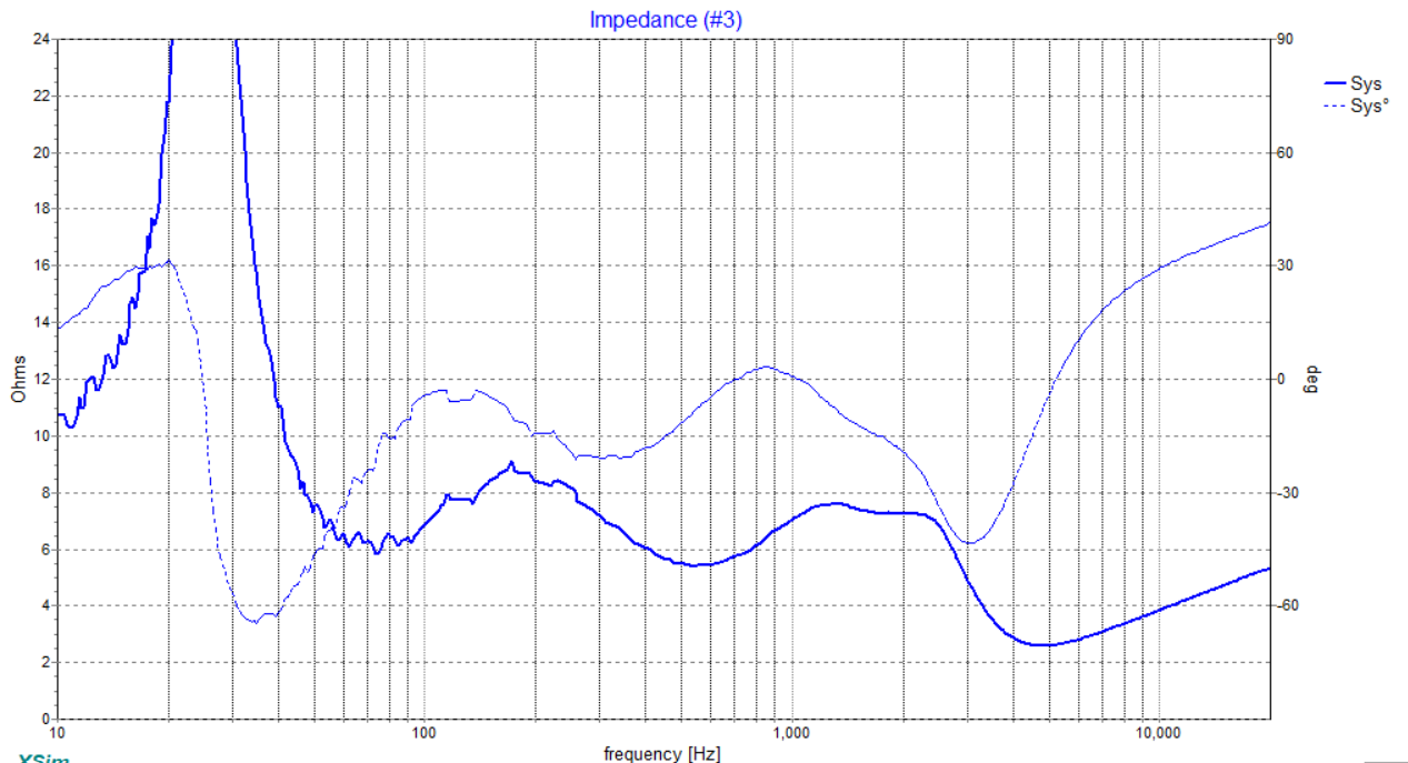

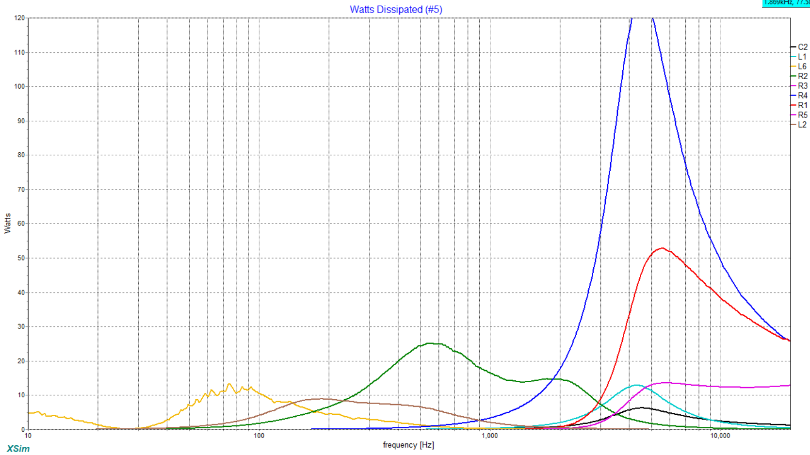

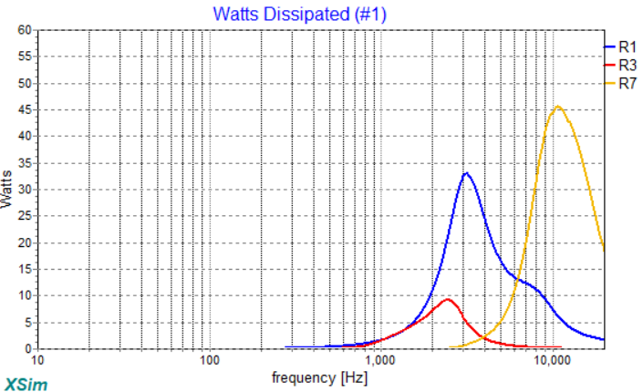

3. The resistor R4 seems to have huge power (110W) dissipation... is that accurate for real world conditions (ie. not a steady state sine wave at the peak power frequency of 4kHz)
3 b. System impedance above 1kHz gets very low... is that OK?
4. I haven't measured Z offset... is there a typical number which is 'close enough'?
5. Phase... I know X sim accounts for phasing in the freq resp, but not sure if there is more to it than this...
6. I don't know what I don't know - am I missing anything else?
Thank you kindly to all the brilliant minds out there.

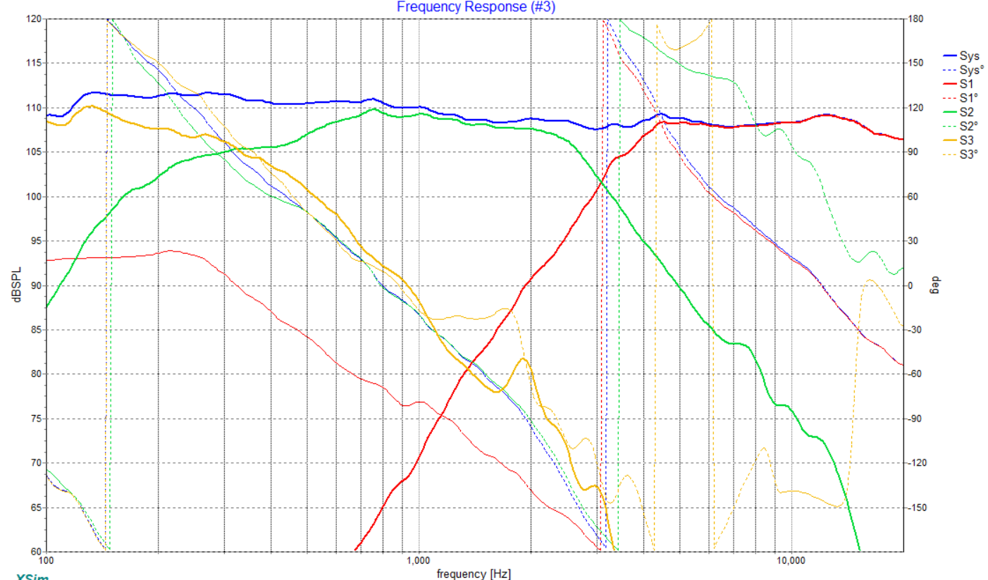

Here's another version based on the current mid/tweet crossover.
A few challenges:
1. When I modelled the crossover as-is, there were two issues: 1. the SPL fell off by a few dB with the tweeter, then it was peaking by about 5dB at 12.5kHz, so I removed the series resistor and added a notch filter to tame the peak down. Maybe I'm missing how the baffle would interact and I should just leave this alone?
2. The resonant impedance spike on the midrange interfered with any effort to put a higher order HP filter on the mid. As soon as I added an inductor, a big SPL bulge would appear after the XO frequency...
3. Is it OK to have a 4th order LP on the woofer, then a 1st order HP on the mid? It looks fine on the freq response, but does this introduce other problems?

Changing that value is like adding the resistor in the second circuit. It damps the resonance. As it was in the first circuit, the 10u and 0m1 may have been a little hot, and by the way also encouraged the larger dissipation of the resistor.
However you need to know that Xsim is giving you a theoretical 100W at each frequency. In real music you're not going to see that at higher frequencies.
Some of the questions you have asked want you to turn on phase. Click on each driver and ask Xsim to derive phase for the factory data, then select phase for each on the chart (using the menus at the top).
Out of all the variations that measuring gives compared to doing it this way, the first thing you'll want to deal with is that your baffle will focus the higher frequencies more than the lower ones. At some point in the hundreds of Hz you may want the response to drop by a few dB or more.

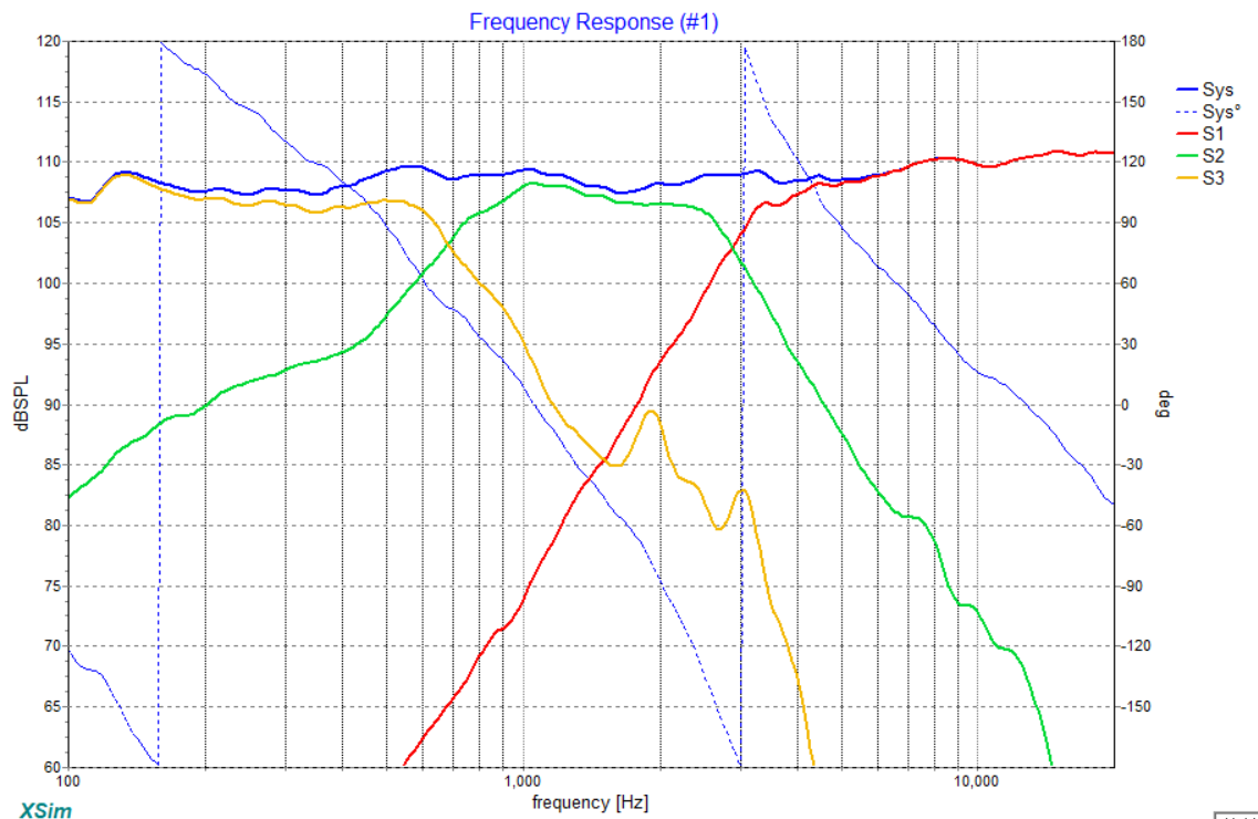

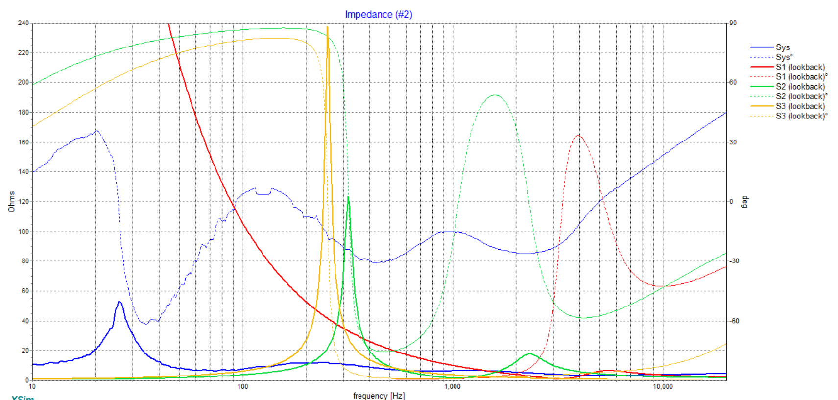

OK. Here are the Frequency response and impedance curves with phase (for the 1st crossover).
I'll do a little googling to figure out how to interpret good v. bad phase alignment

Yes, the SLS12 is 8 ohm.
I don't have the dimensions of the driver layout at the moment. The current box, which I'll likely replace, has the tweeter and mid on a narrow baffle (approx. 8" wide) at the top, and the SLS12 on a wider baffler (approx. 20" wide) below.
For now, you should get them to line up with each other. Telling just how good that is, is some next level work so it can wait for another day.
The lower cross looks OK. Notice the green upper midrange lowpass strays from the red tweeter phase plot above around 3kHz, going on a different slope. You can bring these closer by increasing the slope of the mid by adjusting L3, R3, C6 on your original schematic, and possibly adjusting the tweeter as well.

I see your impedance gets lower around 4-5kHz, it isn't too bad. There is also a small response peak there and the whole tweeter could also stand to come down another smidgen in my humble opinion. If you want to play with resistances see that what you do achieves all these things at the same time.
