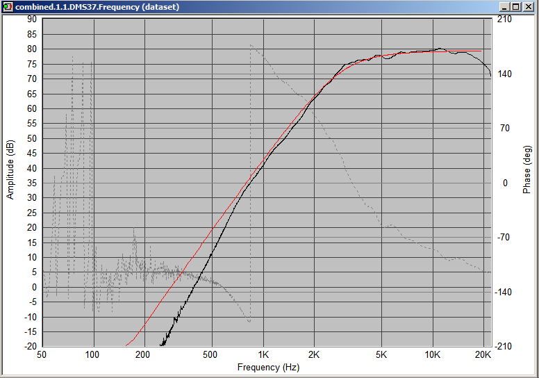

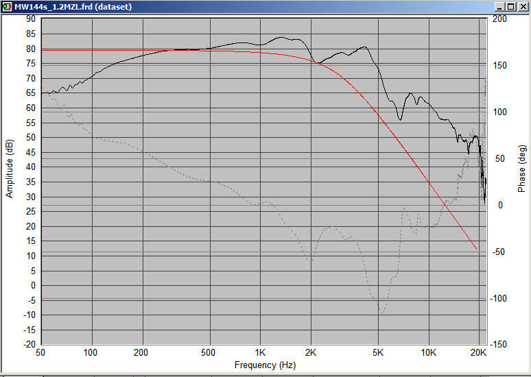

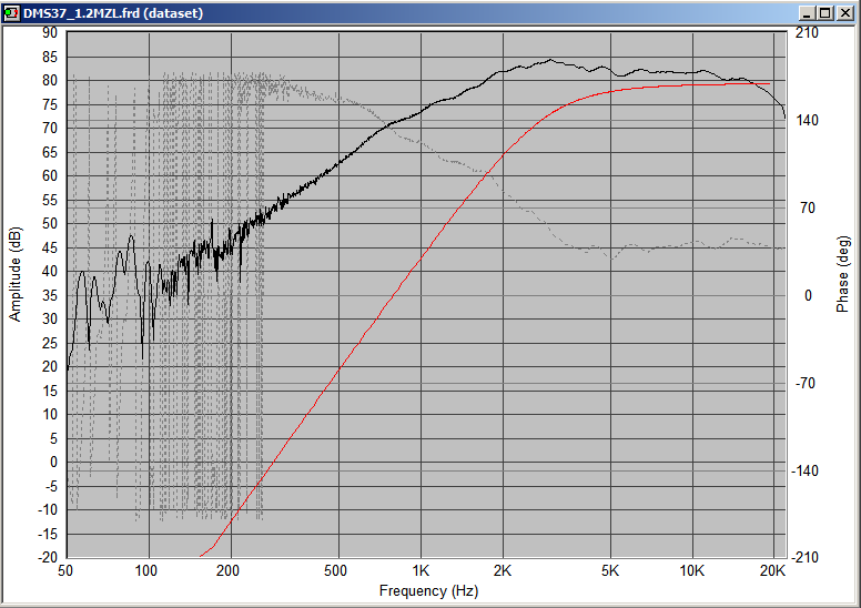

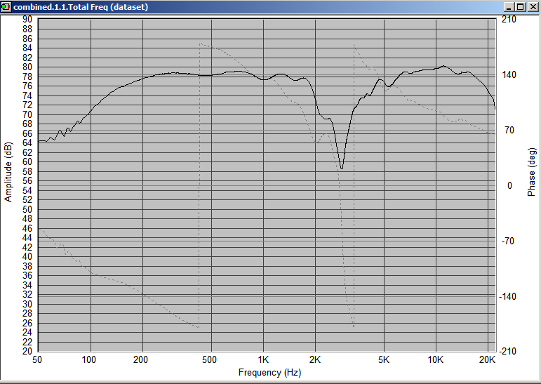

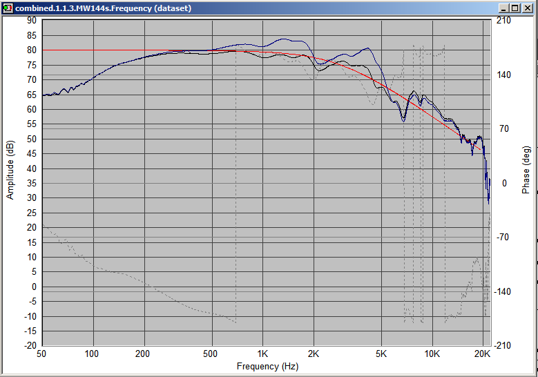

OK now I know this is a completely different speaker, but this is to give you an idea of what you are aiming to do with simulation. These are from my Morel MTM consisting of two by MW144's and a DMS37.
Measurements were taken at 1.2M on axis with the tweeter, and zero locked after the tweeter measurement to ensure that the phase information remained the same for the two drivers (ie it takes into account their relative offets).
The first picture is the MW144's raw measurement the red-line is the target acoustic response, which is a 4th order bessel at 2.8Khz. I opted to go for pretty much full Baffle step compensation as these speakers will ultimately be mated to stereo subs at a crossover frequency of around 300Hz.
The second pic is the DMS37 raw response with the target 4th order bessel at 2.8Khz in red.
The Mw144's curve as you can see presents some problems when trying to get it to match the target response, a traditional fiter just wasn't going to get it done, so I first did some notches to get it to better conform to an ideal 12db/octave rolloff.

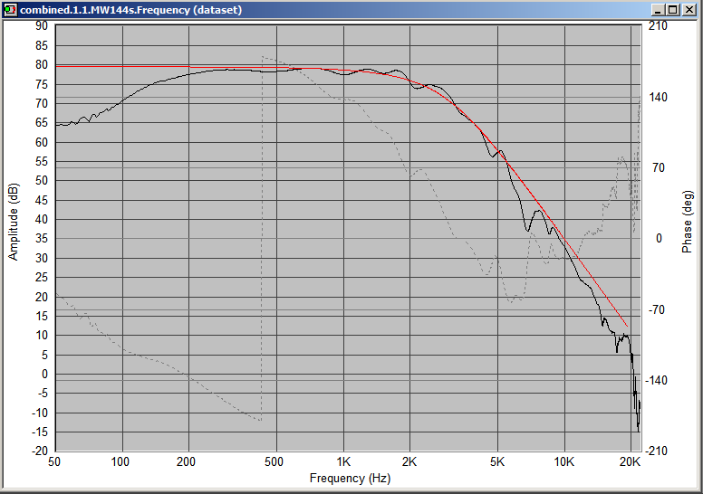

The third picture shows the results of putting two notch filters on the woofers. Note that I'm showing the final notch filters that were optimized in conjunction with the rest of the filter. The red curve in this case is a 12db/octave roll off at 2.8Khz.
The fourth pic is the tweeter response after the crossover has been applied.

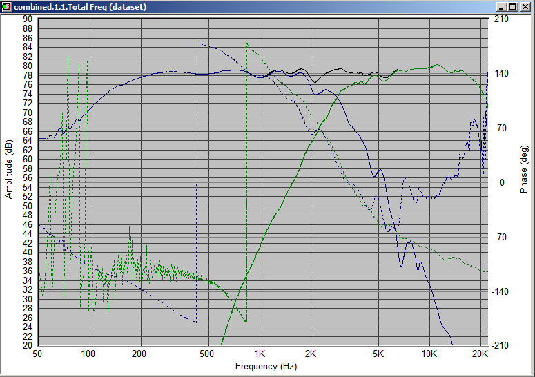

The 5th pic shows the woofer and tweeter response on the same graph, and more importantly their phase response. Note that through the crossover region the phase tracks well. The black curve is the summed response.
the sixth picture shows the response with the tweeter reversed in polarity. the null is at around 2840 Hz, so pretty close to the target.
The 7th picture shows the final measured response of the speaker using the new crossover compared to the simulated response. The blue curve is the real measurement, This was done in a bit of a hurry and not optimally set up, there is something screwy with the phase, but it gives an idea as to the match between the sim and the actual final result.

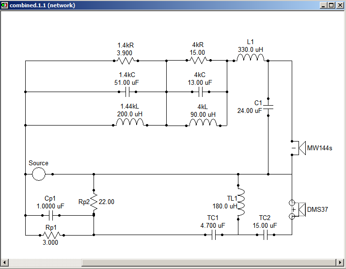

Finally it wouldn't be complete without the actual crossover circuit.
I know that this isn't directly relevant to your project, but hopefully it gives an idea as to how simulation can be used to end up with the final desired result.
Note that I originally had just the notches on the woofer, and a 1st order electrical (ie just a cap) on the tweeter (2nd order bessel at theoretically 3Khz). This I used for around a year, but the phase matching through the crossover region was poor. I was never happy with the sound, and the crossover above is the result of many hours of fiddling doing sims. I built the crossovers based completely on the sims, and I'm very happy with the result, and have not felt the need to tweak further.

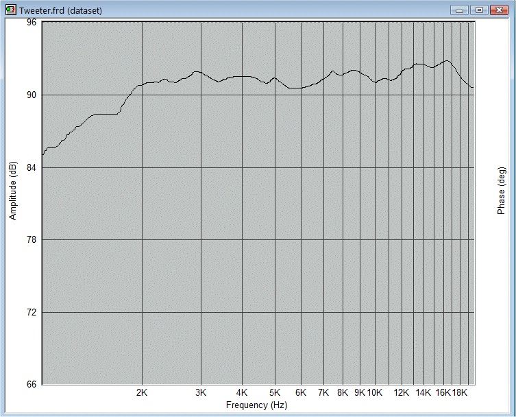

Allen I was curious as to what I should do seeing as my tweeters graph(From Manufacturer) only goes down to about 200hz. Do you believe this will cause any issues?
As it turns out it worked just fine. I attached a copy of the Speaker Workshop file as I have it on my computer. I am hoping to start modifying the files to work at my target curve and bring things together. Thanks again to everyone who is being so helpful I'm glad nice people are out there willing to help those less informed.
The only concern I have had with SW and FRD files that are different, is the default scaling which isn't technically a problem. Otherwise I would have loaded the chart into SPLtrace, indicated where 200Hz is and that I wanted to go from 20, and entered some insignificantly low value for the lower frequencies.
