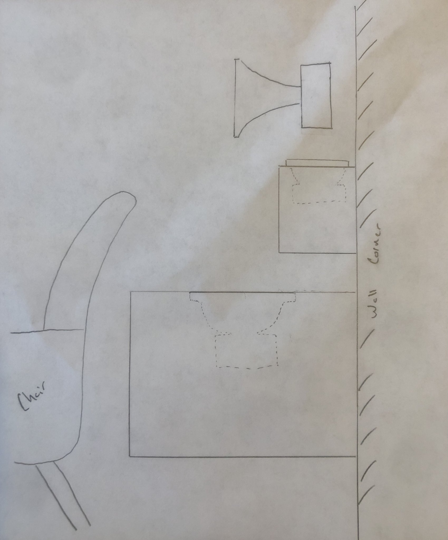

hey all, in the never ending adventure to both have nice sound and WAF, i'd like to try to build a speaker for corner placement, which will mostly be behind a chair in the corner. This is for mono playback, so there's no second speaker, just one speaker in one corner. I'm currently listening to a linkwitz pluto, but although i like the sound the omni pattern and it works well with mono-playback, it really wants a closer listening position and i don't want to keep dragging the speaker out from the wall every time i want to listen.
The whole thing will use minidsp for crossovers/eq. Primary seating position is about 16 feet away from the corner (see attached poorly drawn room layout). Right now unless the Pluto is close (<9ft away or so), there's too many reflections going on in a bad way (expected but worse than i had envisioned).
so here's what i'm thinking to try to play well with the corner:
highs (>1250hz): B&C DE250-8 compression driver paired with either a HM17-25 or H6512 horn (horn and xover point to be decided upon testing/listening)
mids(300-1250hz): Dynavox LY302F 3.5" tucked right into the corner as close as i can get it
Lows (40-300hz): Dayton RSS210HO 8" woofer
see attached bad sketch of how i would arrange the drivers. view is at a 45deg section of the corner. I neither enjoy nor excel at woodworking, so i was hoping to just use the denovo knockdown cabinet for the 8" woofer. so all i'd have to build is a simple box to house the midrange. Unclear right now if i'd just mount the midrange box onto the wall, or have legs that go down to the woofer box.
I've seen Wayne's PI corner speakers and if i had the space i might just buy that. but they too big to pass the WAF test.
all thoughts, comments, criticisms, better ideas welcome! Thanks!!!!

It's difficult to ascertain your purpose or requirements. A typical corner speaker would, at higher frequencies, be trying to stay off the walls. Your choice of horns with their smaller 5"-6" dimensions is not going to do too much below a few kHz. In any case, a 3.5" is going to be so wide down there that it might just collaborate, but to what end?
Reactions: santiu
Yeah that was the idea. Use some sort of waveguide until the 1/4 wavelength was greater than the distance that I could get the midrange to the walls. With a 3.5” midrange that would be about 2khz, so I figured if I used a waveguide to keep the high frequency reflections from the adjacent walls minimized, then below 2khz the midrange would be close enough the the boundaries that the first reflection from the corner could be ignored. Since at 2khz the 3.5” would be nearly Omni anyways then I was hoping to have a nice clean polar pattern from there downward with no reflections from the two adjacent walls. Does that make sense or am I being an idiot?
The goal was to have a single speaker fill the room as uniformly as possible while minimizing early reflections. It seems like those early reflections make a big difference as their amplitude is relatively high compared to the direct sounds since the source is so far away.
But then the 3.5” can’t play that low hence 3-way
In retrospect the HM17-25 isn’t a great choice. But the 12” wide H6512 seems like it might do the trick? I’d love to use a JBL 2384 but I think it would get kicked out of the room quickly

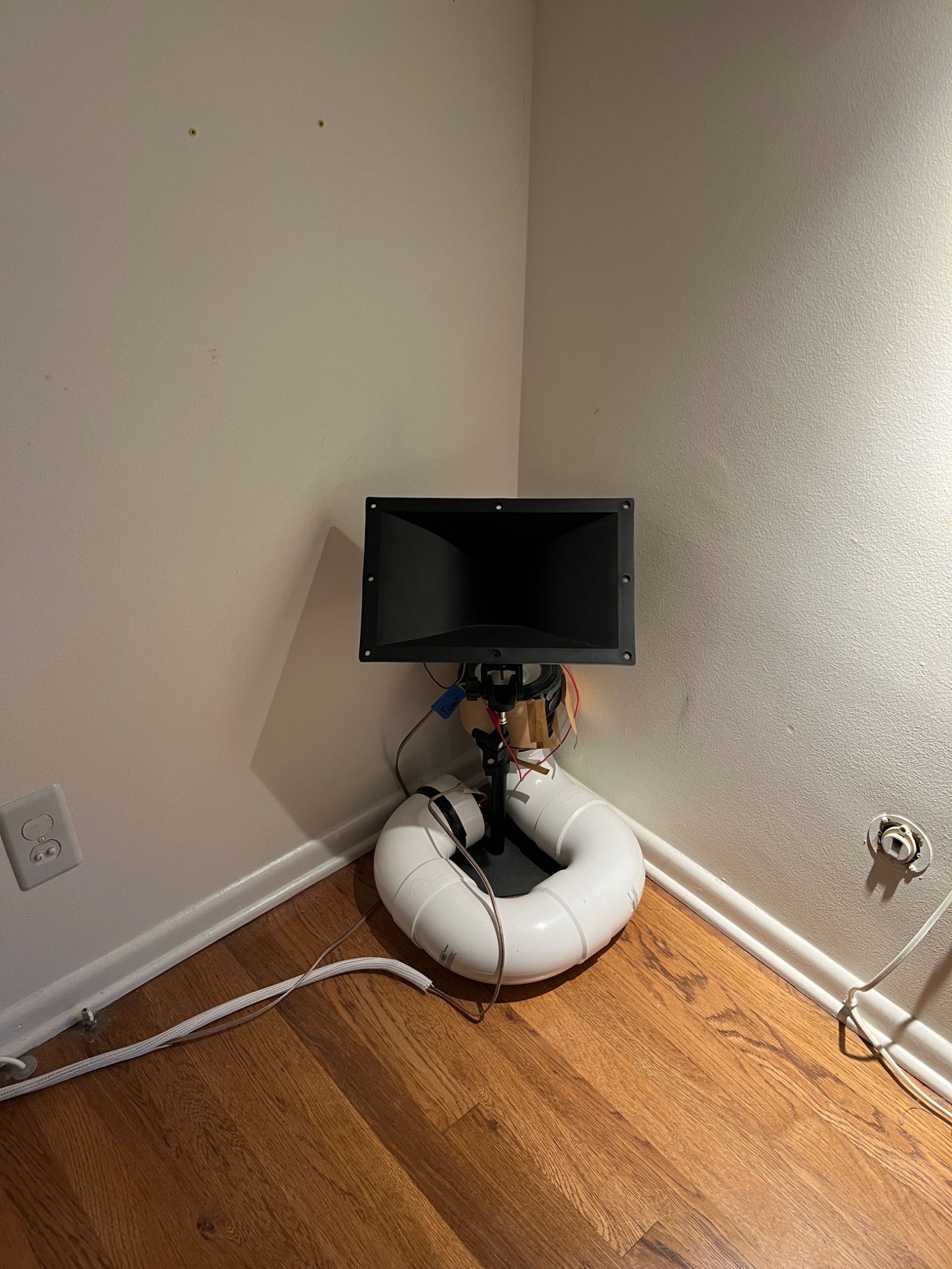

So jus my thought I’d post what I ended up settling on in case any one else out there is ever looking for a super WAF friendly setup.
I decided to try 2-way first to see how it sounded since it would be easier to deal with.
I kept the Pluto lower end (6” L16RN-SL) being driven by the original Pluto amp, but folding the tube up (see pictures). It’s tucked in as close as possible into the corner.
And then for the high end I decided to use a D220Ti coupled to a H812 exponential horn. Horn is placed as close to the woofer as I could get it and angled up at roughly a 45 deg angle.
MiniDSP handles the high end crossover and a few EQ tweaks.

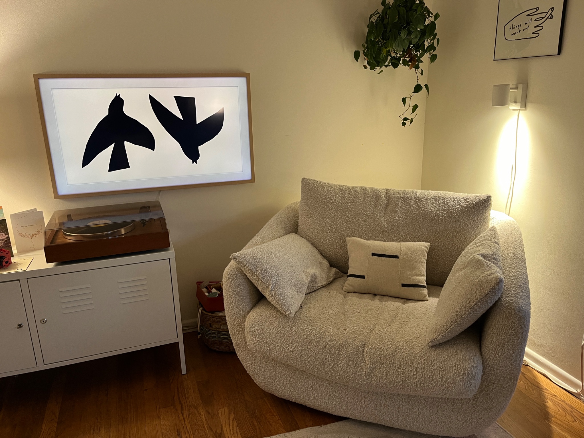

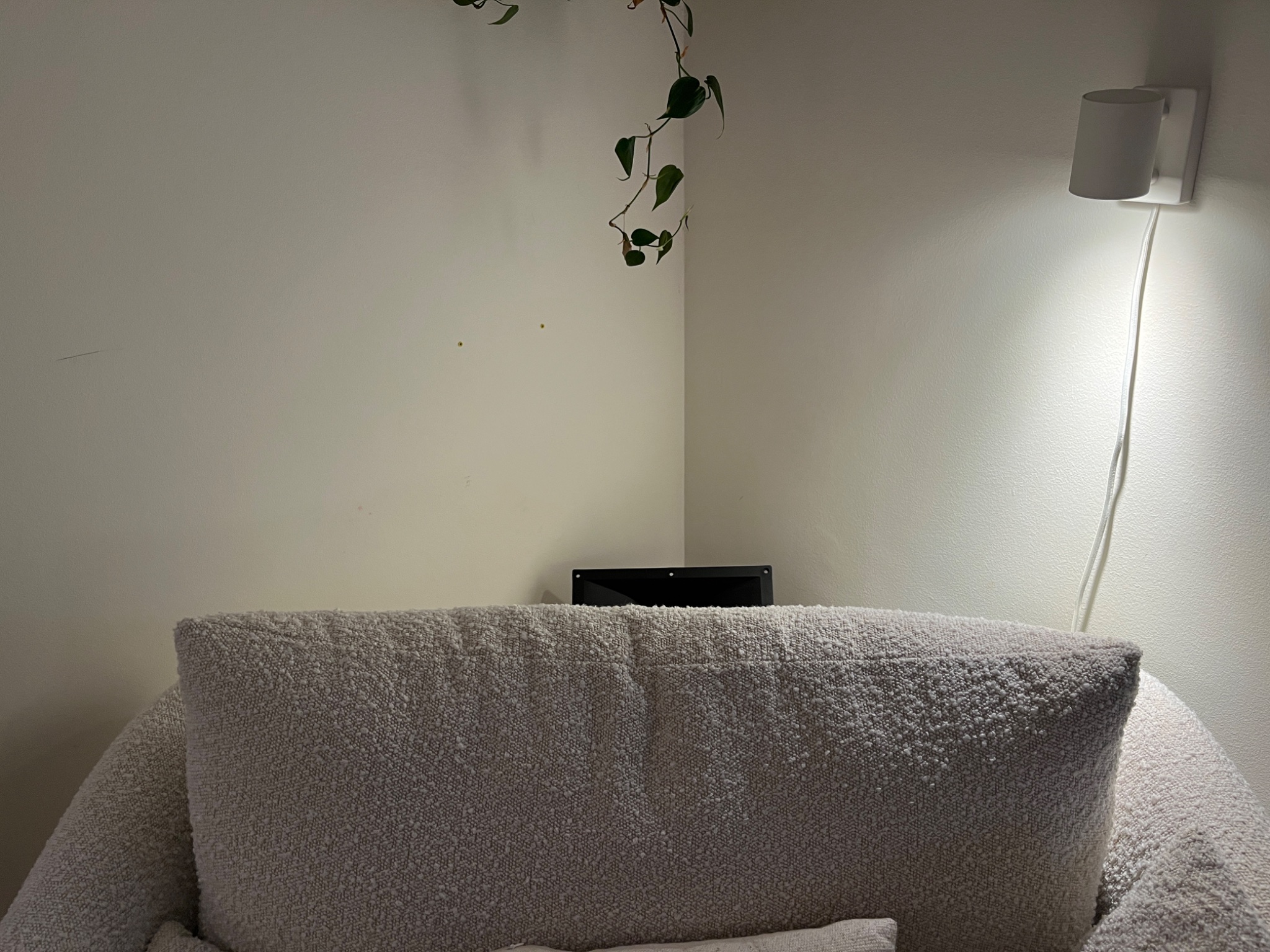

It’s all tucked behind a chair and completely out of sight. But the sound is really great! I enjoy it more than the Pluto. Being in the corner with the angled horn makes for a super tall soundstage that fills the room and is very even as you walk around. I’ve been so happy with the sound I’ve not felt the need to try a 3-way setup.

Dont understand the corner issue since the chair is 20x larger than almost any speaker made.
Guess wives like to be difficult for basically no reason.
Unless she spins in circles violently in the corner and needs her space.
The negative space created by the angled chair leaves plenty of room for a wedge enclosure.
Even a floor to ceiling baffle.
Otherwise a white speaker with white grill would look fine I think.
Far as the aesthetic issue, joking aside likely the real reason.
Corner loaded bass is rather pleasing and be nice to get the mids/treble at ear level.
