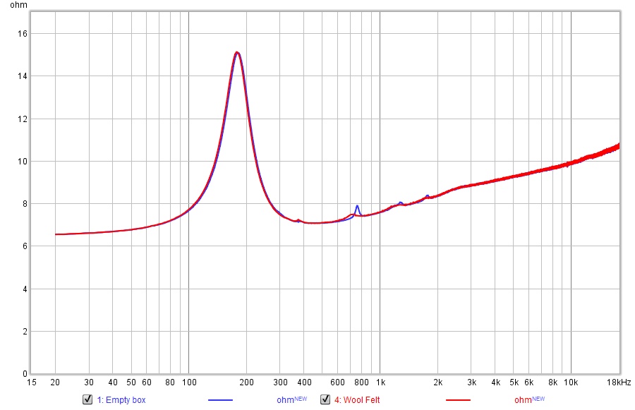

Here's what adding just one layer of 5 to 7 mm (!) thickness of wool felt on the inside walls does, nothing more added at this time:
I really find your work inspiring, and i do consider using some of your findings for my project. Am i to understand that the entire box is filled with sandwich layers of glass wool and wool felt sheets? or do you leave some free air to avoid overstuffing?
Also what would be the main thing that seem to give glass wool the advantage over polyester feltsheets? from what i can find then it seems like the poly sheets have a higher density than standard glass wool of 16kg/m3 vs 60kg/m3 for polyester.
I was looking for other properties than you are for my line arrays. I wanted to bring down the impedance peak in frequency and wanted to use the driver over the full audio spectrum.
The line array enclosure was filled with wool felt on all walls, about an inch of free space behind the magnets of the drivers and wool felt to close off the fiberglass fill underneath.
This use of materials did get the impedance peak lower in frequency so my goal was met. Fiberglass isolation materials are an excellent all rounder in my experience. Working well at all frequencies we humans hear. The combination with wool felt works wonders to remove all traces of wiggles in the impedance curve. Even when a magnified look on the impedance curve is used.
The sub enclosure is filled with wool felt in between the fiberglass, everywhere where a hard surface would follow (like a brace for instance). As that's where it does a real fine job.

I've used old pillows with polyfill! I believe that material mass, placement and density are more important than fibre type.
I'd say that depends on what your goal is. They do act different across the frequency spectrum. I believe loose thin fibers isn't a bad thing depending on your goals. Colakurt has two different enclosures to damp, this might mean a need for different materials as well. Anyway, I let the impedance curve tell me the story, highly recommended.
It isn't that hard to measure impedance this with a suitable sense resistor, a couple of old audio wires and the free software package REW. More here: Impedance Measurement
I keep an old laptop around specifically for that duty, I don't want to risk blowing up the soundcard in my Audio PC. Of course a DATS would work too.
