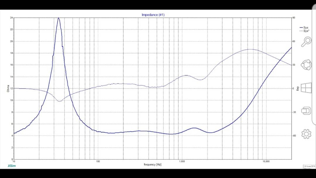

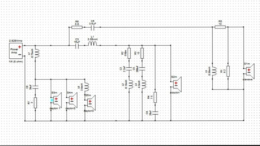

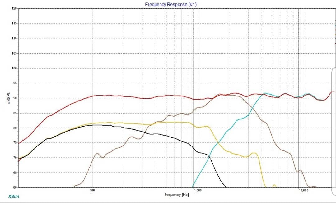

Normally have outside help with crossovers but now want to try to get to grips with xsim. Does it look a mess?
Having some trouble with woofer low pass. Also dont know how to add the baffle details
Drivers are viawave GRT145, accuton c90-6-724, dayton es180ti-8 (x 3)
If possible I wd like to go for a type of open baffle on mid, but with wadding to soak up most of back wave. Guessing I wd get a small increase in SPL, maybe 1.5 dB, which I've added. Also wd like to low pass the lower woofer earlier.
