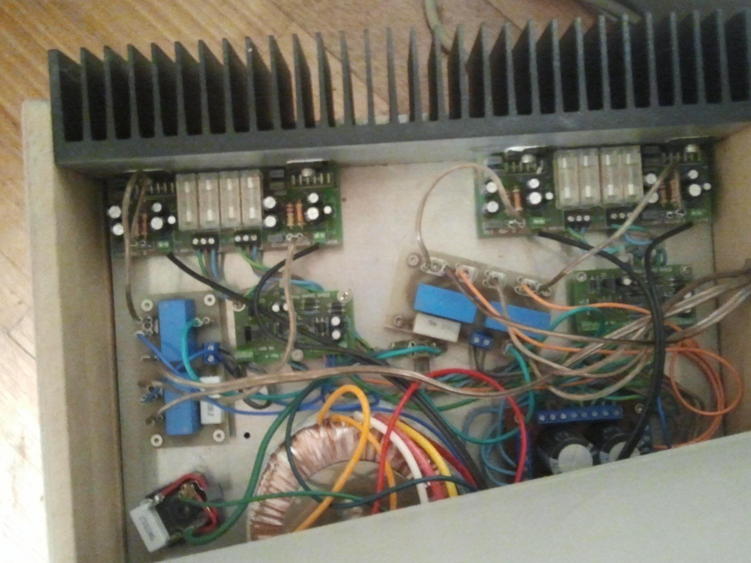

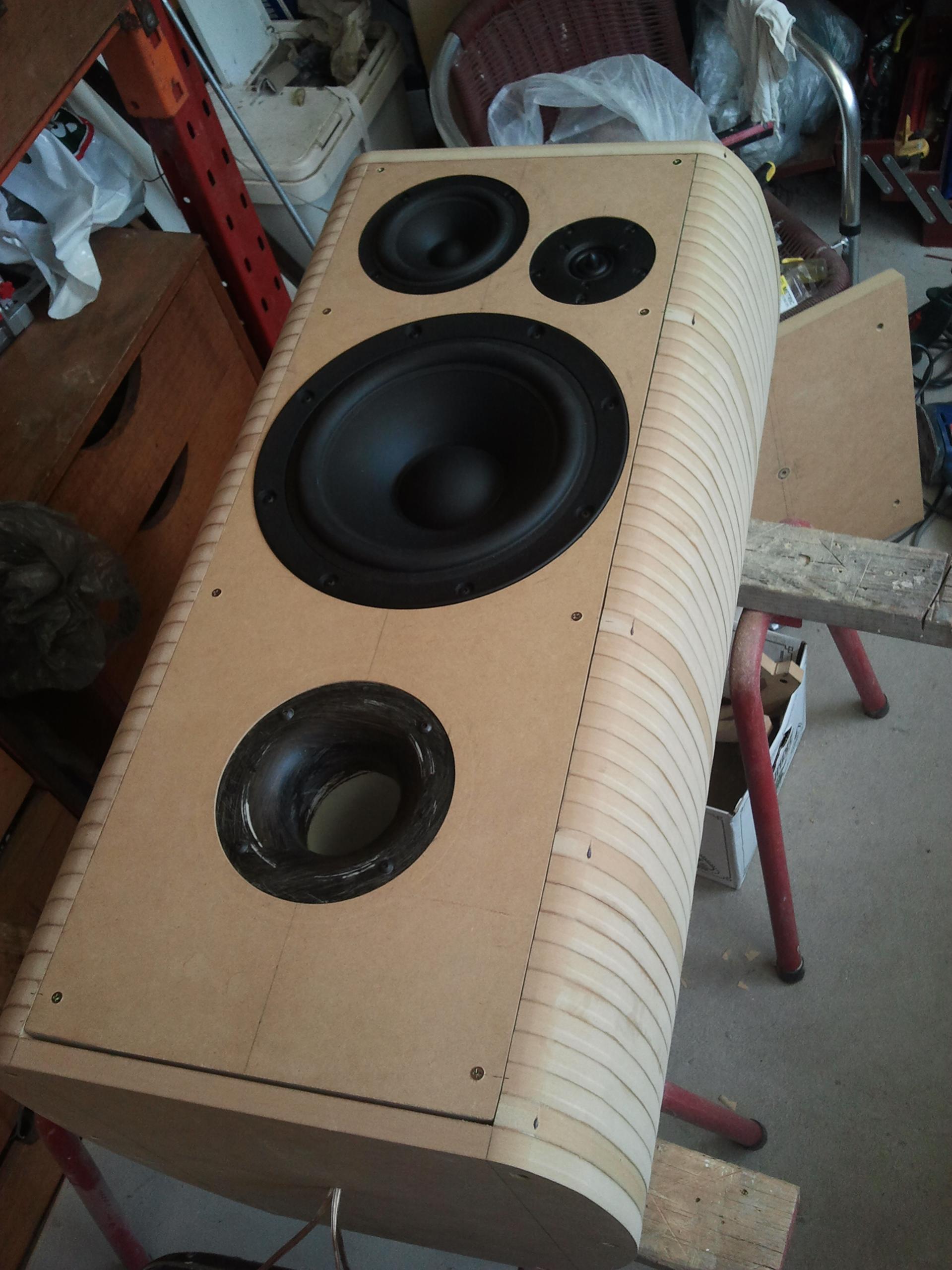

Hi Kev, I house the amps in the bottom of the boxes on a sheet of 3 mm aluminium, on which the heat sink is mounted too. The whole assembly slides out for easy access, and it is out of the way (ie, not tripped over). Second image is the latest build.
Abs

That looks like a good idea, Abs!
Yeah, if I'm going to have the amps right out by the speakers anyway it would save on an extra box and 6-way speaker cables. I'd just need to make sure (like you have done) that its easy to get to to the electronics.
EDIT: having done some measurements, my heat-sink is only about 2" wider than my 10" bass drivers, so its not going to make the cabinet much wider than absolutely necessary, and I hadn't been thinking of a narrow baffle in any case.
