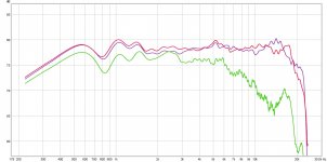

Off axis
Set up: 80dB, mic at 1 meter, indoor, gated
Purple: on axis
Red: 15 deg
Green: 60 deg
Do you think it’s ok?

You seem to have gotten a flat on-axis response. That's good.
thanks!
What does the off-axis response look like out to 60 degrees horizontally and +/-30 degrees vertically?
I did just the 15 deg and 60 deg horizontally so far, as per my post: is better if I validate the +/- 30 deg vertically as well?
Ralf,
What is the gate? I suspect it is not long enough to have valuable info in the W-M crossover region
It's 5.5ms, good for a 154Hz frequency resolution based on REW. This window is applied only to the "Outdoor" response, inside it's 2.5ms (286Hz resolution)

Strange that SB declared it flat on axis until ~25k…
Do you think is important to fix it, since it’s a couple of dB on a very high frequency?
Do you mean B&W? If yes I understand what you mean. I get the impression on what you are saying when I tried the 4th order XO. About the “body”, it was "thin" in the testing position: before doing any changes, I put the speaker on the floor, in a potential listening position, and the floor reflection change it very much, filling what I think wasn’t there before. I’ve reduced the LF EQ by 1dB (to the 4dB gain now) because they became too prominent. Anyway, this is a subjective opinion not confirmed by any measurements.Personally I go for a falling response, a-la B&K or thereabouts. I think perfectly flat seems very bright and thin, but regardless that tweeter hump could be pretty wearing on the ear.

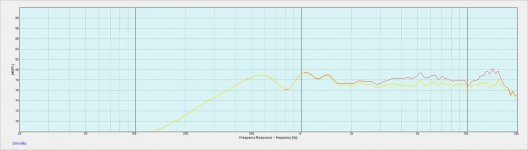

below the EQ and normal (amber)
whatching it now looks like better without EQ... I was trying to limit that 17k -6dB...
I had the same idea at the beginning but ended up to do a "neutral" system and then tune it in the listening position. I think I have the tools (REW + MiniDSP + UMIK1) to do that
Since I have only made 2-way monitors, I measure in place, and design the crossover accordingly. Makes my life a lot easier. Hard to do with 3-way monitors and crossover points below 500 Hz though. On the other hand, I am not quite sure how flat in measurement translates to the EQ that I would want. I'm sure I'll get to reading about that eventually.

Try this.
Use 2 PEQ's. First, centered at 5kHz. Cut 1.5 dB. Adjust width until 3kHz to 9 kHz range is equal to 2 kHz. This is a very broad filter which should leave the top octave resonance sticking out like a sore thumb. Second PEQ about 13kHz, cut 2 dB. Make this one much narrower.

So I tried this in OmniMic. It works pretty well. From 2kHz to about 18kHz it brings the spread down from about 4 dB to 2 dB. Below 2kHz you can EQ or rely on a high pass filter to take care of the remaining hump for you.
F1 = 5kHz, Q=0.9, -1.5 dB
F2 = 14 kHz, Q=2.6, -2.9 dB

thanks for spend time on this issue. What I like is your approach, that is "lowering" instead of "gaining". I will use for other smaller issues that I have!
Still, I think you may benefit more from cuts than boosts. Try out similar ideas, or add the two suggestions I made to your EQ'd version.
Dissi,
thanks for the link
Independent measurements of the SB26ADC-C000-4 from HOBBY HiFi and Audio Gurman (http://www.audiogurman.com/images/SBacoustics/SB26ADC/SB26ADC_0.jpg) confirm a very flat response up to 17 kHz. What you see is more likely the response of your own measurement chain (microphone and amplifier) which seems to roll-off with a hump at 15 kHz. Of course it doesn't make sense to equalize that.
after your post, I did some investigation and you are right, this could be the mic roll off, even if they provide the calibration file... I will remove all the EQ on the tweeter
thanks!
cheers
