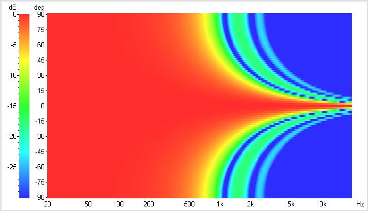

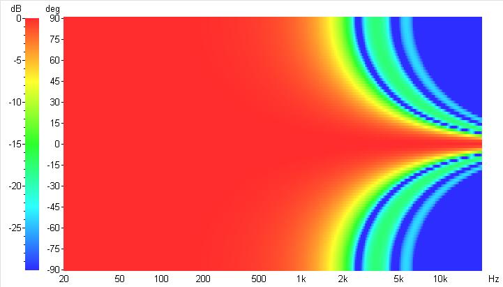

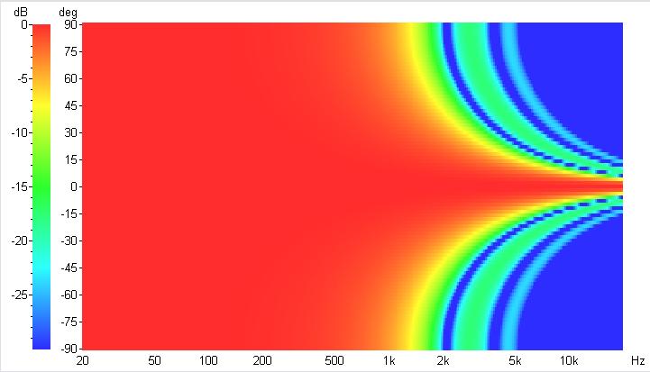

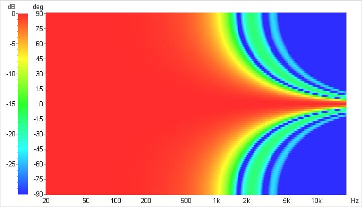

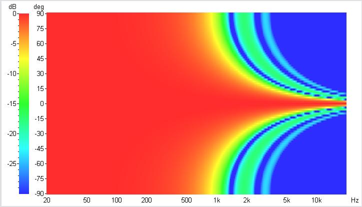

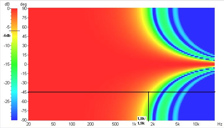

I will post you simulation of directivity behavior of different size of driver as polar map latter this day ( those are located on an other computer). But yes this is very important key to success.

Ok, kids are in bed so i've got a bit more spare time.
Polar map here we go!
I don't know if you are familiar with this so don't take offense if you already know how to read this! If not what follow will be of great
help!
In the far left you've got a colour scale which represent level.
We are interested in the orange colour as this corespond to -6db area and this is by convention the point given as reference for directivity.
(eg:90° covering means that we have a device which will be -6db down at +/- 45° angle each side of listening axis (0°)).
about the graph: in the midlle of the vertical axys you've got 0°= listening axis.
In the horizontal axys you've got frequency.
The colour corespond to level (= the scale at the far left).
So let's say you want to know at which frequency an 8" driver have an angular coverage of 90°: you draw an horizontal line at 45° (either side for a direct radiating driver this doesn't matter in that case) and you search the place where it turns orange.
Once done you draw a vertical line (you can use paint if under Windows) and read the frequency at which it happen.
So from the '8" example file' you can see it happen around 1,8/1,9khz.
Keep in mind these are approximation (it is dependent from SD) but it is close enough to have an idea of where it will happen.
You've got 6,5", 8", 10", 12", 15" to check their behavior.
Now the fun part will be to find an horn which have the same behavior at the same frequency that the driver sizeyou want to use.
ALMOST simple as that ( the important word is ALMOST because there is other things to check... ).
