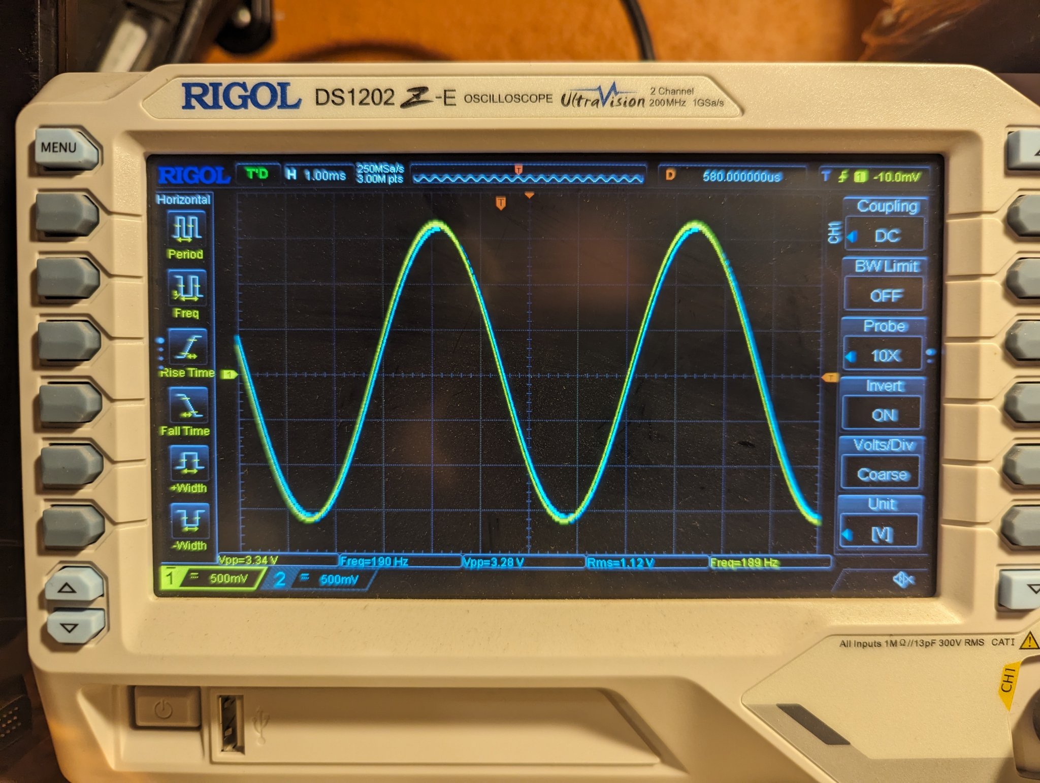

Phase shift doesn't imply time travel... 90 degree advance is the same as 270 degree retardation, no implication of a time shift at all. You look at the step response or impulse response when thinking time domain, not phase shift at a single frequency. The plot of phase delay against frequency is also useful here.
In principle you need to include an all-pass section in a three-way Linkwitz-Riley filter, see https://www.diyaudio.com/community/...-crossover-please-comment.394499/post-7235230 For 12 dB/octave, it should be a simple first-order all-pass.

Gentlemen...
So tonight I spent some time and decided to scope it out a bit more.
Before I begin, let me just say... I am not a professional and am still learning my way around the scope.
Here is what I have done:
1) Connected the xover circuit and fed it a 190hz signal (the xover point of the low-to-mid/high section).
2) Connected one channel of the scope to the low-pass out
3) Connected the other channel to the mid band-pass out
4) Inverted the low-pass channel from the scope
Here is what it looks like:
So yeah - there IS a bit of a lag on the low-pass -vs- the mid band-pass.
But that does not look 90 degrees out-of-phase to me.
My initial thoughts here are: that does not look THAT bad and there is likely going to be MORE phase-alignment errors in the speaker VC-spacing than what I see here, no?
The high-pass section is around 3900 - is this the ratio which is mentioned previously? 190-to-3900?
Seems like I may not need to worry about building an all-pass, no?
-Dean
