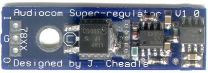

Fred, Audiocom's regulator is pure Sulzer regulator, LM336 2.5 volts, OPA27 and the opamp is feed from the unstablized side.
Nice piece of engineering altough the cap at the top isn't soldered!
The pcb has groundplane which is connected to "in".

Re: Re: Who's design
I used one to power an XO. Totally useless, spews out harmonics like a sick man. With a resistive load, all is sweetness.
:smash:
spews out harmonics?
Sounds like instability to me. Does this thing have any Elko (electrolytic) bypass caps on the board. Ones on the main PCB are going to be too far away. Anyone who plans on building a three terminal regulator replacement board had better try stay close to the foot print of a TO220 device. These things seen to be stuck pretty close to their filter caps and even each other. A big PCB (relative to the size of TO220 package is not going to fit in many if not most products. I would go SMT for everything but the elko filter caps. These I would mount on the other side of the board, using radial caps but laying them down flat against the PCB and securing them with a small dab of RTV (Silicone sealer) This circuit could be done if the preregulator circuit is not used, but is still a daunting task for a good layout with a small footprint and component height. Just because the Audiocom is not a good design, I wouldn't rule out a drop in board for TO220 device replacement. It can be done. In absolute seriousness, I think this would be a good project and be extremely useful for updating equipment with tight real estate requirements around the Three terminal regulators. If anyone is interested (yes you too P-A) I will be happy to offer further advice.
Boss.... da plane, da plane!
"The pcb has groundplane which is connected to "in" - P-A/:no:
I am pretty certain that is not a groundplane ( its not connected to ground for one thing) The pass transistor is SMT and the surface area of the "plane" is connected to the collector: It is a heat sink using the
PCB "plane" area. :hot:
Go read some ap notes for SMT power transistors and this trick is explained in more detail. The Zetex website has some good info on this I believe, since I saw some stuff on this in one of their data books. Maybe it doesn't get warm enough in Sweden to worry about this, but it sure does in Texas!:nod:
Later,
Tatoo
Fred, the IN-pin is connected to the backside (plane) which is connected to the collector which is connected through 15 vias. The power plane has only one trace. It's the power to the reference from the real output. Otherwise it's a whole power plane which, Fred I know, serves as a heatsink. Fred, I won't have to read books for seeing this.... I'm using my eyes only, because I'm holding the regultor in my hand.
About decoupling caps: How many do you see? Correct not too much. It's the one which unsoldered at the picture. The GND trace is a thin (15 mil!) trace along the sides of the pcb.
I can imagine that this regulator is not very well suited for difficult loads.
