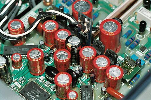

"Its only 1.75" wide by 1.5" tall. I don't think thats very big.
I blew up the layout for readability.
Thanks for your comments,
Craig Beiferman"
ummmmm...... How high do the components stand off the board?
Pretty tight fit for even brand X
Yes Peranders I do have further information on the regulators pictured. Why give them free advertising here?
Meeeyowwww!
Wow someone spent a bomb on those BGNs.
What is the rationale for using BGNs and not the lower tan delta FKs or SG OSCONs in the digital section? The OSCONs are much smaller and by selection one can find batches that are an order of magnitude better than the BGNs. I understand SOUND was the criteria.
Also in the resistors used in the same mod by Audiocom, two chip Vishays have been selected for sonics. I would prefer the single chip S102Ks. The former are of course, even more expensive than the single chip one.
Retailing expertise??
