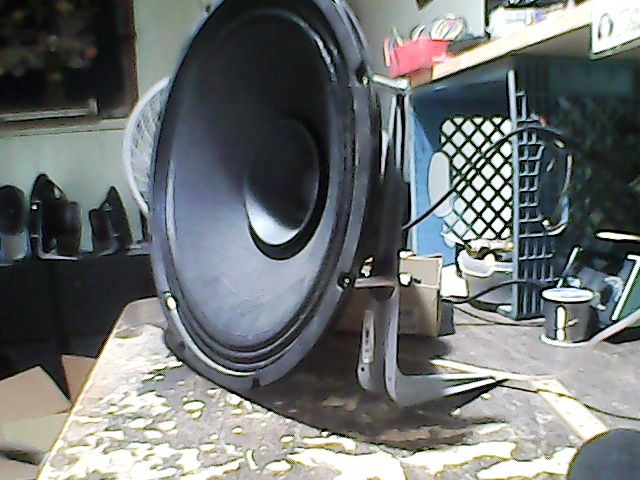

With a lot of EQ , these sound pretty good .
Not nearly as clear as the sealed 6.5 " ,
but with the ( whatever it is ) that an open
baffle gives . I am still working on 2 aspects :
Better looking brackets ( stands ) and a
passive EQ circuit other than line level .
