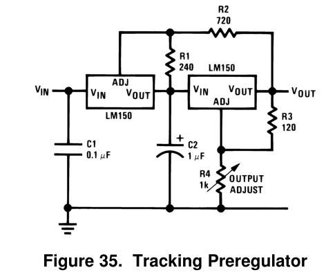

Here's the basis of the idea for my reg - the left hand LM350 here is a tracking pre-regulator. Instead of another LM350 for the right hand device I'm using the MJE15034 fed from an RC filtered array of TL431s (seeing as they're cheap, even an array is cheaper than a single low-noise ref). I also have a TL431 (set to 2.5V) in place of the 720 ohm resistor fixing the headroom of the output device.
This reg I've designed to feed my very large cap banks so it needs not to blow up when driving into a short circuit for a few seconds or more.
If you're still interested I'll put the schematic for this reg into easyEDA (EasyEDA - Web-Based EDA, schematic capture, spice circuit simulation and PCB layout Online) and eventually I'll get around to making a PCB.Seems I need like many to find a drawning soft for pcb !Everybody make its own nowadays... The level of diyers increase... unluckily my knowledge stays close to the one learned at Midle-Age !

Is it less noisy than your last force & shunt TL431 ? How is the impedance range before your babel caps tower (I mean right at the output of your reg ) ?

The TL431 shunt by itself is fairly noisy - I recall a measurement published on DIYA which showed about 20uV for a TL431. But more than this I have a suspicioin that being a feedback shunt it contributes more noise when fed with noise from the load. Hence I've gone away from active shunts in favour of shed loads of paralleled caps.
I agree my new regulator is considerably more bulky than just a single TO220 so probably can't be a physical replacement for a single 3pin reg. It does though deliver low noise for little buck. Its considerably lower noise than a TL431 as it uses multiple paralleled shunts - giving almost 10dB noise reduction, also it filters the noise from the array with a sub-10Hz corner freq.
