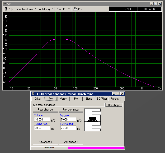

Your picture is of a sort of quasai 6th order band pass, with a neat separate baffle loading idea (push pull or whatever it's called that should cancel out box vibration and give the drivers an effectively more rigid platform to work from). I would suggest turning the drivers around so they have their magnets pointed at eachother inside the center chamber, and installing a brace between the magnets of the 2 drivers (careful not to block a vented pole).
The idea of having the 2 outer boxes tuned differently whilst the drivers share a common loading on the the center box is something that I would not suggest dabling in. I'm not even sure if simulation software exists that wold support such a configuration.

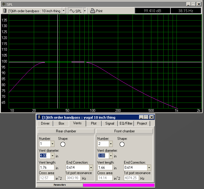

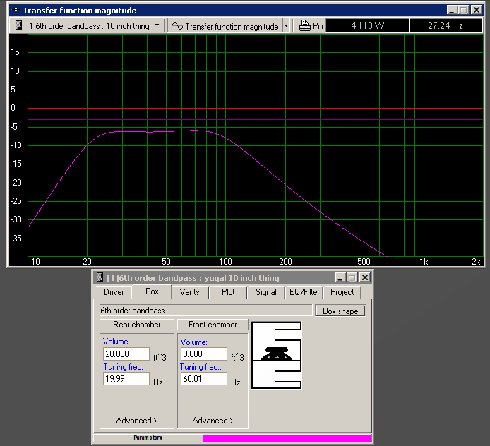

Here's a hypothetical 6th order band pass box based on 2 of the drivers you have there....
As you can see, yes, you can tune to 20hz, 20ft^3 on the rear chamber is what it takes to make a 20hz tuning sort of practical/worthwhile for this box type.
As you can see, the design takes a hit on efficiency across the listening range (-6dB) but, if the driver characteristics are correct, the bass region can be produced relatively flat from 20-100hz with the box volumes and tuning shown.

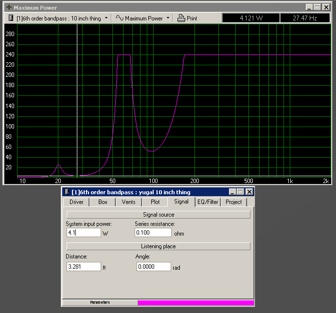

Unfortunately, The Xmax limitation comes in with a vengeance at this point. Xmax limited to about 2W per driver, or about 4.1W total. (see sim).

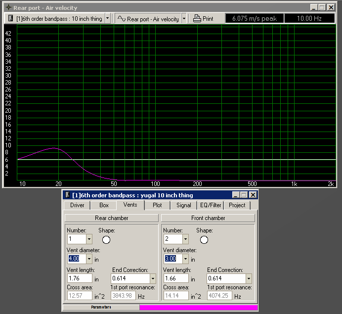

If you simulate the ports with 4W of input, the port dimensions and air velocity are easy to make an acceptably quiet. (see sim)
At 4W, the system is theoretically good for ~100dB across the bass listening range. Nothing fantastic, but, not terrible either.
The odds of this simulation matching reality with those drivers; probably pretty poor.
The final chart on the right there, assumes no use below ~35hz, a still large but more practical box size, and an Xmax limited Pe of 13W instead of just 4W, the combined improvements in efficiency (+6dB) and Pe result in a full 10dB improvement in output capability.
