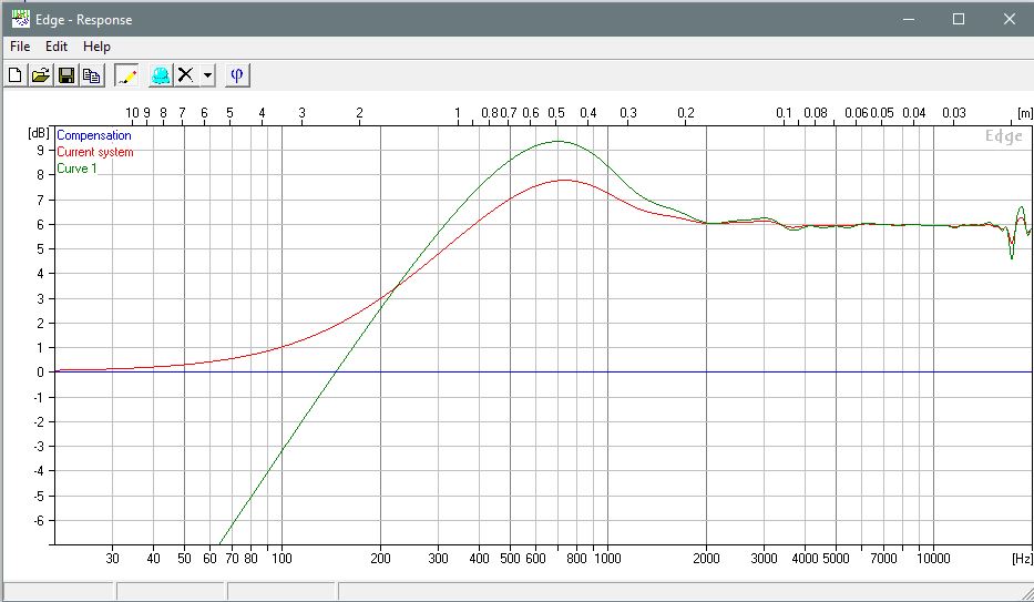

The bigger issue going open back with a 2-way is that you are going to lose LF extension. And not just a little. Attached shows the diffraction effects of a front baffle of your dimensions, one with a back baffle (red) and one without (green). You are losing everything below about 300Hz at a significant rate with the back open.
