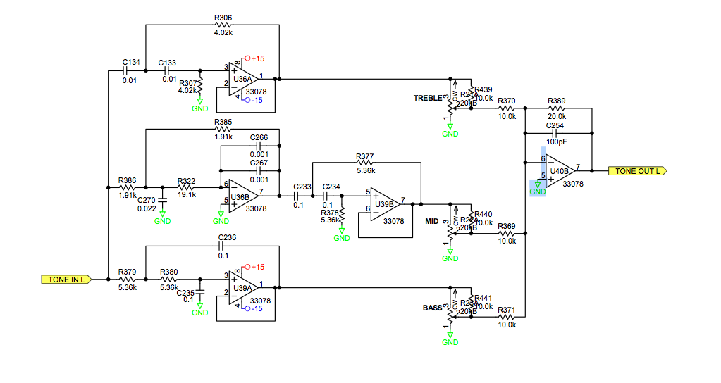

Hi I want to use this circuit after my phono preamp but I was wondering would swapping the smd resistors to a more conventional number have any ill effect. For example swapping the 4.02k resistor to 4k the same goes for 1.91k, 5.36k 19.1k any suggestions ?
Resistors and all parts have some tolerances, for instance 5% or 10%.So this means that they are never the same value and any resistor is slightly different.I also have never seen a 4.02k resistor.This is not normal resistor wich you can buy.
Those are all standard 1% values.
Resistor Values E6 E12 E24 E48 E96 E192
You can buy them at DigiKey and Mouser and likely Farnell (and many others). I used to use E96 values exclusively at a former job.
G²
4k and 4,02k are pretty much the same.I would not care about the exact values and replace them with the next best.
This resistors set the gain of the op-amps and have no impact on tone.
These are filters that need fairly accurate resistor (1%) and capacitor (2-5%) tolerance values. You could simulate them with free software like TI's FilerPro or LT's FilterLab and see what the effects are on changing parts values. E

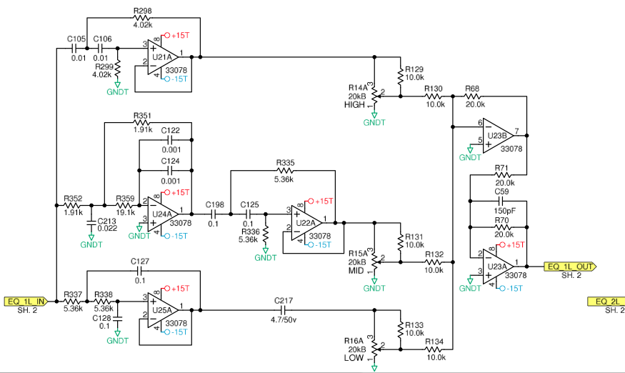

Thanks for all the help guys, I have got just one more quick question. I have fount another version of this eq with another opamp on the output and would like to no what it does and if its necessary thanks.
Look at the circuit:
High and low filters go through a non-inverting amp, are summed at U23B, inverting amp U23B and inverted again in U23A. Good!
Mids go through inverter U24A and come out inverted after U23A
Good, bad? Build it, you judge. E
Thanks for the help guys, just another quick question. I have fount another version of this EQ with a extra opamp on the output and would like to know what it does and if its necessary thanks.
It adds a phase inversion but as MickeyMoose pointed out the mid has an inversion that the other two do not have. Does this EQ have a 'flat' position? It would seem that if the slopes between mid / low and mid / high don't match exactly it will never have a 'flat' mode. It seems to be the oddest EQ configuration I've ever seen. Have you looked into parametric equalizers or even plain old graphics?
