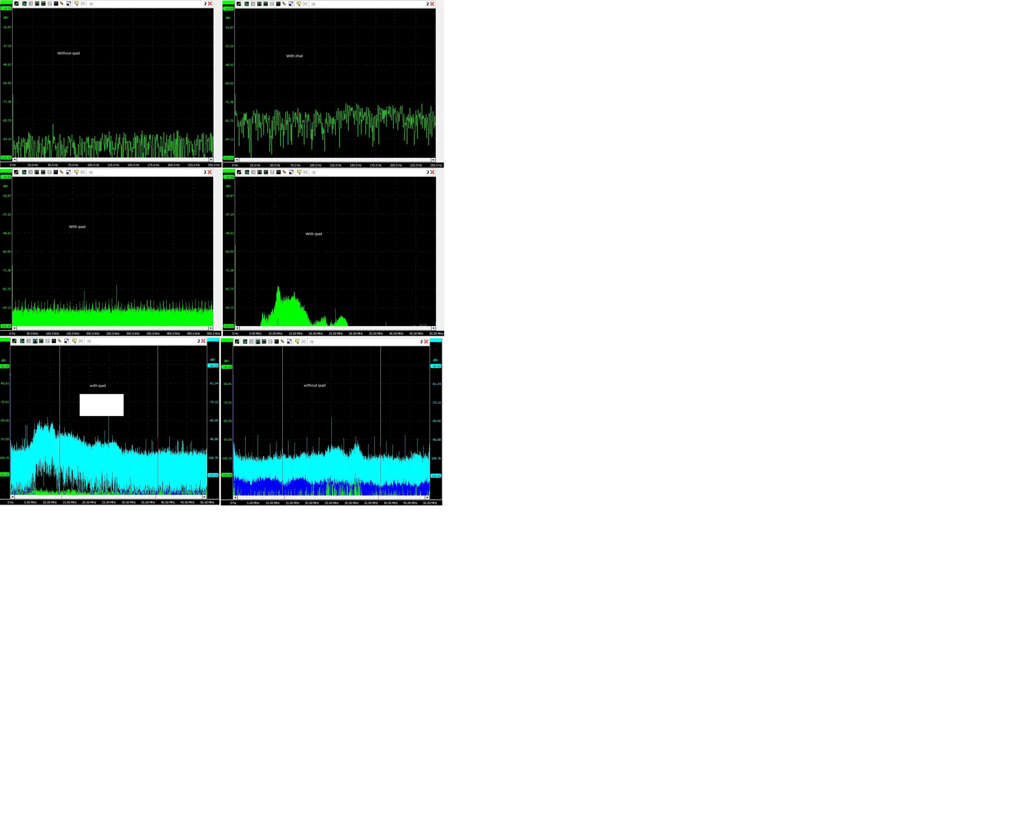

The cable was to be designed for ipad.
Here is an output of a lowest of lowend hifi cable connected to an ipad. Looked at with a 100Mhz oscilloscope.
The ipad sends a lot of HF noise, that is stronger than the cable HF pickup noise.
And that noise is is not strong enough to make any degradation of the sound or couple into the amp at any degree more than normal noise sources in the amp itself. This is just at my workbench result so take it as is.
Can we assume that the ipad output is actually a tiny (and probably filterless) Class D amp for driving headphones? If so, worrying about cable quality is a complete waste of time. Any old rubbish cable will do, as almost anything except the weirdest DIY design will pick up less RF than the ipad is already putting out. What is needed is a low pass filter, to keep all the ultrasonic stuff away from the amp input.
From other handheld designs I have seen and some of the IC solutions to save space the headphones are often a part of the filter, in fact I believe a thread a few months ago discussed something similar, try looking for filter less class D or similar.
