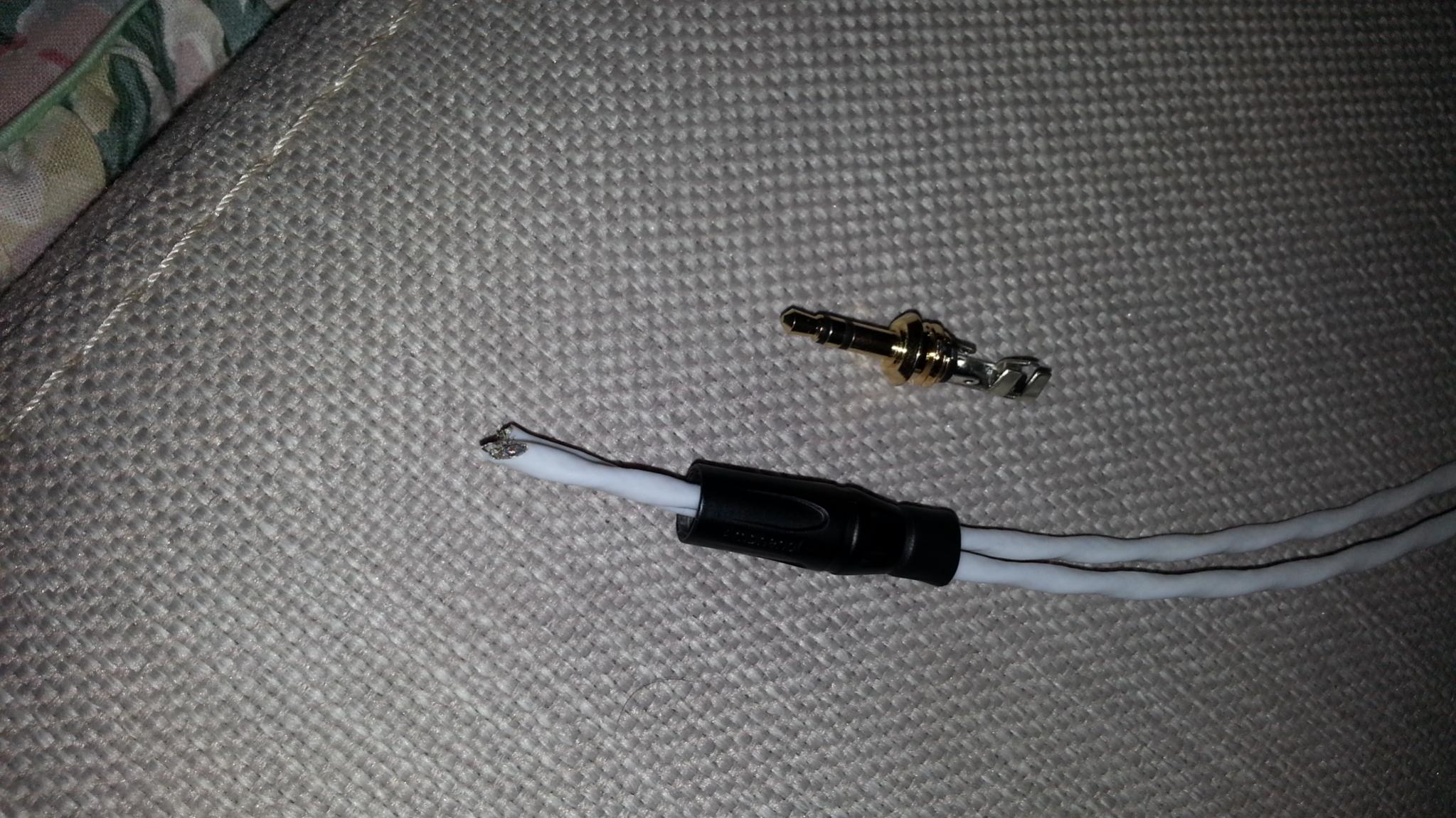

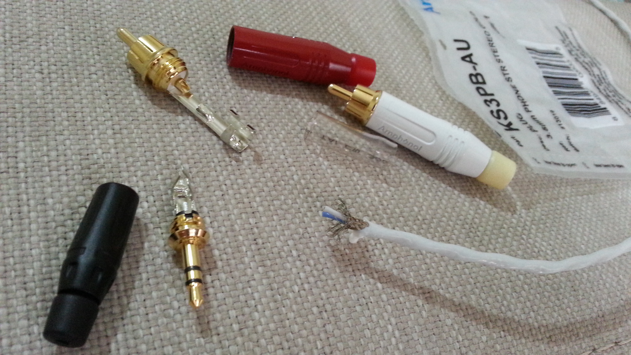

Hello.As i see there are different ways of making a RCA cable.I have many Teflon Cables and i want to build a 3.5mm to RCA cable for using with my ipad air(i already have a 3meters of Monster cable and i want to build a better sounding one) I am not sure how to build a good one with these parts.Could anyone help?
Should i connect shield wires to both white cable ends or only connect to 3.5mm side?Some people say connect to both end and someone tell to only one side?
And second question.Should i twist 2 cables too or leave them alone?
It looks like your cable is 2core+shield.
Use the 2cores to carry the signal (Signal Flow and Signal Return)
Use the shield to attenuate interference.
The shield must be connected to the source chassis.
But I suspect your source does not have a chassis, so next best is to connect the Shield to the Signal Return at the Source end.
Where you have a chassis connected shield and high interference especially at VHF, then you should also connect the shield to chassis at the receive end.
Sometimes this receive end connection to Chassis can be via a very low inductance capacitor.
Do NOT use the shield in parallel to the Signal Return !!!!!!!!!!!!!!

Ok i see.I want to give it a try.So i am connecting everything to 3.5mm plug and leave shield not connected to rca?rgrds
I would use co-ax for the job. A shield connected at one end is not a shield.... Its a piece of wire connected at one end, only audio seems to go for the one end connection of shields. At least use a cap at one end to give some RF shielding....

There are many copper cored twisted pairs and copper cored screened twisted pairs to choose from.
I would use cable with a outer jacket diameter that suits your nice plugs, then you get good physical cable termination.
Join the jack cable and RCA cables outside the jack plug for the same reason.
Termitate shield on jack only to avoid ground loops.
Radical suggestion : Terminate signal ground only on one RCA plug to avoid ground loop via right and left channel. Both channels has to be connected for cable to function.
Summed up: Avoid ground loops. Solid mechanical terminations.

As it is a stereo phone plug at the source/ipad side there is common ground there. So my radical suggestion is to mimic a cheap cable with left and right channel inside the ground shield, which is also the return signal / signal ground. It is that electrical connection without the signal bleed between the channels and signal ground through the shield.
I am not a big fan of coax myself at low frequency because of the unflexible cables and high risk of breaking the solid senter connector when bending the cable.
