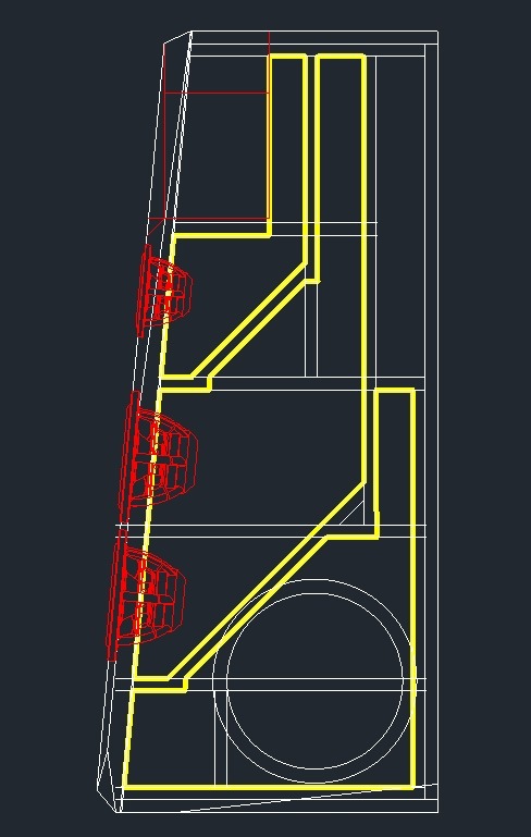

Below you will find pictures of concept design.
One is a classic box, and the other is a box with tweeter on top to have the option for sliding it forward and back for time alignment (not important as I have DSP..but it look's cool to me .
Front baffle is at 5* angle but tweeter is not angled.
At first I liked the option with tweeter on top, but leter I prefer a more classical design...will see....

Baffle wide is 220 mm.
What do you think ?

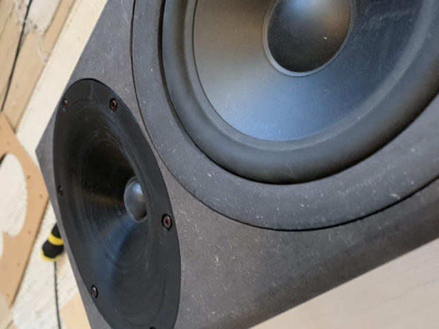

I know what you mean about defraction around tweeters but I see couple spekaer designs with ribon drivers where they use something like 45* round ower tweeters. Like small wave guide. Will try to make some test baffle and measure results.
Something like borresen
I have all the drivers and amplifiers so I'm not worried about the costs ...or it's too late for that

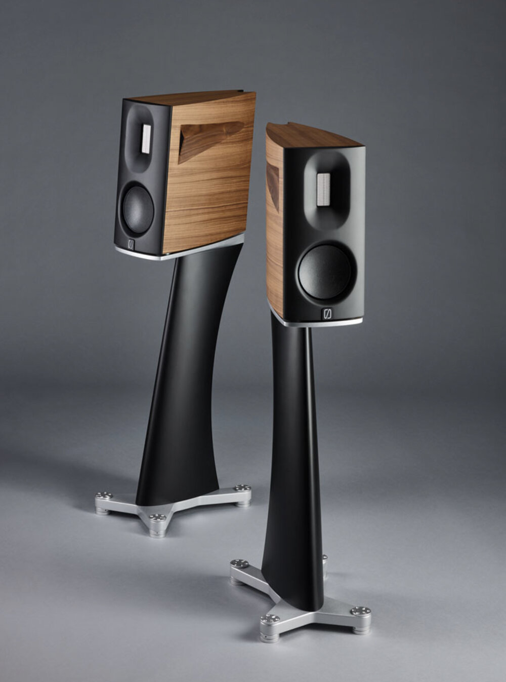

It is hit and miss to just make 45 angle throat/WG for the tweeter. Most likely not working well.
different with woofers. Many High costs speaker have drivers mounted from the back of the speaker. It is not only for good looks. Though tad difficult to implement with the satori drivers because of the non flat chassis.
I would think enclosure size is on the Small size. Yes you can do tricks with LT, but it is no free lounch. Ie higher Distortion. If it Sounds good you can test.
also with closed volume for midrange. Good Old advise is making it bigger than you need for improved midrange.
I don't know how those speakers are made... but it does not look like the rear panel is removable, in fact it does not look like there IS a rear panel.
So I would guess that the drivers are mounted to a flat baffle that is hidden, and then the highly profiled front baffle is laid on top, perhaps held in place with magnets.

Yes, enclosure is on the smaller size, as I have small apartment so I have to squeeze everything.
I can add some volume for midrange driver (13TX) to get like 5 litres. Don't know will more will have any advantage ?
And I was thinking that filling cabinets with damping material would increase volume that driver see. So I presume I will be good.
Someone from SBA advise me to use lover volume for 19TX to get more ''pronounce'' bass. Maybe I'm wrong.
Volume of 9-11 litres per driver would give me F3 of around 80Hz with a little higher Qtc , something like 0.8 if I'm not mistaken.
Apparently it is ok for bass drivers ?
And if I fill cabinet with damping material I will ''lower'' the Qtc to something like 0.7 or less any way ?
I have to say that I did have loudspeakers with Qtc of 0.5 and did not like it. (0.7 was better for my taste)
About LT on subwoofers, I think that higher distortion would not be that much a problem for bass notes from 20-80Hz ?
But I don't play music on high levels. Again I hope I'm on good side.
Whell the thing is, if I'm gonna with more volume my boxes are will become to big for my apartment .
Will play with baffle around tweeter to see what I will get.
Jea, I cant see it ether.
As Rokytheman mention, satori have non flat front chassis, so it will be a little problem to mount.
I would have to cnc the front and the back of baffle to make it work.
Don't know if magnets (neodymium) are strong enough to keep everything in place and prevent everything from resonating.
or to use rod bars from the back to front as Magico

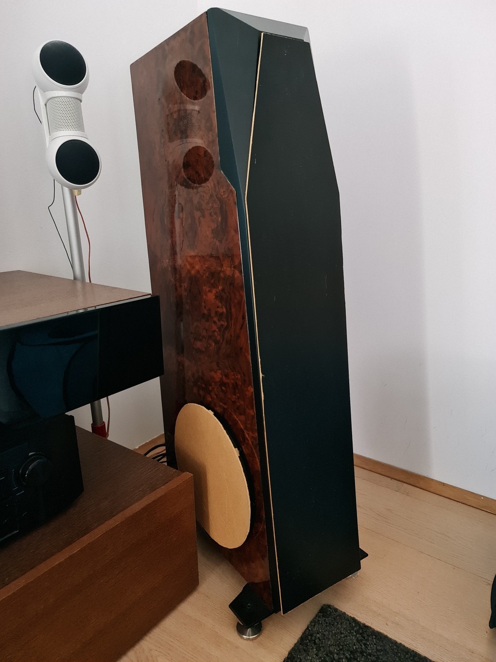

Go have a look at Magico speakers. Many of them should give you some ideas for double baffle applications, driver mounting and driver isolation techniques.
Jea, I see some of their solution with bars from the back to front, with damping material (light blue on the picture) in be twin ?
any idea what to use in place for light blue material ?

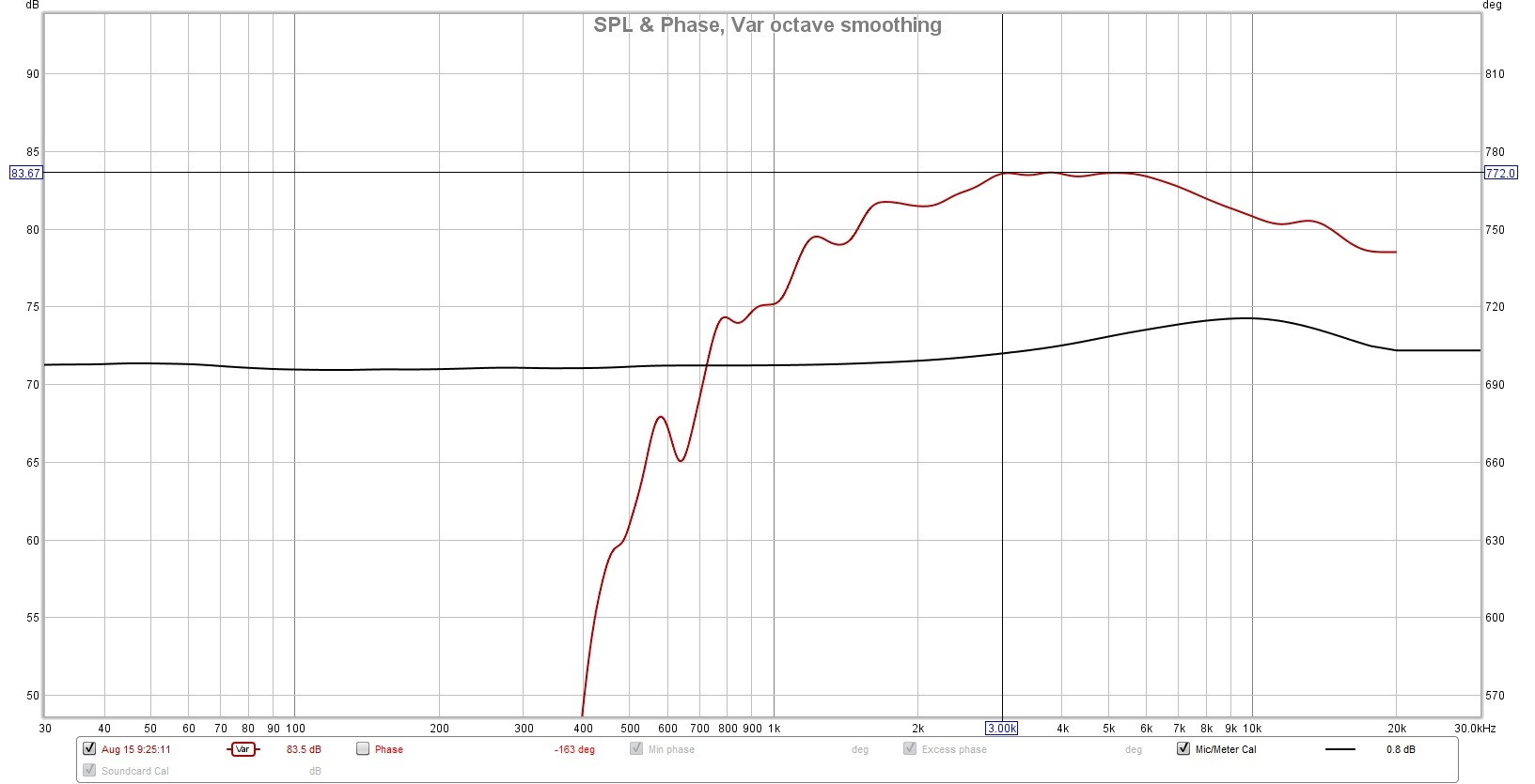

I have that RAAL 140-15D AM tweeter. In order to get it down to 1700Hz, I needed a 25cm deep horn:
They are for sale, btw. I made two identical horns for the Raal. €100 + shipping.
RAAL 140-15D AM in the wooden horns.
It was much better with a horn, but next time I will use a much smaller one and cross it muuch higher.
Right now I use the Faitalpro HF10AK which does go high enough but not as smooth:

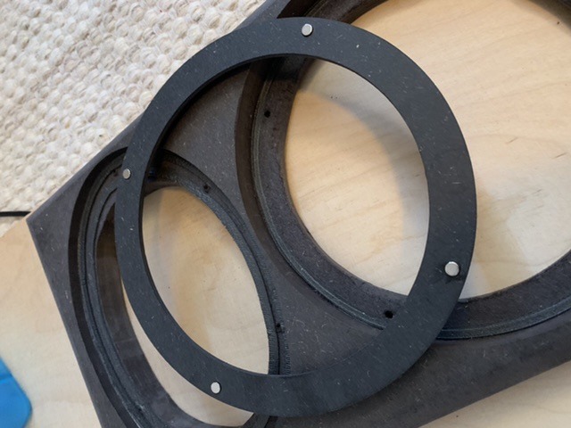

Wondering if Magico used blue gas can for that midrange…..
Different way of doing it, could be an adaptor ring? I made mine with neo magnets, then protruding screws. Took some time to cut, but I find it work well. I prefer to design my speakers with grill, because I think it improves aesthetics and also how I focus when listening to music. Critics would argue we have some extra diffractions and we have. But one could design grill so it is not that bad.

I have that RAAL 140-15D AM tweeter. In order to get it down to 1700Hz, I needed a 25cm deep horn: They are for sale, btw. I made two identical horns for the Raal. €100 + shipping.
Jea...that thing about DSP correction mide bi right
