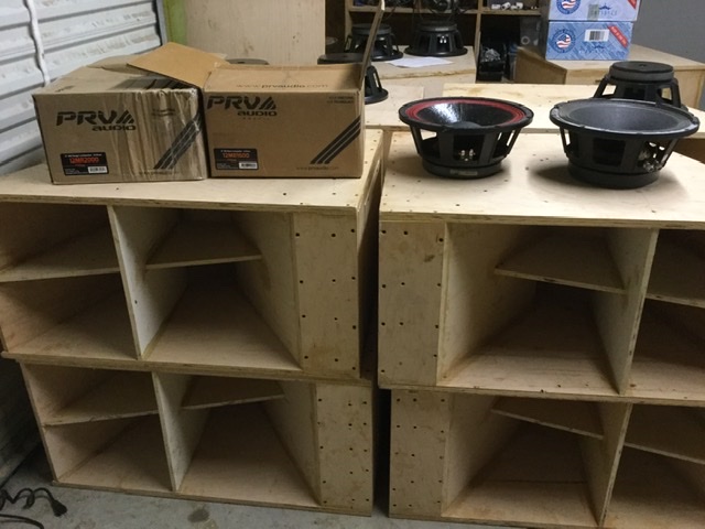

There seems to be a lot of proliferation of “PA” type drivers intended for the car audio market, especially out of Brazil, these days. Started with the Selenium brand, now multiple suppliers competing. Some of these drivers are excellent *for* PA uses. I was doing a shootout last year between PRV and Eminence - and the poor Eminences got STOMPED.
