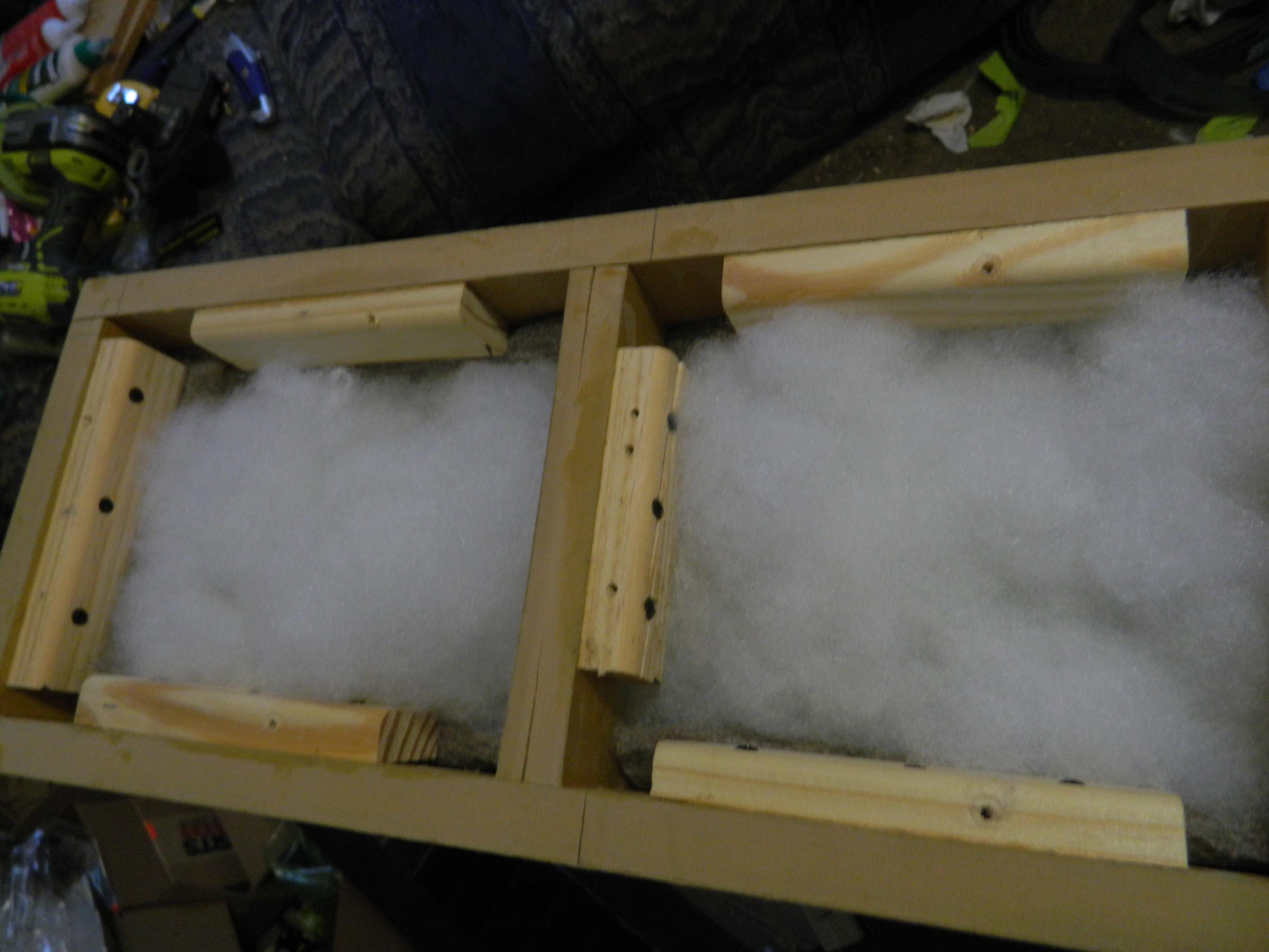

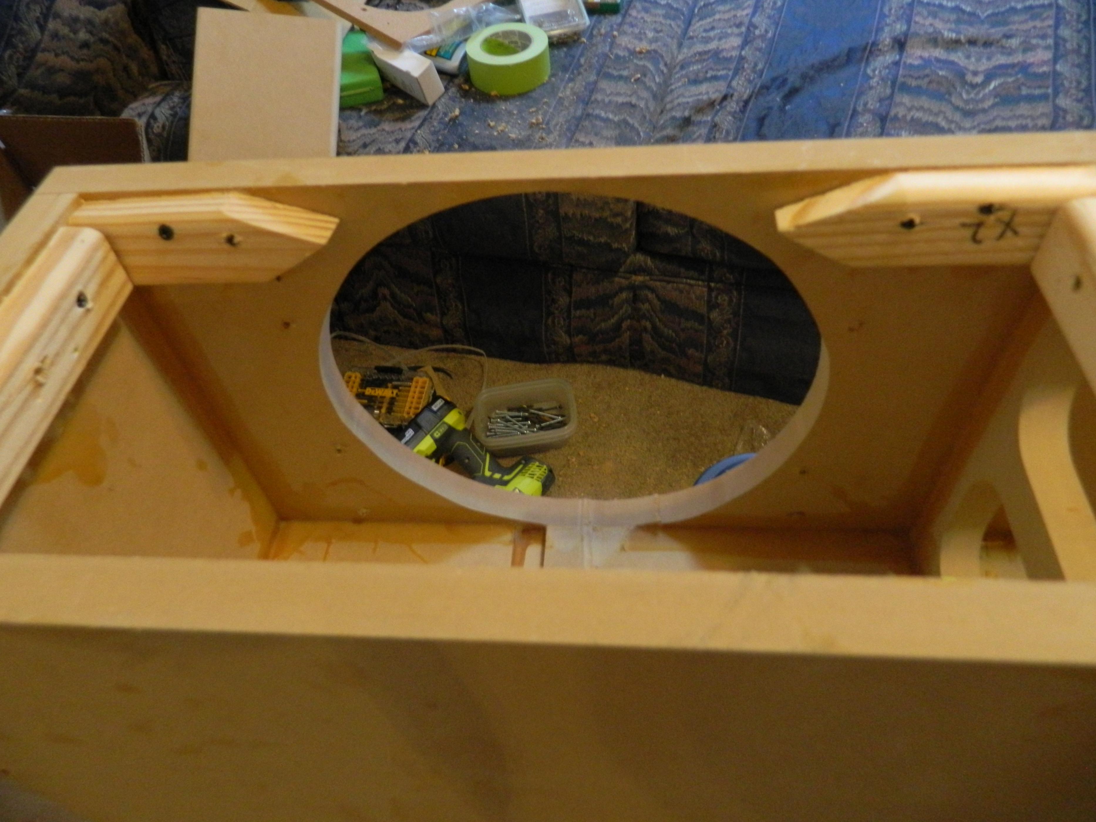

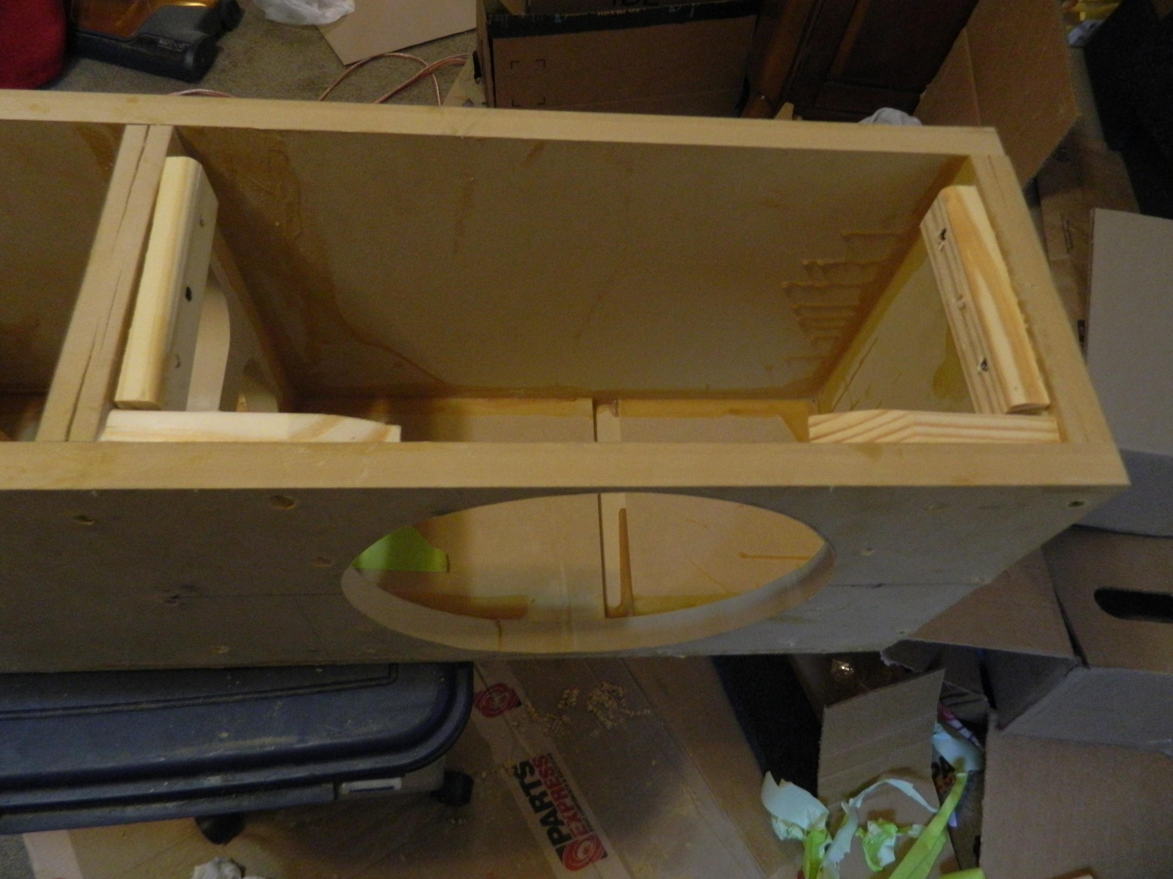

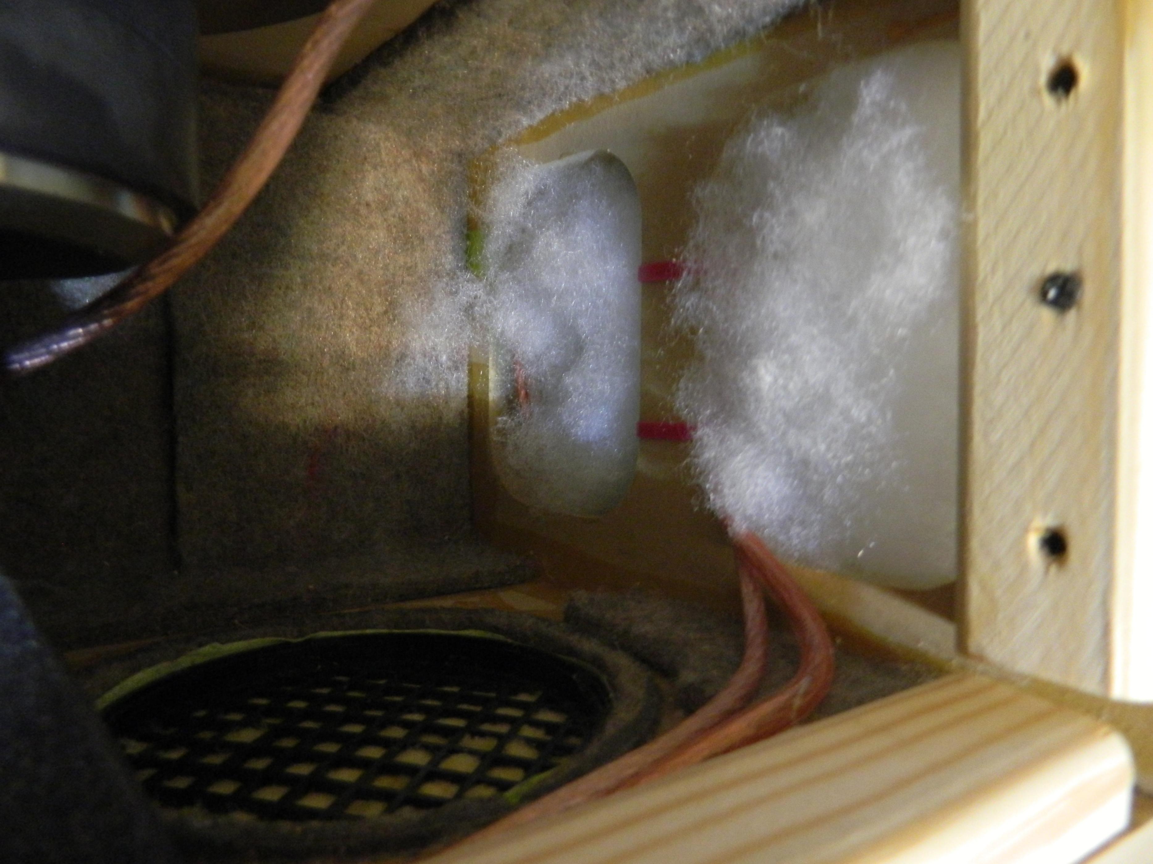

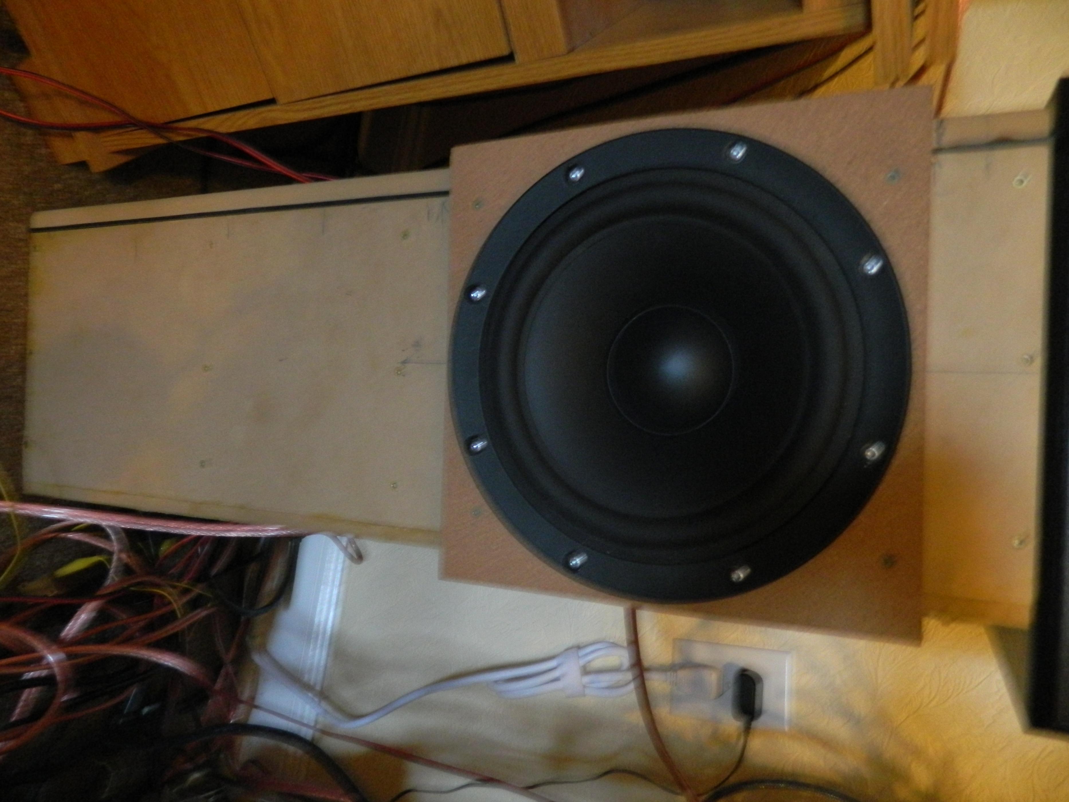

I will now try to add some photos. Still unfinished with the entire project.

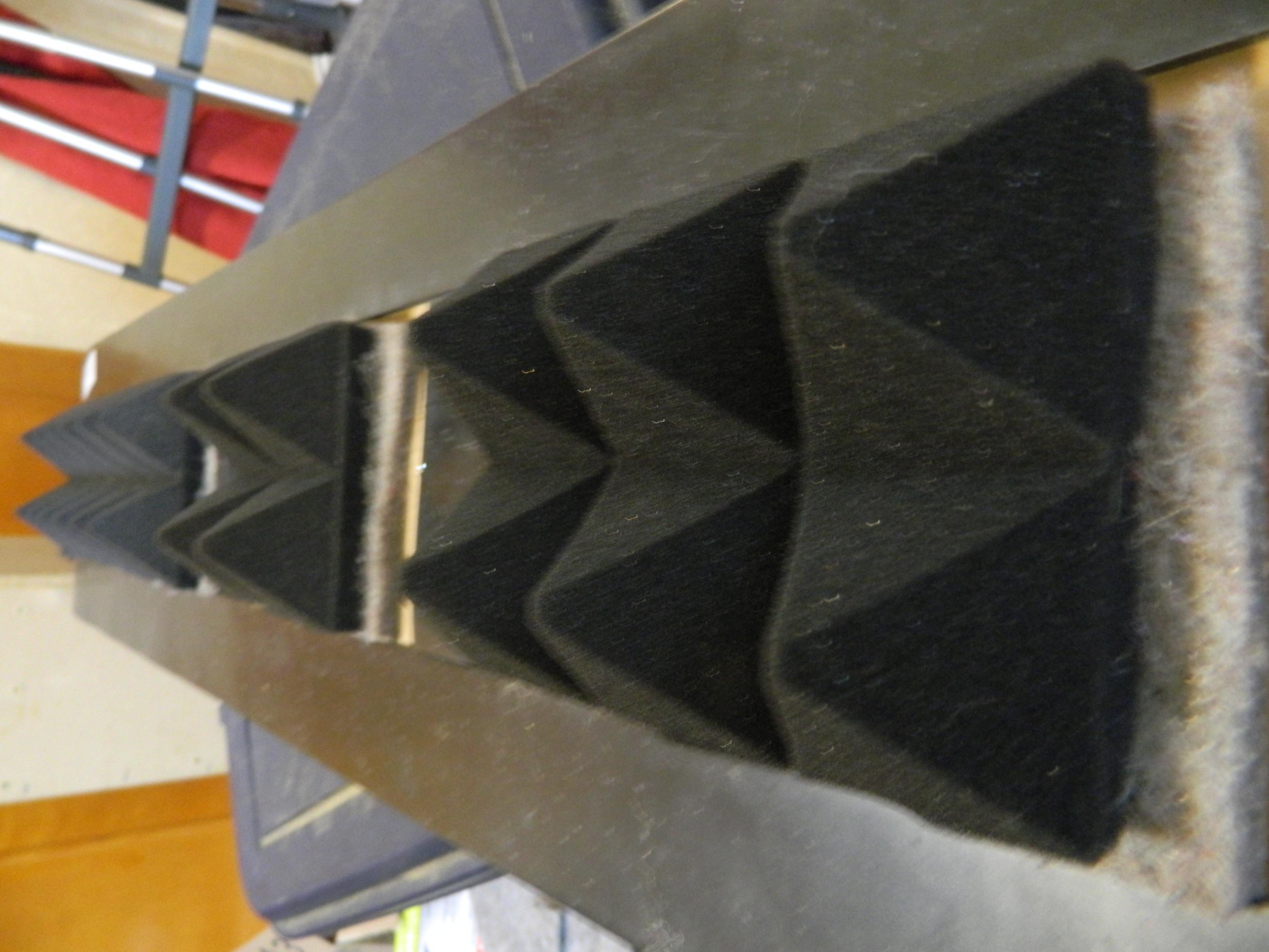

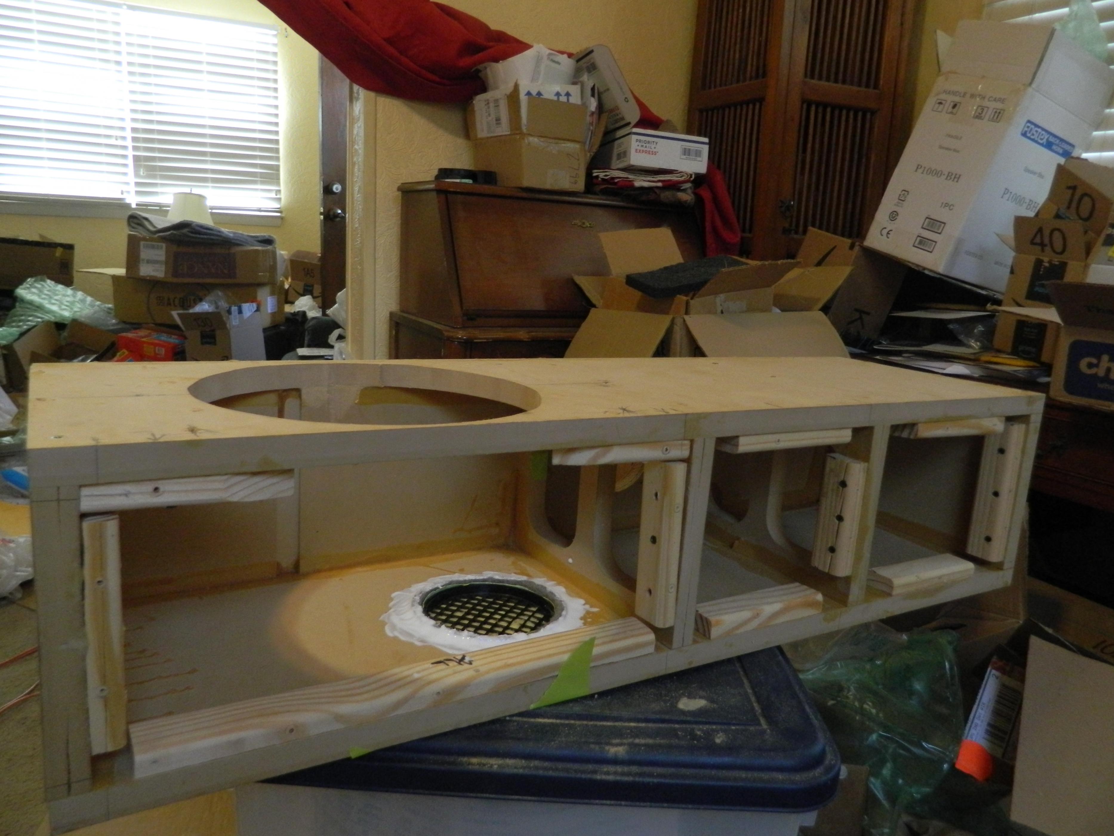

... big foam pyramid cone are cool... never saw so big in a peaker before.
I'll see if I can post the info; I bought 4 inch and 2 inch pyramid foam both from Amazon. I didn't want stuffing/fill loose in the woofer chamber because everyone said you need to keep an open path between the woofer and the flow resistor Aperiodic vent. I added the 2 inch pyramids on the removable panel on top of the felt damping. I only used the 4 inch pyramids in the woofer chamber making sure again to keep a clear path. Anything to avoid reflecting sound waves and vibrations back to the woofer should help. In my past life; I had a wife and a nice house with a big workshop. I made many 5 sided boxes back then; ZERO parallel surfaces was the goal to avoid standing waves. I no longer have that luxury so I use pre-made or knock down boxes and modify them to my "exact" needs. Of course, these are all rectangle boxes so we have parallel sides (the reason for felt+stuffing+foam pyramids, etc.)...
4 Inch Acoustic Foam Pyramid Style Panels - 13 Colors
– SoundAssured
2 Inch Acoustic Foam Pyramid Style Panels - 13 Colors
– SoundAssured

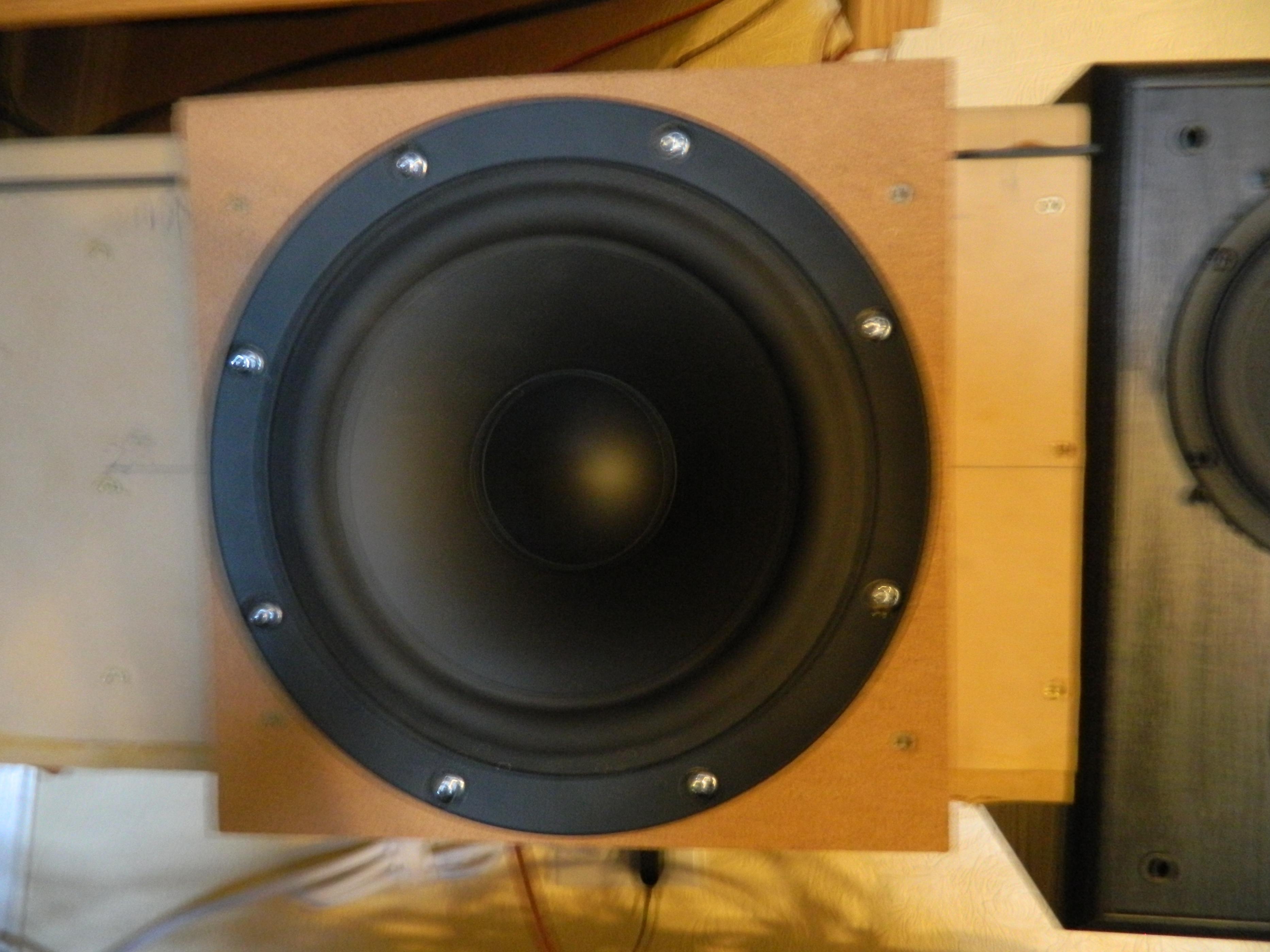

I seriously think this current combination of drivers is hard to beat in this price range. Again; The SB Satori MR16P (4 Ohm) in just over 0.5 ft^3 closed (about 15 liter) for a Q of around 0.5. The MA Pluvia 7PHD (P7PHD) in my "bread container" and the Fostex T90A up top. The SB29's are now fully broken in. They are really good at regular bass; scary good sometimes! The Satori 9 1/2 inch or ETON 11 inch probably have a better transient response and better upper bass but the SB29 just hammers away at the main bass frequencies probably better than anything else for the money. Hey; 37 Hz f3 in a smallish closed box, 3 inch VC, huge magnet and 22 mm of LINEAR X is very hard to beat in this price range...again; subs still out of the room...
