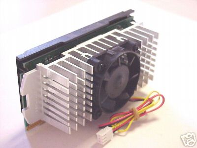

let's ask to all...how many °C/w heatsink do you use on the chip?
i'm planning to use a pentiumII with 2 fans for every chip...
