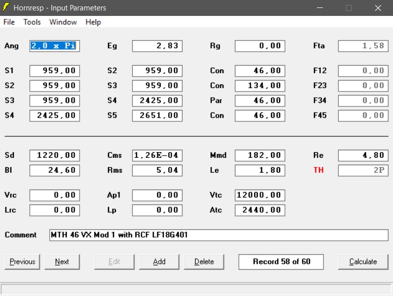

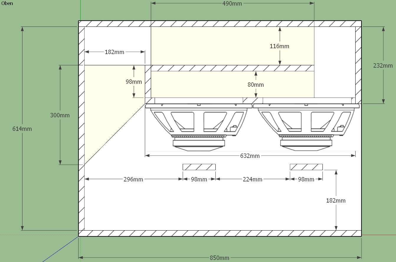

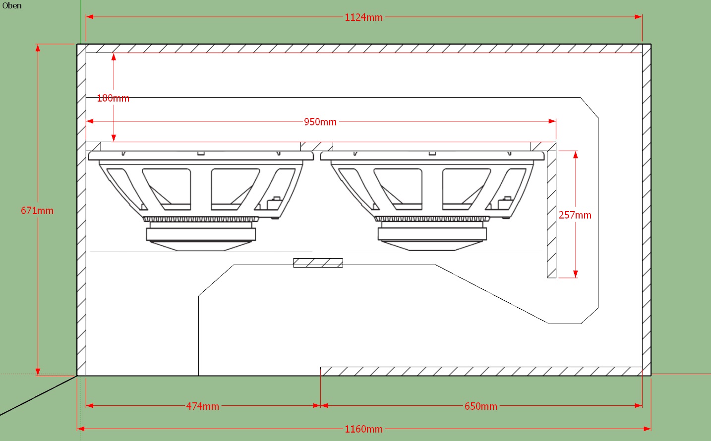

AND NOW to the main question 🙂 The Aura XQ48 is a little bit to heavy/ to big for my opinion, so i scaled it down to a 2x18 inch hellboy like in the attached pictures below. I plan to build the prototype with changeable front-plates to find the right tuning for me because simulation is a little bit difficult with the higher tuned design (Is S4 the vertical or horizontal width of the front chamber?)
I would be glad if someone can handle this type of simulation. If not, it doesn't matter. Then i will wait until the prototype is built. 😉 Naming will be MTH 46 VX 218, driver either the RCF LF18G401 ,N401 or X401, depending on the final tuning.
And i am interested in your opinions to this kind of subwoofer design. The size is slighty bigger than one of my MTH 46 VS, but with twice the power. I will keep you updated with this project and i am waiting for your response. 🙂
I try to avoid using two (or more) drivers in a row, since they will get slightly different loading due to tapping into the resonant pipe at different places.
I would call this a simple stepped tapped pipe design, and I know they can sound very good, with a very physical and tactile reproduction of bass. Even more so with two 18 inch drivers in a short and reasonably high tuned tapped pipe. 😱😀 I like it a lot!!!
A large quarter wave front resonator can add even more efficiancy, better loading of the driver and more midbass kick and expand the usable passband.
