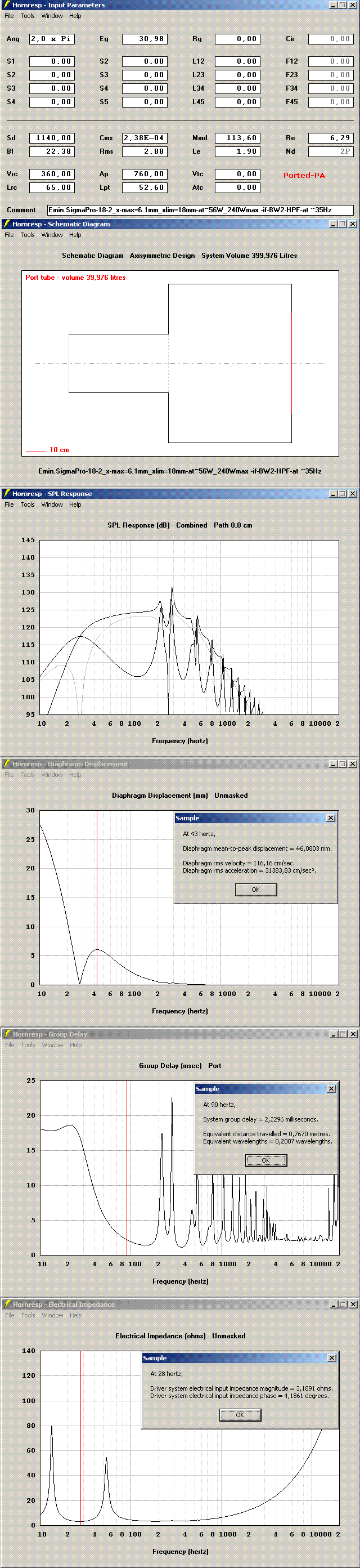

32Hz is not a magic number, and 8" ports are also not magic. Go download yourself a copy of WinISD Beta and model the response of various sizes boxes and ports. It is one of the better FREE calculators available that runs on a modern computer, and you can change the setup to see what trade-offs you will make to get what result.
The free "calculators" you will find online range from decent-but-limited to plain nonfunctional. Give WinISD a try.
how do you read the plot window? under "gain" and "spl" ?? what is good and what is bad?
