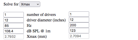

The lower the tuning frequency (Fb), the less SPL at Xmax (only 2.7mm).
Each doubling of excursion allows +6dB more output.
12" wide band woofers with 6mm Xmax are common, sub woofers double that.
The HP filter should be set just below Fb, where excursion rises uncontrollably, and results in little output.

  • Cone excursion. This is something we can't really understand on WinISD, as both this, and the sealed 2x12 sealed version (same volume, just for comparison) seem to go over excursion really fast from around 150/200 Hz down. But, this depends on signal input power and we're not really sure what value to put there.
Exceeding Xmax will cause the driver to distort as the coil is driven out of the magnetic gap.
It won't take much power at all to exceed Xmax about 1/3 octave above Fb (tuning frequency).
With a 70Hz Fb, probably looking at around 108dB at one meter max at the low E of a guitar (81Hz), compared to 123dB at 200Hz (sealed).
Oops, you said 2x12", so you can add +6dB, 114dB and 129dB.
