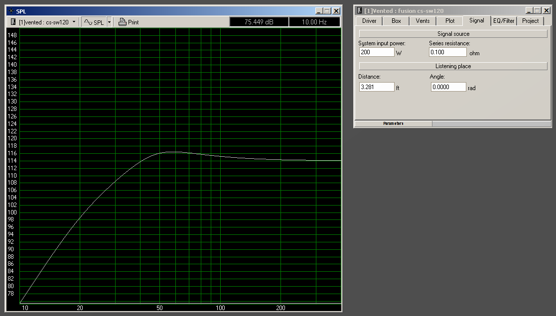

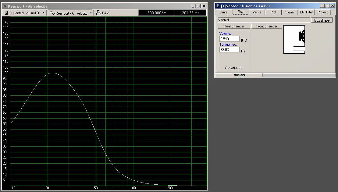

The charts are based on 2 drivers total, 3.54ft^3 (total), and a pair of 3" diameter ports tuned to ~33hz (as per "suggested")
The first chart shows a theoretical maximum SPL in open space at 1 meter based on an Xmax limited Pe of ~200W [100W per driver] (requires a ~30hz high pass to protect driver from over-excursion).
The second chart shows the Pe as a function of Xmax and thermal, so you understand where the 100W per driver limit is derived from.
The 3rd chart reveals the flaw in the box design. From ~30-50hz, at 100W per driver, the port noise is going to be very audible. Anything below ~40ft/s is considered acceptable in most builds. In a trunk, a little higher is probably alright, but your deeper bass notes are probably going to make whooshing noise. Below 30hz is is only applicable if you leave it without a high-pass, though even without a high pass, there is generally very little musical content down there anyways. I think at minimum I would move up to ports of roughly 4" x 15" instead of the suggested ~3" x 9".

Model looks fine to me. Though I don't know the effective port cross section and length, as long as it is tuned right with enough port cross section it will work fine. If you're willing to give up that much space that would be a nice naturally rigid design with plenty of vent space to keep chuffing to a minimum.
You just have to weigh your options. The maximum box size you are talking about there will encompass over 5ft^3 of space when finished. You could just shove the pair in a total of 1.5ft^3 sealed and it would be fine IMO.

In order to save on some wood, the only change to the box design you came up with that I would suggest is to remove the baffle that splits the 2 ports as they are lead to the front of the box and just adjust the position of things such that where the 2 ports come together to form a single larger port, the cross section there should equal the combined cross section of 2 ports. Your approach is fine.
Assuming an overall box size of 17x34x19, build the port with the same approach as you had in mind there with the googe sketchup, just eliminate the center baffle that separates the 2 ports, and eliminate the switch-backs in the port design. The port should be 15.5" high (front baffle less 1.5" for wood thickness on either side), 4" wide, split into two 2" wide sections at the rear that form the top of a "T" shape for the port looking at it from the side. By my math, if you run the top legs of the T over to each "end" of the box leaving a 2" gap before the side-wall, the tuning should line up just fine and the vent air velocity will actually be lower than the goal. I estimate the resulting tuning frequency to be in the neighborhood of 35hz.
If you want to get the tuning frequency down to 30hz, do the exact same layout but reduce the port dimensions to 15.5" x 3" (1.5" where it is split at the rear), and run the length of the top of the "T" out to within 1.5" of the side wall. That will increase the box space and lower the tuning frequency of the port, which will help bottom end, however, port air velocity will potentially be higher (still below goal IMO so not a big deal).
Anything in the 3-4" port width will work fine. (divide by 2 for where it splits at the top). Other slight changes in box dimensions are not likely to make a meaningful change so don't worry about it too much.
