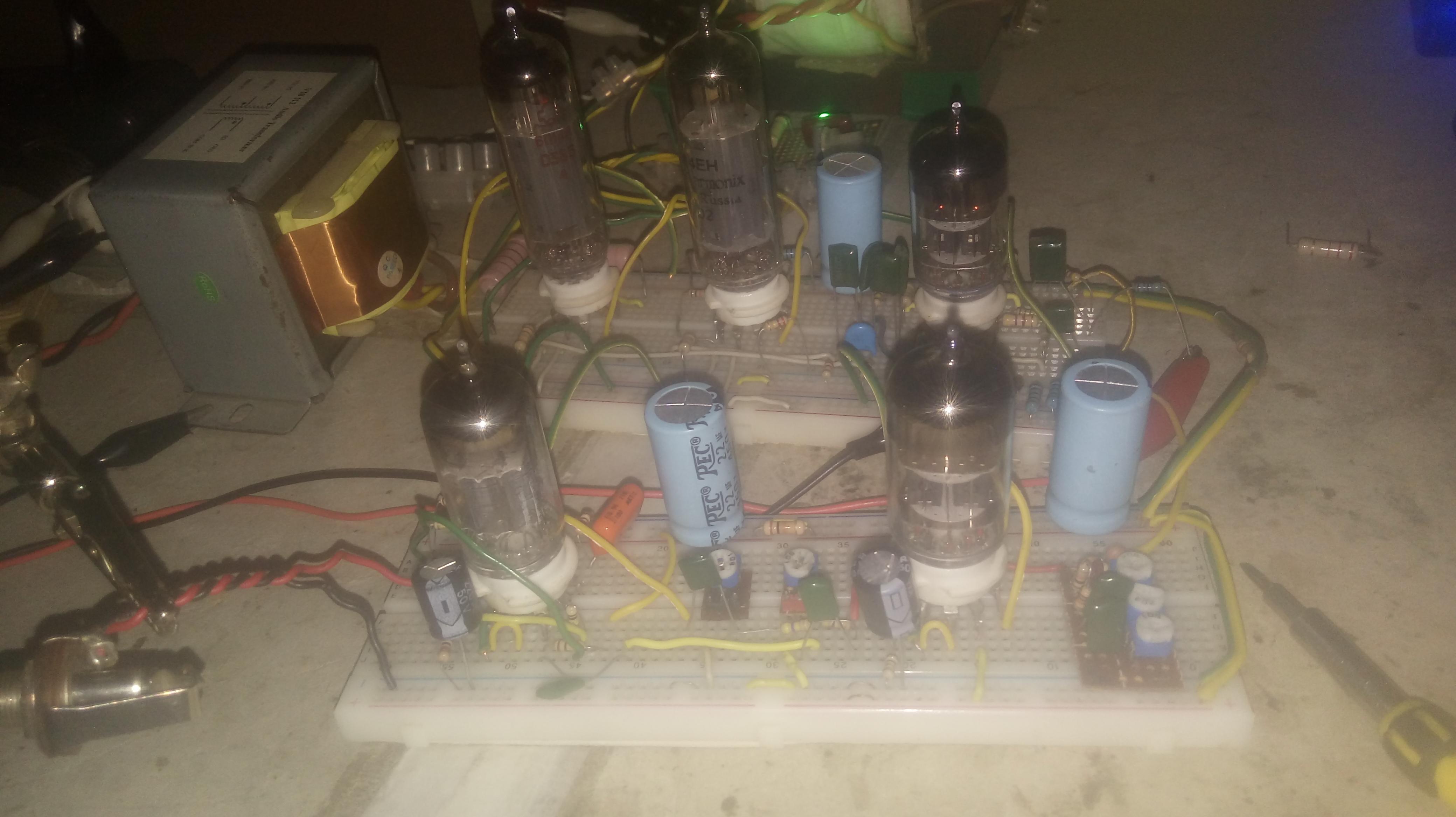

sorry guys but i can't use any other tube rather the el84, currently i'm protoboarding and testing it with a bass, it sounds really nice... however i'm using a 450V transformer with a huge resistance(it drops to 380V at max vol). I will attach a demo in few mins
i got 24mA and the other 38mA(!) biased at -18V...this last one is a bit weak and the waveform shows up a bit assymetrical, later i will buy a matched pair

In the schematic in post # 2 there's no decoupling capacitor at the point where the screengrids are being fed. Is that on purpose, or just an omission?
it was on purpose to avoid overloading the screens making the voltage drop from 400v to a reasonable level depending on the input voltage. A capacitor will try to make the voltage constant thus melting the screens
i forgot to mention, i replaced R1 from 2.7k to 1K to increase the screen voltage from 260 to 300V, this increased the power output a bit enough to make 24.5W with less voltage, 425V
The voltage drop over R1 (now 1K) is V4 (now 425 V) minus the sreengrid voltage (300 V) = 25 V. So the current through R1 = 25 / 1000 = 25 mA.
The voltage drop over R5 (22K) is 300 V - 273 V = 27 V. So the current through R5 = 27 / 22000 = 1.23 mA (which seems too low for the three 12AX7's that follow).
This would mean that the two screen grids of the EL84's are taking 25 mA - 1.23 mA = 23.77 mA. So each screen grid is taking about 11.89 mA. So the screen grid dissipation per EL84 is 0.0119 x 300 V = 3.57 Watt (well over Pg2 max, and just under Pg2 max peak).
If you look at datasheets for the EL84, a screen grid current at 300 V of almost 12 mA per EL84 at idle is way too high. It should be something like not more than 2 mA.

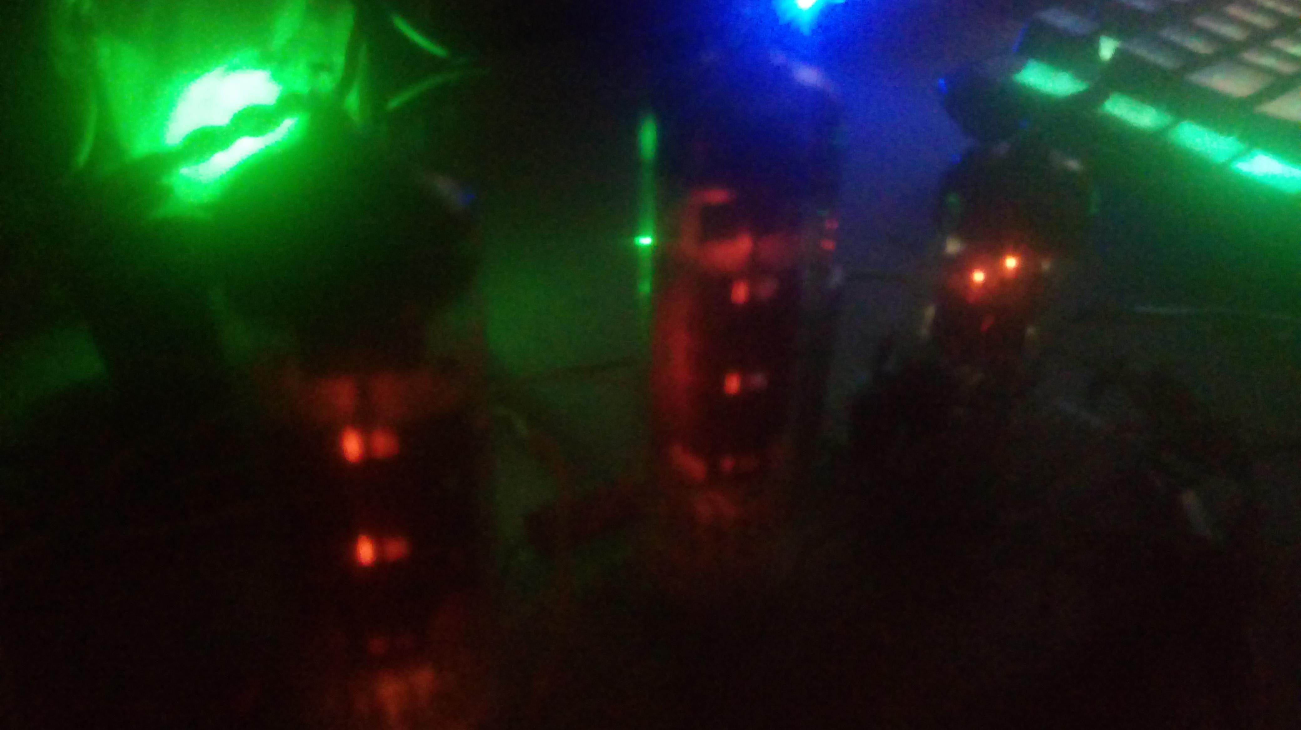

poor guy needs to go, is red plating now... here is a quick demo at max recorded directly to the pc with a cabinet simulator
