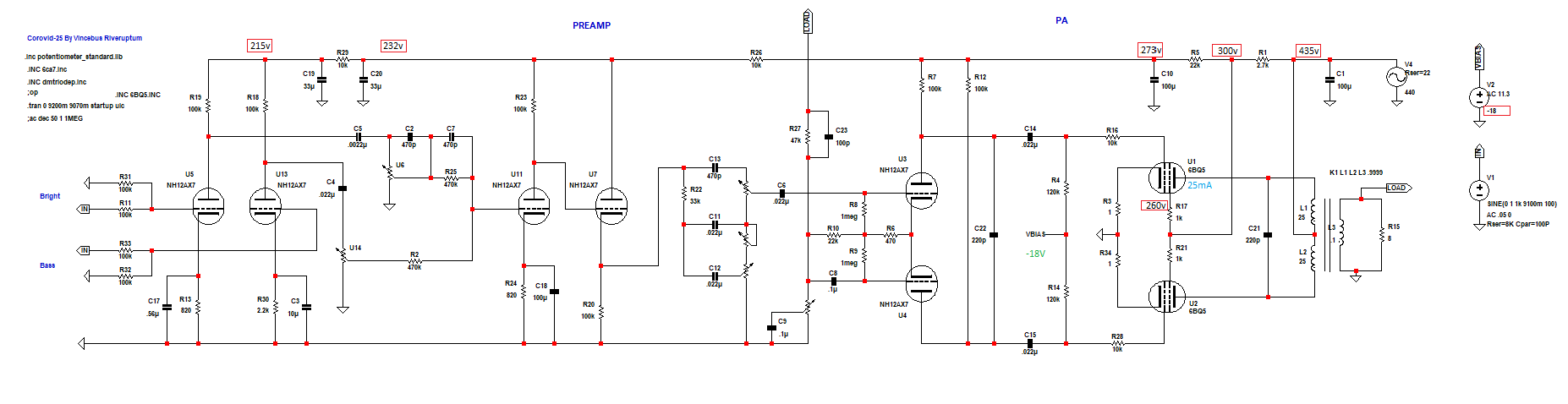

Hello! for long time i haven't had any bass amp to gig but i have some parts at hand to build one, i had experience giging with a improvised 12W tube amp for rock/heavy blues with a dirty bass tone with no issues, but i need a bit more power in the range to 18-30W to play more versatily with more headroom with enough OD.
Short story, my plan is to build a Marshall 1959SLP clone with a pair of EL84 at the end fixed bias, at 450V B+... yes is kinda high but has anyone tried it before? btw the screens are on the range, at <300V and plates idle at 24mA, with those voltages the amp gives me 25W-ish (10%-ish distortion) and 30W full clipping.
I've heard some people prefer cathode bias over fixed for this tubes because at higher voltages don't sound very good nor the linearity, anyway i'll attach the circuit if you wanna check if i'm way out of spec or there is any hope.

Even the Traynor Guitar Mate only pushes out a plate voltage of 420 volts for 25 watts , at 450 volts you really are pushing a bog standard EL84 , you wont be expecting a long life then ?

i'd use el34 tubes if i could but i plan using what i have at hand, i already got a output tranny and the tubes, pretty much everything is done except for the chassis and the power tranny
At that high voltage you will need a mains transformer of at least 150ma as you don't want it to heat up.
For realistic Bass along a drummer you need at least 60W; EL84 will give you 20W; never ever measured a pair giving 25 clean watts, let alone higher power.
Use at least 2 x 6L6 or EL34; not even 4 x EL84 will do.
Plan B: build a nice Guitar amp with what you have, sell it, and with that money build a real Bass amp.

not a bad idea, but also i want to use it as guitar amp

400 V plate voltage and more surely will stress common 6BQ5/EL84's well beyond their capabilities. As a musical instrument amplifier get's used on stage at least sometimes, you want some reliability from it, don't you? So go and get some very scarce and vertiginously expensive 7189A's. They are EL84's with a 440 V plate voltage rating.

Same with SQ tubes in the Western world. Btw, the datasheets for the E84L, a 6BQ5/EL84 SQ variant, show a plate voltage rating of 450 V 😉.
Do you mean that the power transformer has to be of higher current capability than for running a pair in class B at Va = Vg = 300 V (Iaa + Ig2g2 max. at 17 W = 114 mA)?
I would think that pushing a pair deeper into class B, at a substantialy higher anode voltage, makes the current draw go down and the power efficiency go up. So even when squeezing 25 W out of a pair, I don't expect the current draw to go up.
No PCL200 ,the standard current draw for a pair of EL84,s in Class AB1 including the screen is ( approx) nearly 120ma , I always allow a safety margin as heating up transformers is not advised.
To run then at the "supposed " HT + rail of 450V would drop the plate current down a bit but up the screen a bit ( depending on the transformer load resistance ) but at the output he wants on a standard circuit you would still need a heavy current HT output .
