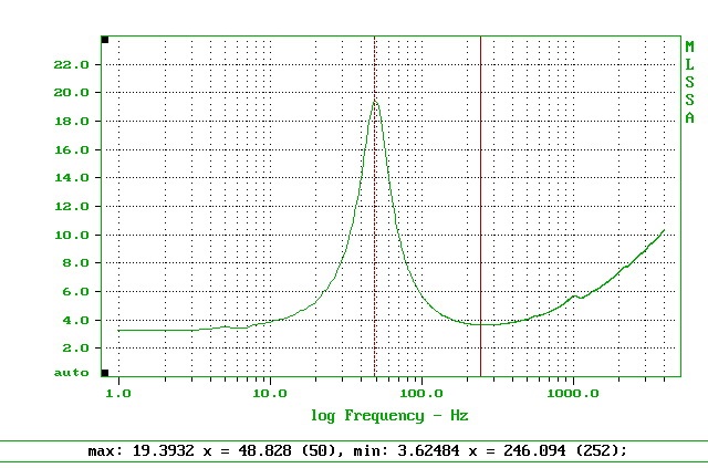

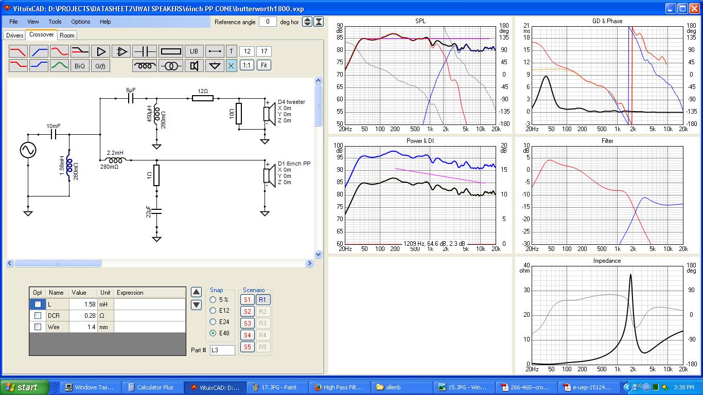

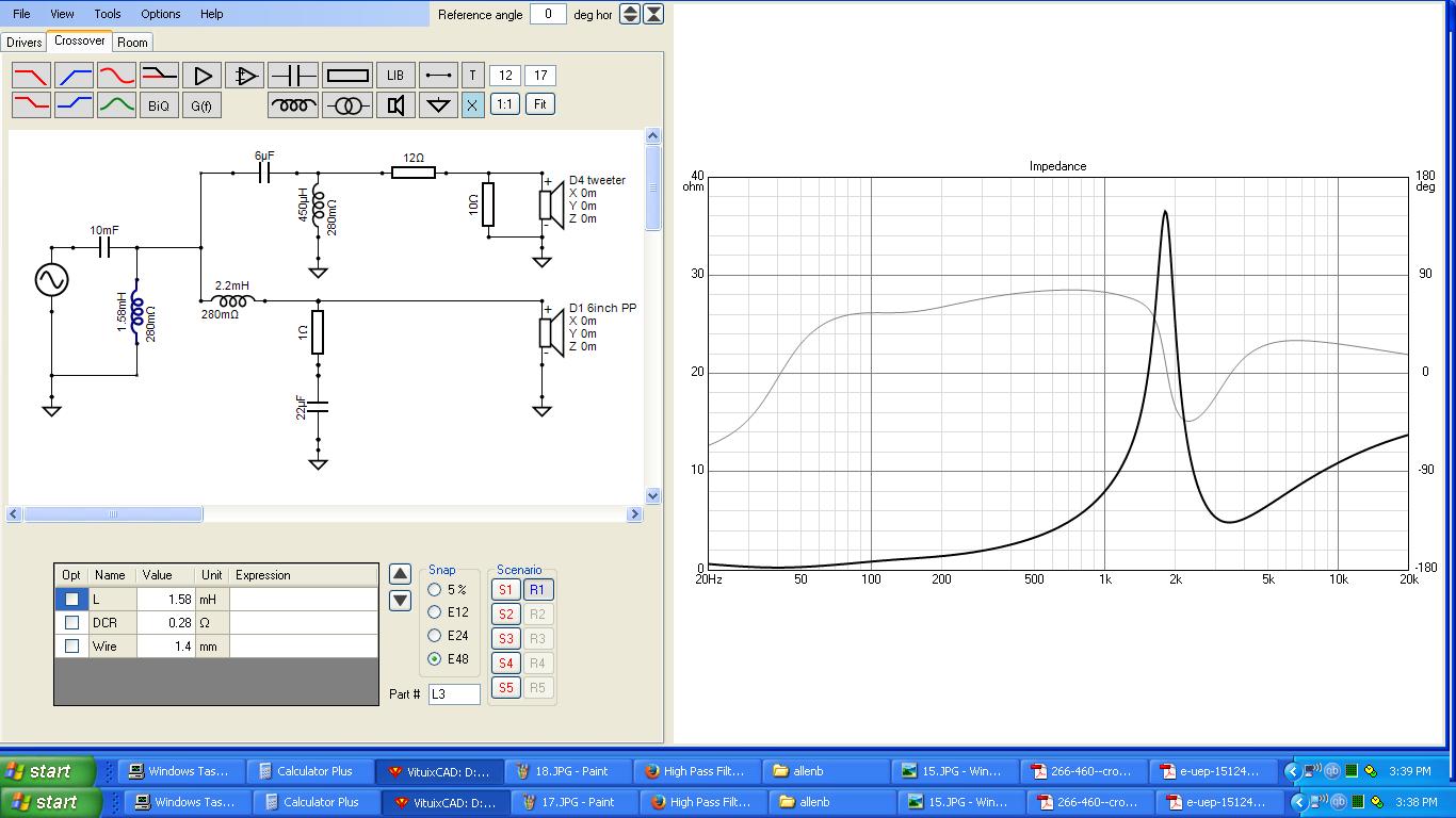

2way passive cross over help
seems like a good idea , but will the impedance dip so low ?
It does because you have such a small inductor. For this job you will want closer to 40mH and perhaps 400uF. That's about 40Hz and Q=0.8.
Your main concern would be resistance, and in following this, inter-turn capacitance. I would want to wind this one on a core.
There are many alternatives if this is not satisfactory.

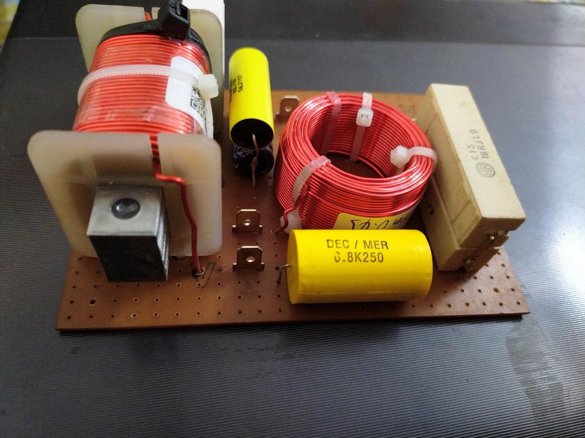

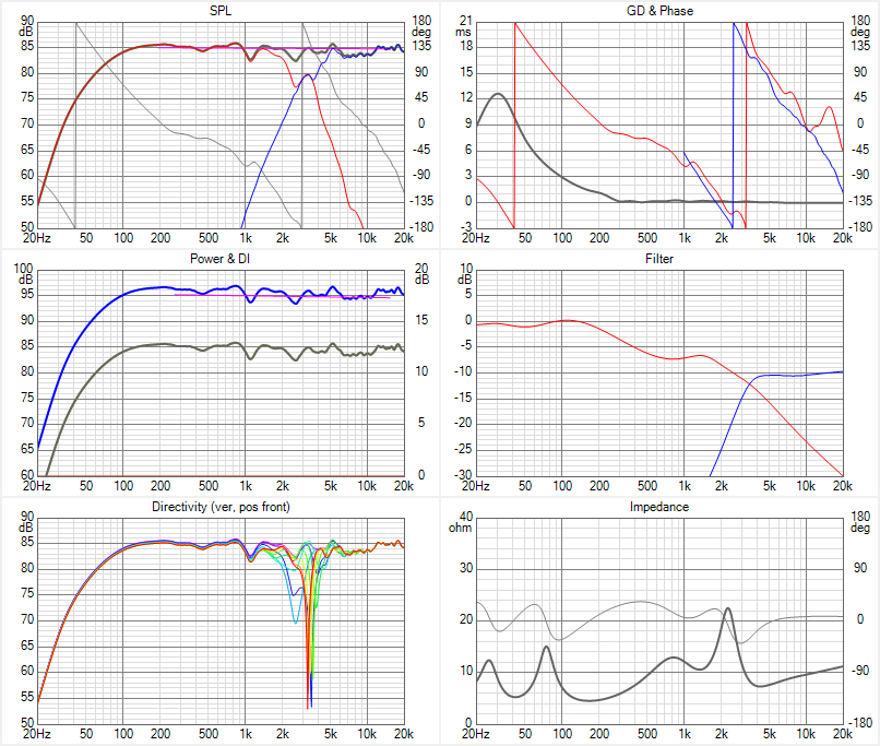

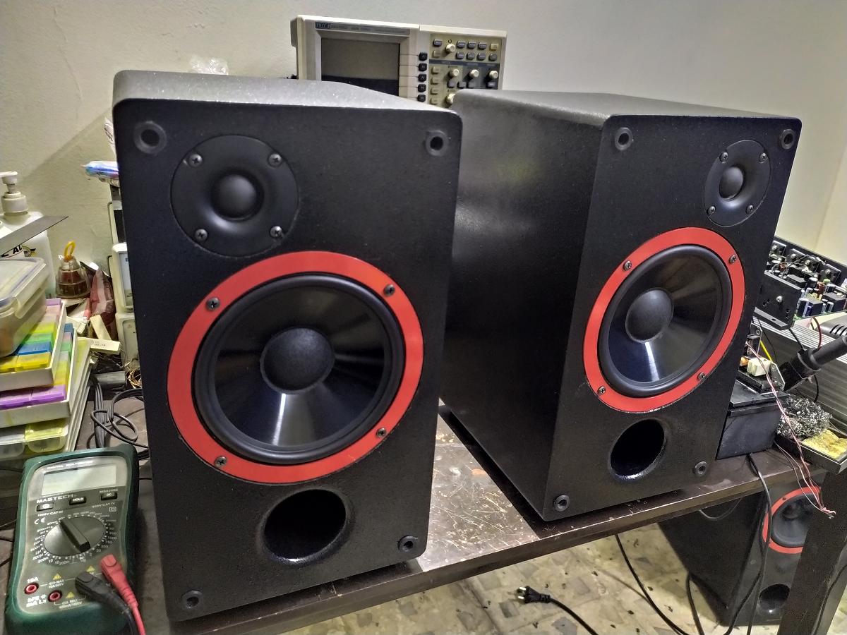

Hi AllenB & Ente,
Thanks a ton for helping me in this project , I have finally completed the project and it sounds really good.
Please find attached some pictures of the same.
Regards
ONB
