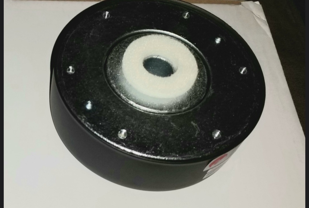

I thought that I had got the upper cross worked out until I applied the proper correction file to the mic that I had been using, which then resulted in seeing a peak at 5500hz, which is the left-over rise that is natively there above 4300hz. Now, like you say, I may end up with something like a 4th order filter there.
This build is an inexpensive build for me, because the woofers cost next to nothing, and I already had all of the crossover parts. I have learned about conjugate RLC filters and difficult drivers. The speaker, even with the 5500hz peak, is nice on many types of music. The biggest problems come with recordings that are not inherently clear in the mid range, the mids do reveal a lot.

Hi profiguy, is the white foam donut in the picture the stock dampening material? I wonder if wool felt rings/slug would be an appropriate material to add?I've found that by pulling the dome off and adding more dampening material in the pole piece cavity, it dropped the peak down to a manageable level. This is where a 2nd order HP can add to the new natural rolloff slope, ending up as a 4th order acoustic HP.
I can picture a cone, dome, or inverse torroid (negative center space of a circular cross-section ring) shaped plug that replaces the white foam ring. Possibly stacked circles of wool felt.
Might filling more of the space change the Fs of the driver noticeably?
When I was first returning to the hobby with gusto, I was attracted to the wide-range, single driver approach. In the larger drivers, whizzer cones abound. The whizzer has a poorly damped edge, but it also has a space behind it that interfaces the center of the main cone. Whizzer drivers typically have multiple peaks/valleys through the upper mids and treble. Lightly stuffing the space between the two cones with fiber, or sometimes foam rings, smooths the response somewhat. I am wondering if the whizzer problem has some of the same causes as the pole piece/dome? Do dome tweeters have similar characteristics in this regard? I have noticed that many dome mids do have a bit of a "saddle" in the response, but most not to the degree of the DMB-A.
@howardg The pictured dampening is stock, as delivered. Its a delicate balance of avoiding over-doing it. You need some exposed air volume for acceptable lower mid output. The main goal is to break up the primary radial standing wave across the dome inner diameter.
The open pole piece needs a little more treatment with some light combed merino or lambs wool. I'd use enough to loosely fill up the pole piece cavity up to the dampening ring. No more than that. It will moderately drop the Qts and lowee Fs a little. You want to aim for a Qts around 0.7
