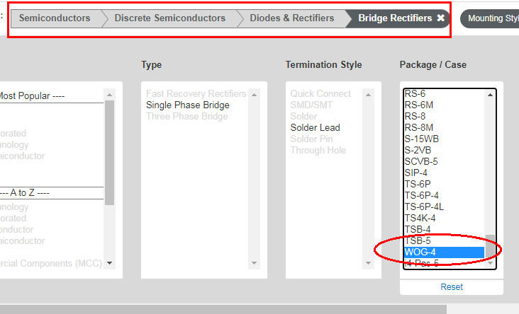

I am still in the process of upgrading an old DAC, and this post follows another one related to the 1N4001 replacement.
There are 2 rectifier bridges, labelled 2W04 and having a circular form factor, rated 2A 400V (see datasheet) that I would like to replace by a "better one": Shottky, soft recovery....
I could build my own bridge from single diodes, such as Infineon IDH03SG60CXKSA2 or any other one that you would recommend, but it would be much easier to install a bridge with the same form circular form factor....
Any recommendation for a circular form factor bridge ?
Same question for single rectifier diodes (I would solder them on my own PCB)
Thank you very much

Here is the search path I used on Mouser.com, to find other bridge rectifier components which use that same package. I didn't check the datasheets to find out whether or not they have the same pinout as your original; that's something you would need to do yourself.

Yes I can do this by myself, but the 2 models are 1.5A max where the original 2W04 is rated 2A: this may be a problem....I didn't check the datasheets to find out whether or not they have the same pinout as your original; that's something you would need to do yourself.
I will read with a lot of interested your guidelines: I am not expert enough to clearly understand what you mean by "snubber" and to design it...You would be better off installing a snubber on the secondary instead.
I'm sure that Mark can point you in the right direction on that.

Here's one of his threads. The snubber amounts to adding across the secondary a single capacitor, and an RC network.Yes I can do this by myself, but the 2 models are 1.5A max where the original 2W04 is rated 2A: this may be a problem....
https://www.diyaudio.com/community/...rmer-snubber-using-quasimodo-test-jig.243100/
