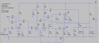

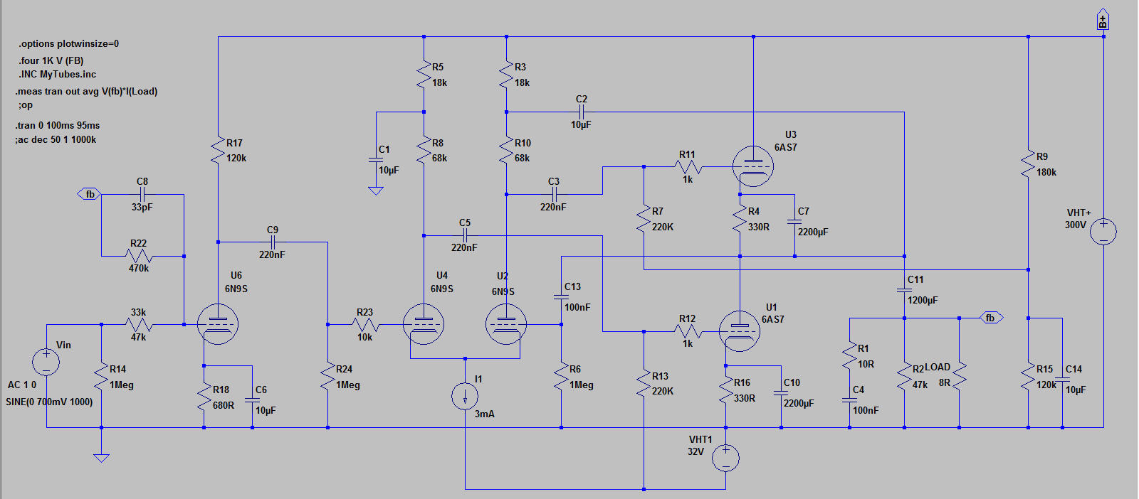

Here's something i simulated recently.. a pair of 6AS7/6080 triodes for each channel. The use of output coupling capacitor was intentional as i want to avoid using DC servo (which complicates the PS requirement, if not else). Overall, one heater power supply, one 300VDC HT and one -32VDC bias is all it needs for two channels.
The LTP perhaps can use 6SN7/6N8S if you want to run more plate current.. but considering 6AS7 is low mu, i think 1.5mA is enough to cope with the miller capacitance. It's a trade off between open loop gain and plate current.
It's not exactly 2W.. output is 5Vpk to 8ohm which translates to 1.5W. THD is 0.83%. I'm sure it can be improved.

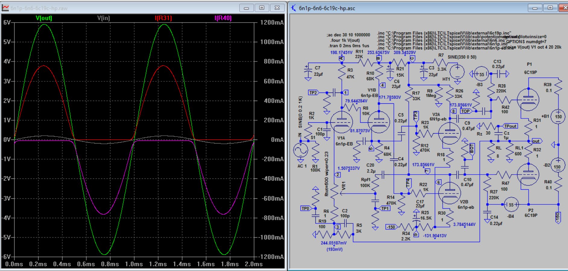

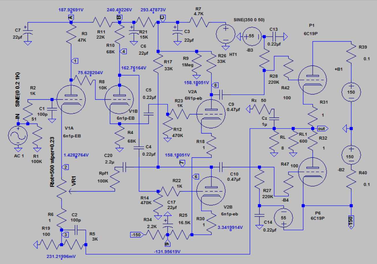

A scaled-down version of my 25W (10X6c19p)per channel model. Just 2X6c19p per channel will give 2W+ output with very good damping and distortion.Preamp/driver tubes uses are all 6n1p or a mix of other tubes like 6sn7, 6n6, 5687, damping is adjustable with VR1.
Is this correct ? I got just over 1 watt with SE OTL with 4 x 6S19 into an 8 ohm load

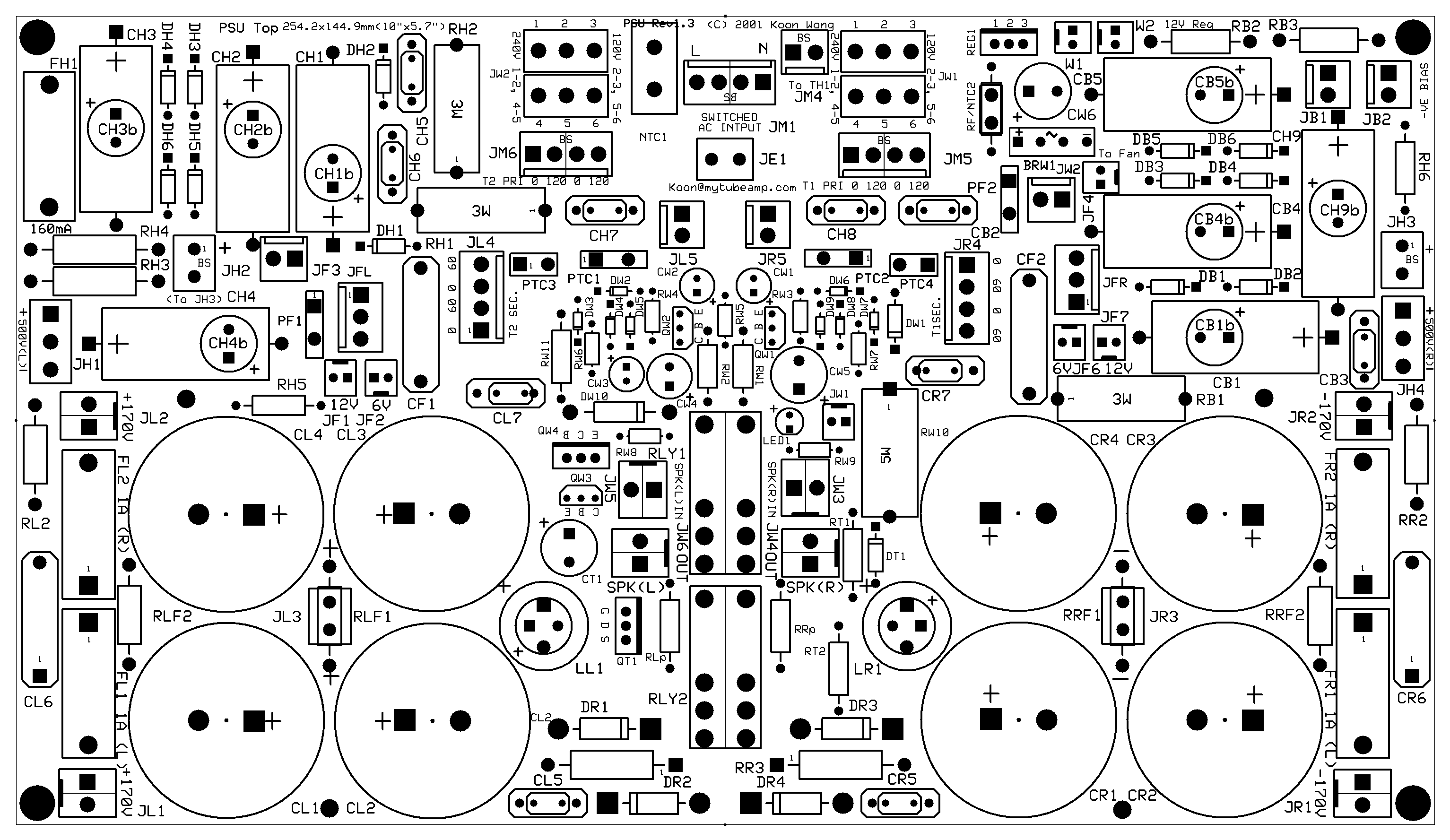

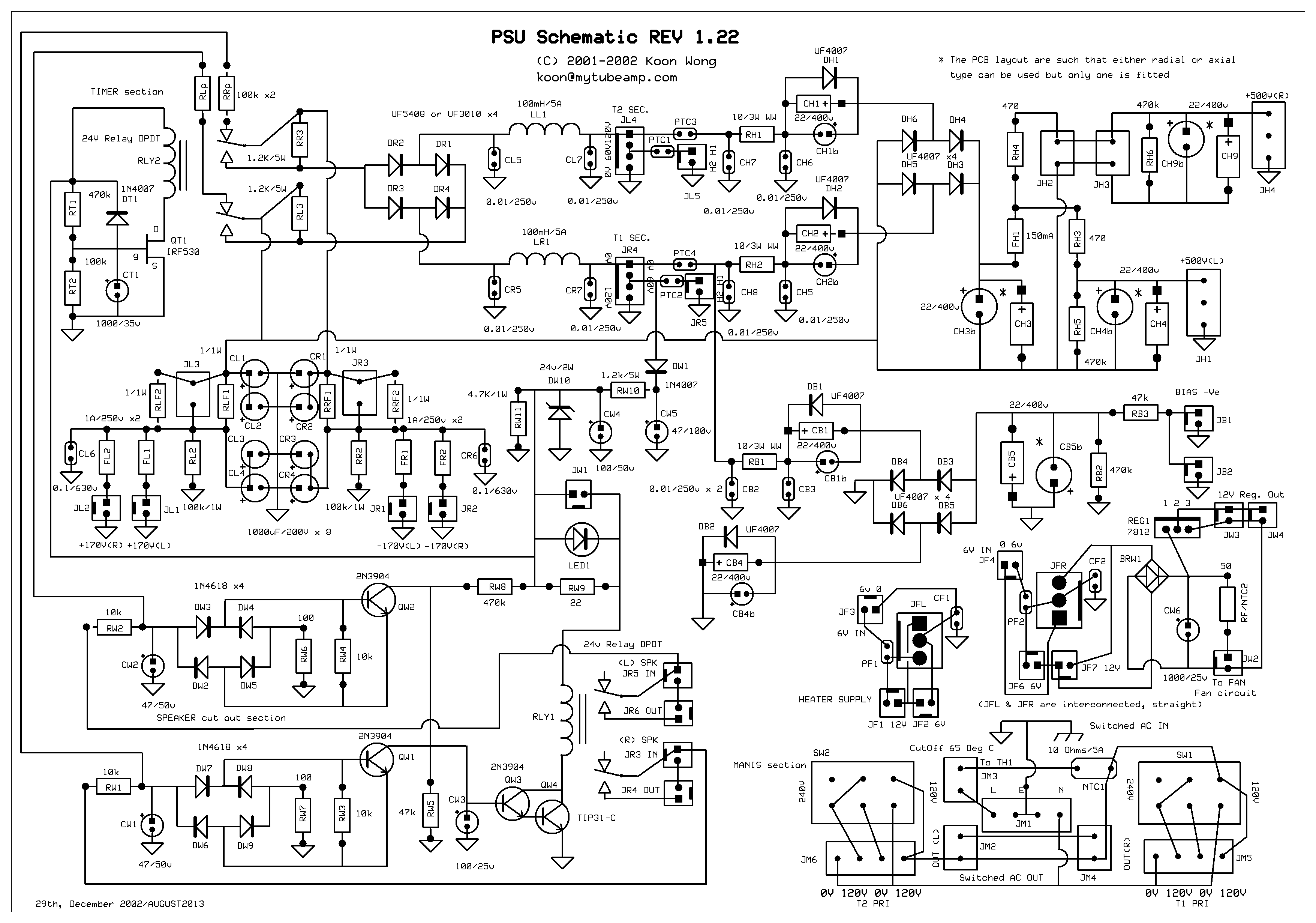

This one I like it! Thanks Koonw!
Could you show me your PSU?
Greets:
Tyimo
No problem, since I don't have one for scaled-down version, so I give you PSU for 25W model, it will give you some ideas. Please ask if any question. It has speaker protection unit, soft start included.
