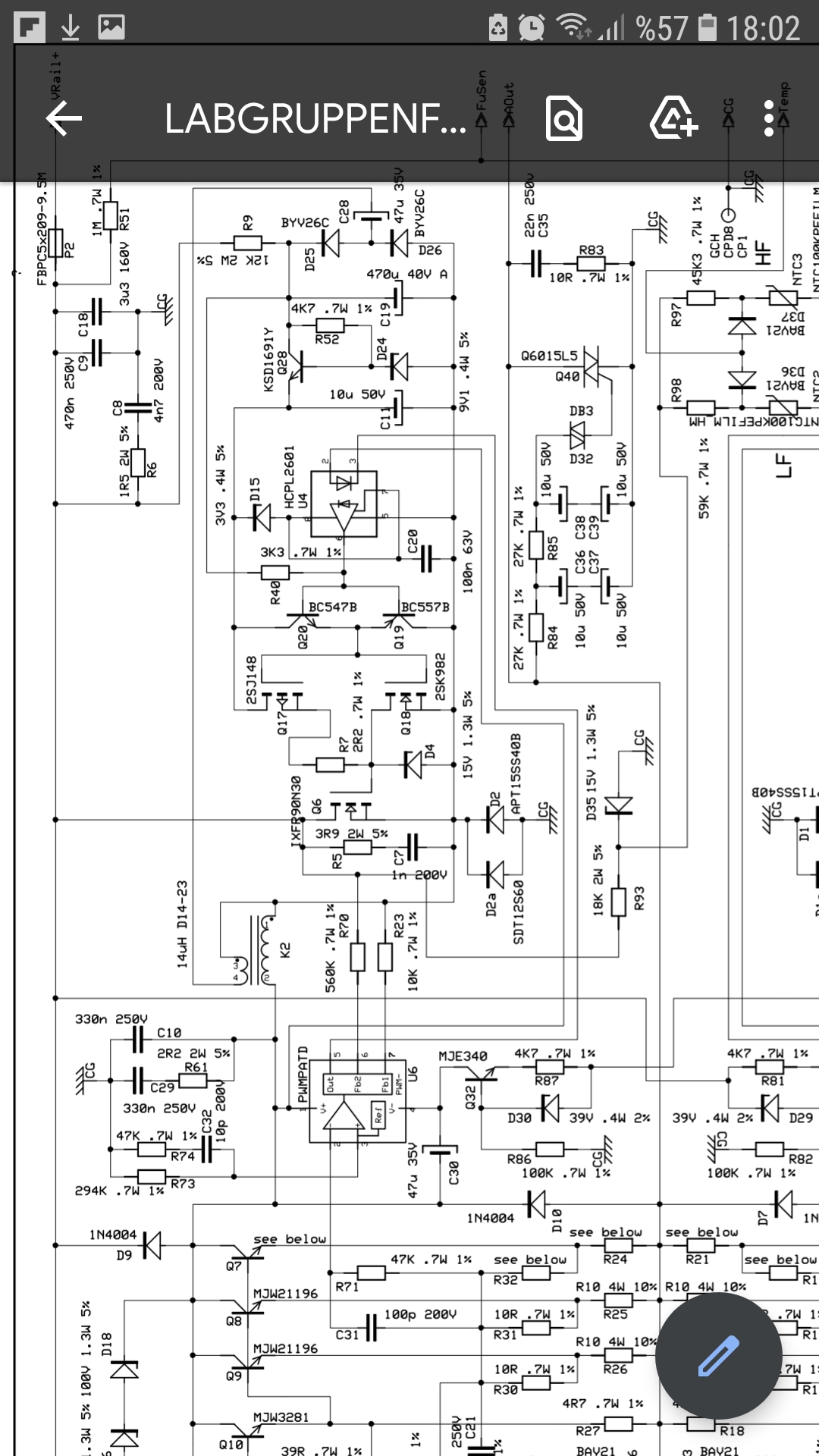

Hi Mark , thank you, i will use labgruppen class td driver
2sk982 and 2SJ148 are small signal Mosfets in TO92 package ( used in Borbely Kits ) i also received the same from Borbely 12 years back when i bought few Amplfier/Pre Amplifier Kits. I can spare couple of pairs but not cheap as I paid a sum to Borbely at that time. 2SK1062 /J168 are Power Mosfet not small signal ones
