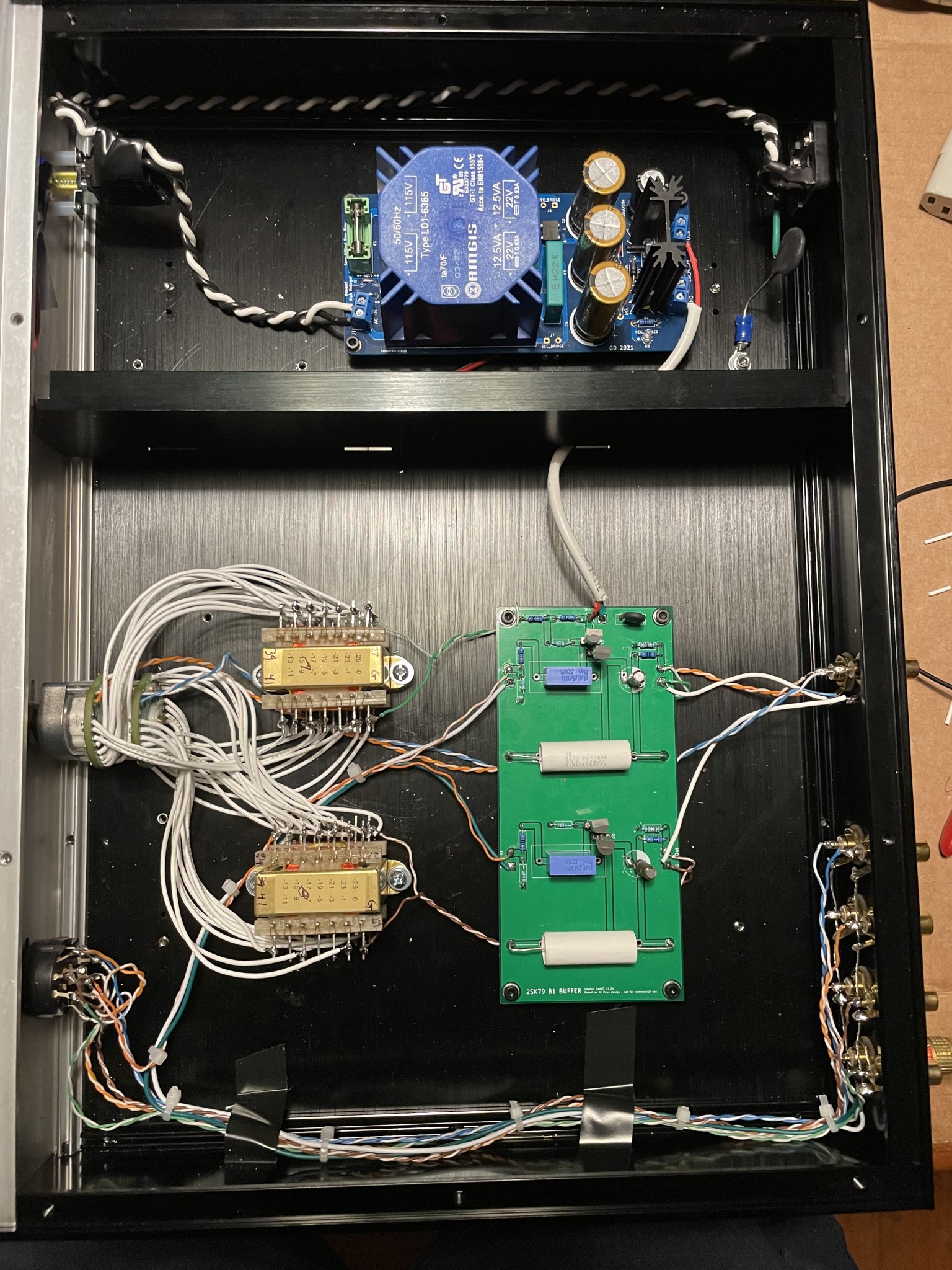

2SK79 with B1 buffer
Joined 2018
Nice! What chassis is this?
It’s one I got on eBay shipped from China, and I got a vfet nameplate made by a trophy shop.
I have a 2nd one of these chassis for a project that will come to life later this summer…

Update. I put a Slagle AVC in after the 2SK79 B1 buffer. It sounds fantastic!!!
If I ever do another AVC it will be the pre-wired version. It costs more and requires a taller chassis, but this wiring (and rewiring - long story) took a good bit of time.
This is a 28 step autoformer with a 24 position gold point switch. I ended up taking a linestage with gain and a stepped attenuator to figure out which taps to use on AVC. Worked like a champ.
Ende gut, alles gut!

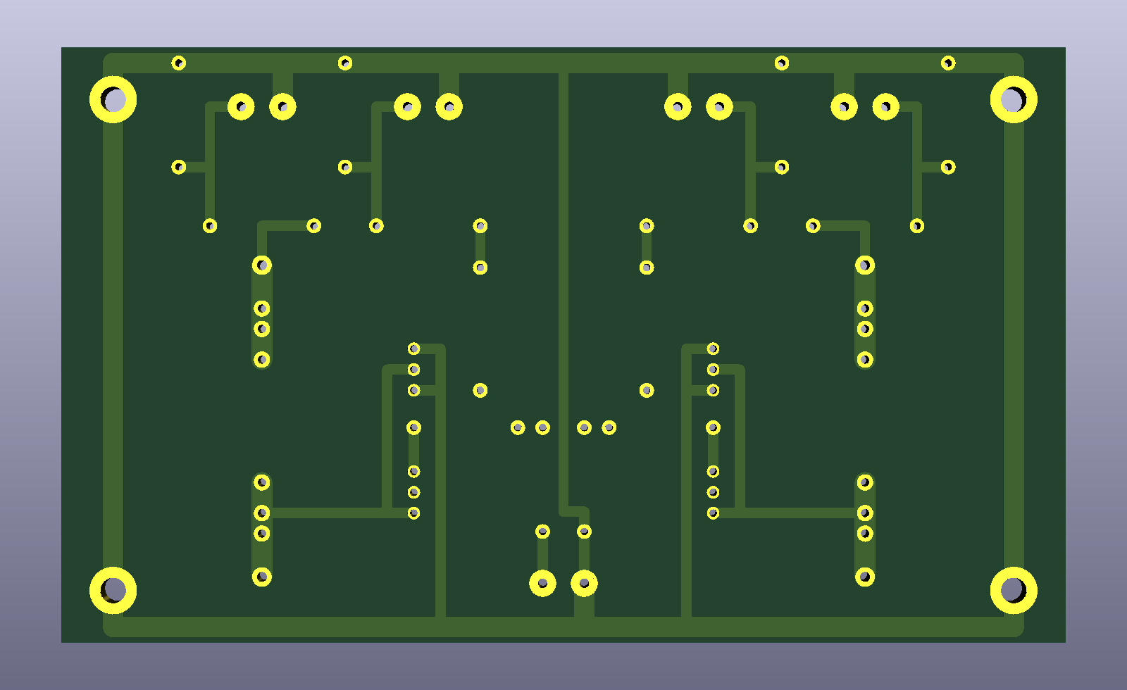

Attached is my implementation of the B1 with 2SK79 instead of the 2SK170.
Hi Cody!
I tryed to draw a 2SK79 B1 board according to your schematics minus thermistor.
It is a concept experiment.
I made parts silkscreen to look like in original B1 and tryed to mimic B1 layout with hopes it emanate Papa vibes. ))
It went at least interesting..
